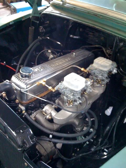

  25. Westside Lefty
    Joined: Jul 25, 2007
    Posts: 332
    Westside Lefty
    from Venice
    Patricks & Stovebolt help me put this together with a 848 head w/ headwork, bumped up the cam, and some other goodies. Oh, and a 700R4 behind it

  27. Keith English
    Joined: Apr 20, 2006
    Posts: 400
    Keith English
    whent through patricks for mine, Denise is a great help. its a 54 model
    bored .040
    mild cam
    split fentons
    new lifter, pushrods
