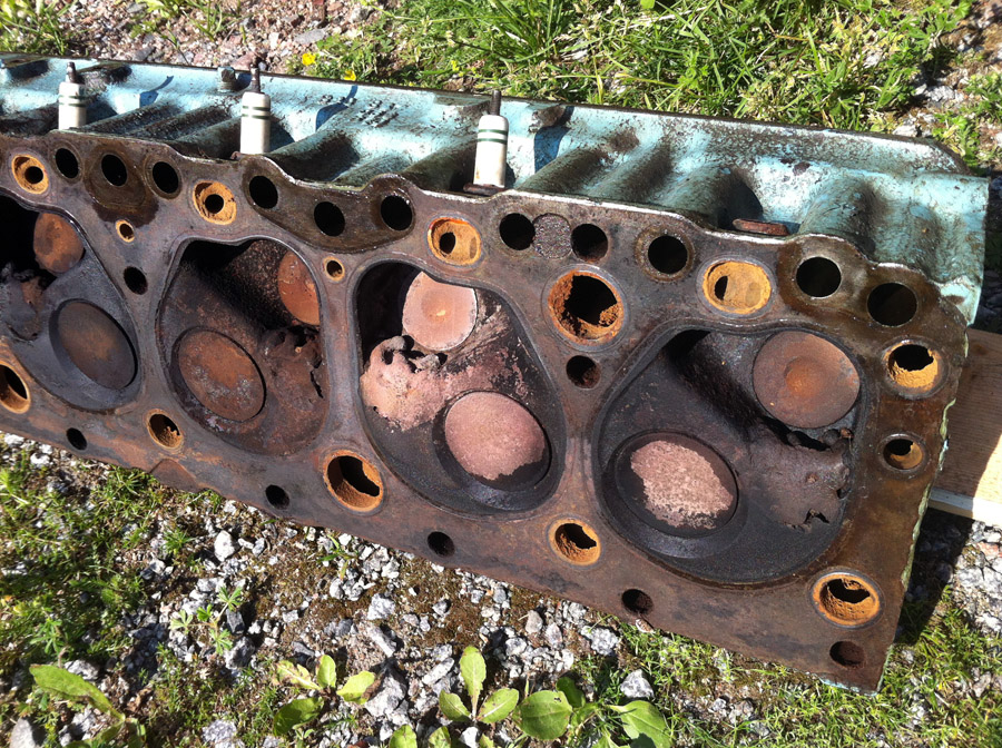

    Got a 235 standing in a corner of my workshop for a while now and removed the head today, the block is cracked and I thought I would remove what´s worth saving and scrap the remains.
    Got quite a surprise when I saw the combustion chambers!
    Homemade high-comp head...
  20. RichFox
    Joined: Dec 3, 2006
    Posts: 10,020
    RichFox
    Milled and filled they used to call that.
