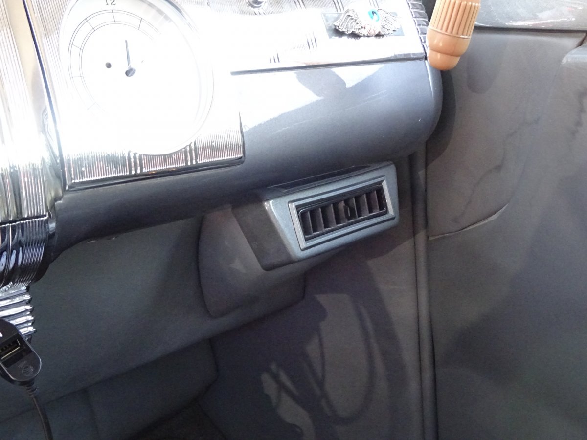

    We were at Shane's shop this morning and he vacuumed evacuated the system and refilled it and all is good, found that one of the Schrader valves was a little loose, that was prolly the culprit. Thanks Shane and Stray Kat for the lead, we now have cold air. DSC03381.JPG
    If you look real close you can see the COLD air coming out of the vent.
