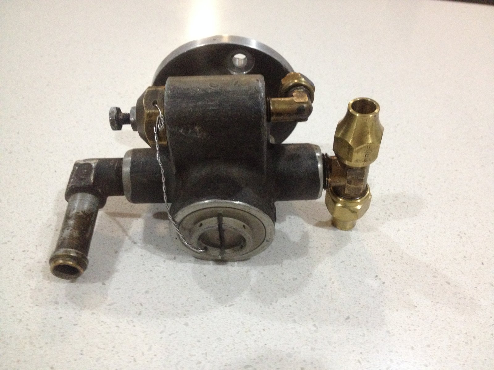

    My first attempt at safety wiring. It's an early Hilborn BL420 pump. Doing small jobs like this makes me appreciate the skill that aviation guys have. I will get better over time.
    Some of the stuff I see on modern gas turbines makes me shake my head. It is functional (the bolts won't fall out), but often not correct (not tight enough to prevent slight loosening) and rarely the gracefully laid stuff you see in milspec work.

    Harv, build a plate and bolt some safety wire bolts on it and just practice. It gets easier with time. It should be 7-10 twists per inch and smooth.
    Just fold your wire in half, pull it tight, and lay it up next to the hole where it will end. It will shrink a bit, but you will get the idea on about how much that will be. The twists should not go inside the hole on the bolt.
    Don't over twist. If the twists start to look like they are horizontal rather than at a 45 then it's too tight. When it's about right it will kinda feel like a guitar string, if that makes sense. When you make your pigtail, reverse the direction of the twist, then fold it over so it doesn't stab you.

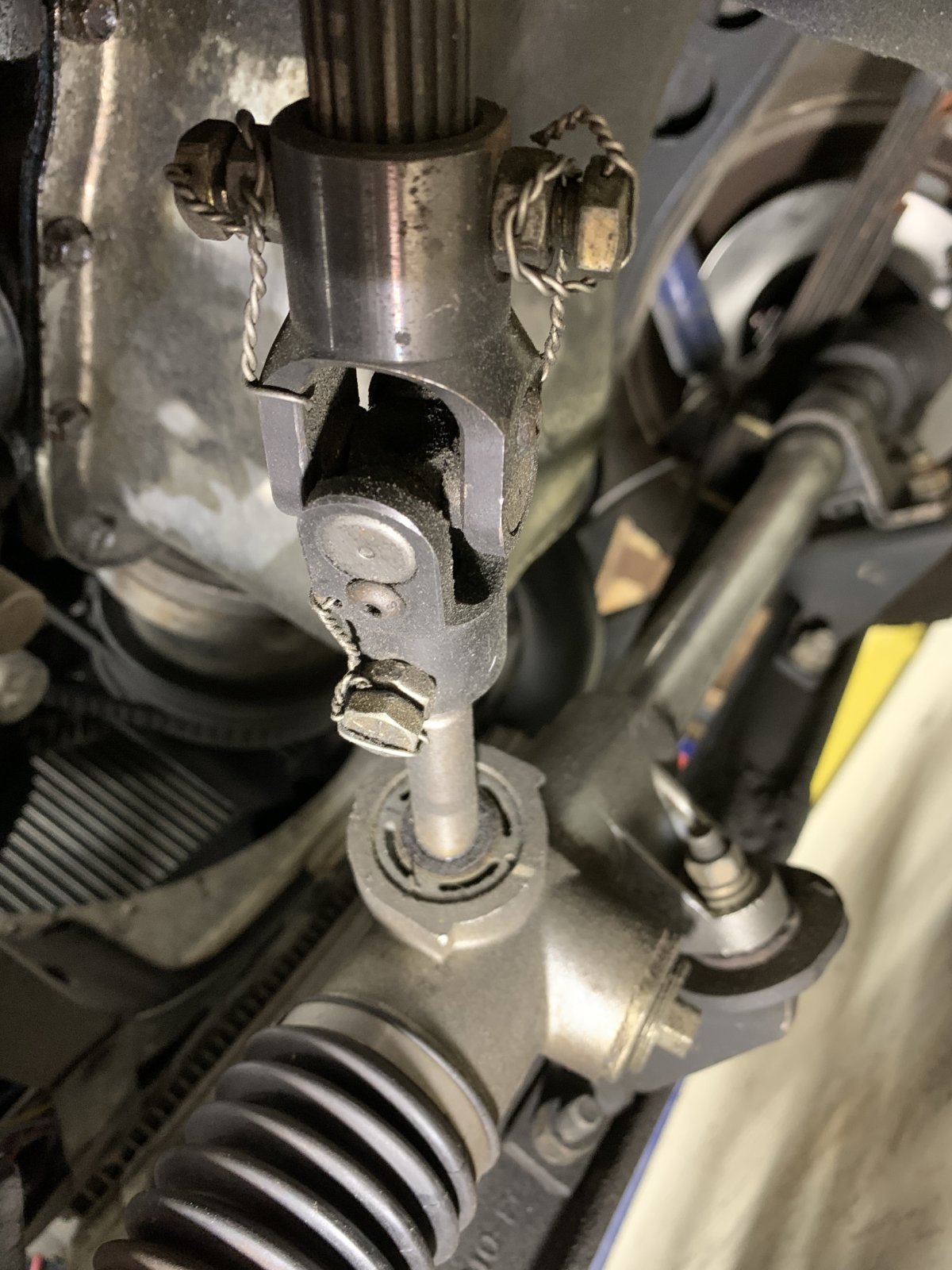

    Here's how I handle steering joints. I'm not trying to win style points in this application, I'm trying to ensure the thing stays together. This joint has about 60,000 miles on it in my Willys. Yes that's a R&P on that axle- the horror! I had a cruel task master in the Military. He had me wire up a hub full of bolts in a jet engine. He looked at my hour's worth of wiring and said, "Too lose!"- and proceeded to **** the middle of each run. He said, "do it again, you need the practice." Well, he was right. I do hate doing it though, especially in confined spaces. 9F53B997-5341-411E-BF48-F51C7421E18C.jpeg 9FBE88EA-46B3-4041-84E8-B1A039797E0C.jpeg

    beautiful work. Probably as good as any I have seen or done
