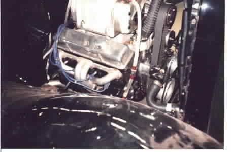

    Here's mine. The blower drive belt runs behind the water pump. I used two water pump extensions to space the water pump out from the block and made a mount to set the alternator forward. The bottom pulley is the gear drive with a home made pulley made from a large chunk of aluminum bolted to the front of it to drive the water pump and alternator. Manifold is a Wieand. No idea where the snout came from.

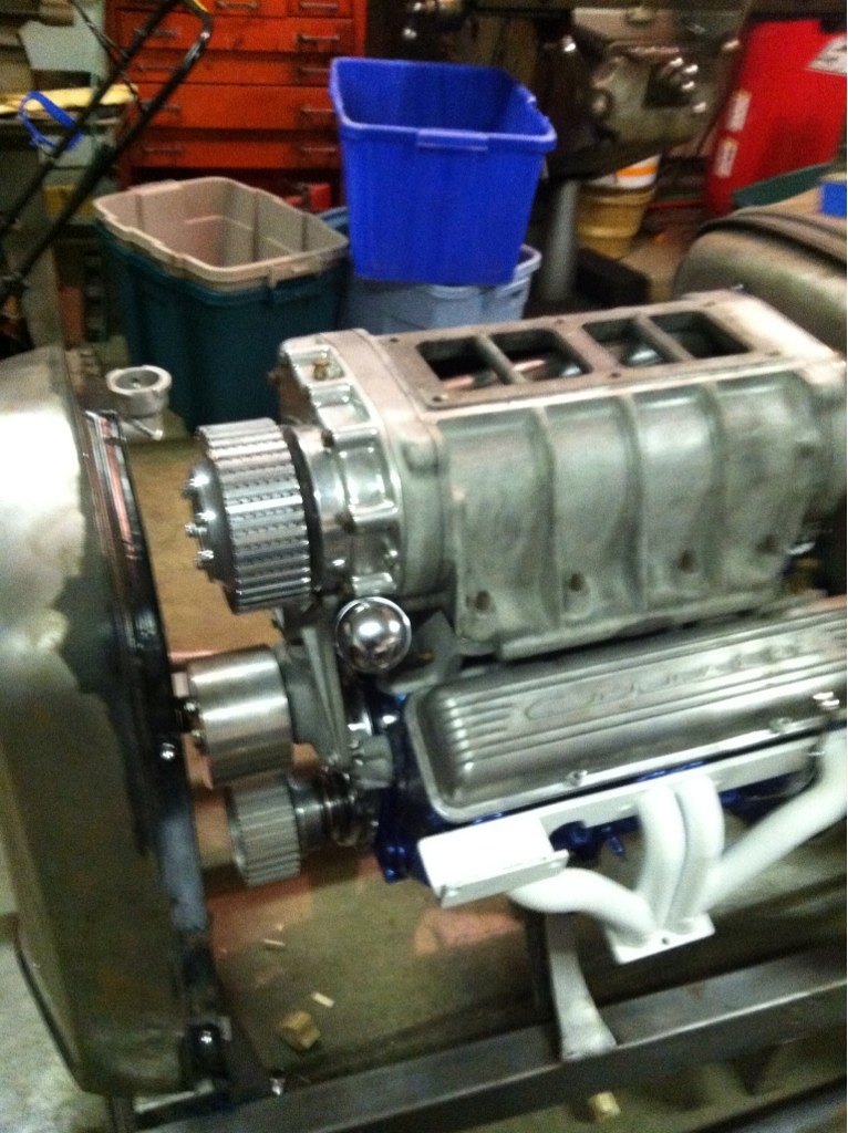

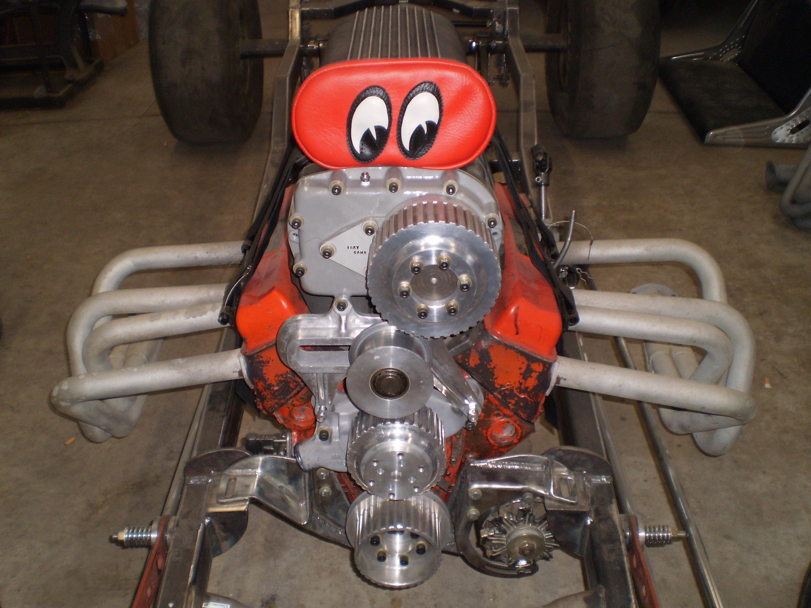

    Was going to wait to out these up but I've been bored lately. Still waiting for and idler pulley but I will most likely end up machining my own.

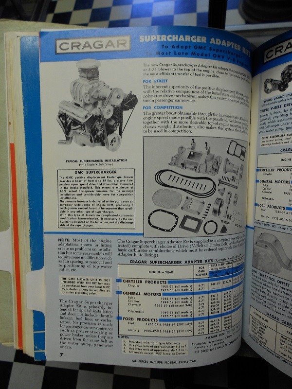

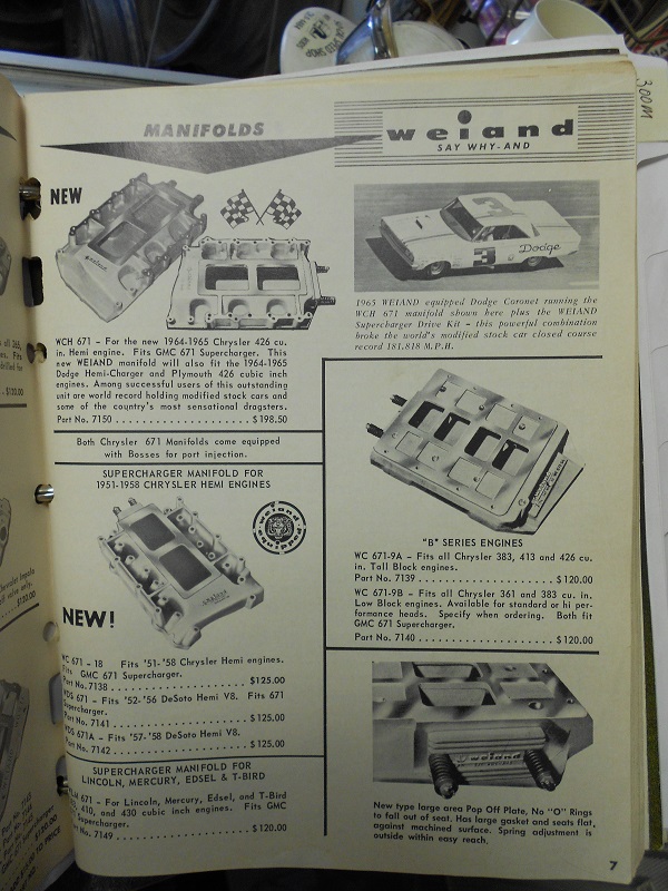

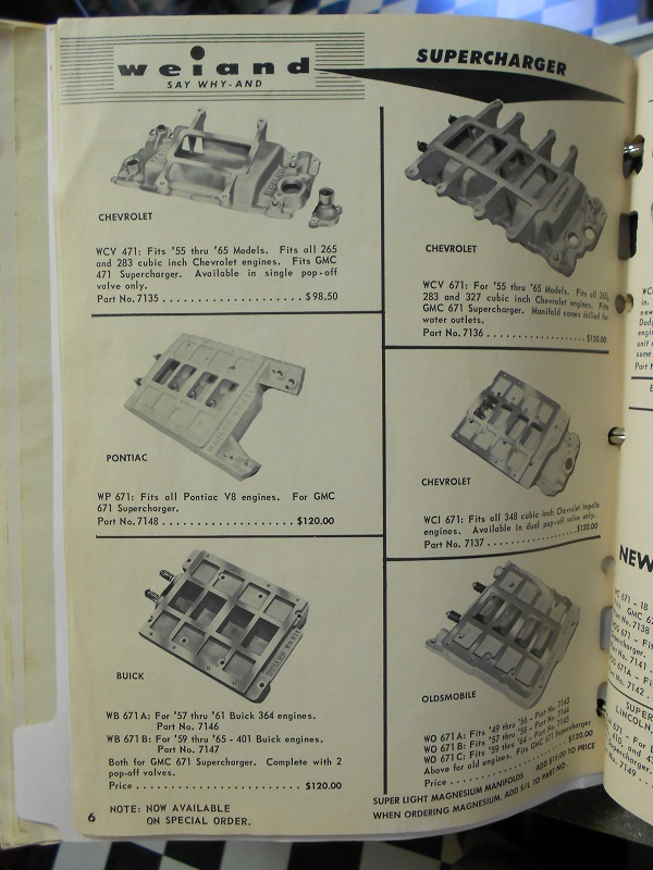

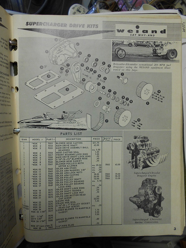

    A few pages from a buddy of mines catalog collection.
