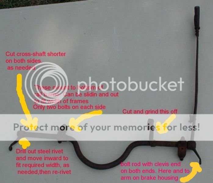

    It was the most common practice to use adapted Model T Ford Brake handle, cross-shaft (with the "U" shape in center, to clear the drive-shaft), bottom rail mounting brackets, and outer cross-shaft, brake-link cast ends. It was more common to use both rear brakes than one. This set-up was commonly used on Both pre-war midgets AND sprint cars. The cast brackets (in which the cross-shaft rotated) that mounted to the flat bottom of the rail frames, could be easily slid inward or outward to match the width of the frames. Actually this photo would be a Reverse, or the mounting, as the long brake handle would almost always be on the left side of the car.
    Many of the pre-war midgets also used a cut-down/narrowed (about 3.25 inches on EACH side) Model T rear end. Almost always from the 1926 and 1927 Model T, that had the Larger brakes. Many of the early, pre-war Sprint cars used a Model A rear end, and this Model T handle and cross-shaft also worked with them too.

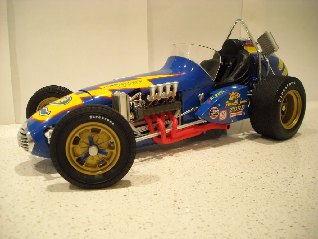

    My favourite GMP releases are the 1/12th dirt champ cars. Having never seen a champ car in anger on dirt, I just sit back ...look at my model and wonder what it would have been like.
    Here's 1 of mine. I recall purchasing this by Fax from GMP on the day it was released as they weren't available in Australia back them.

    I wouldn't mind finding one of those monsters in 1/1 scale that runs! Great model, though I'd be afraid to ask what the price was. If you go to Youtube, you can find old films of dirt champ cars in action.

    Bob, I can understand your wondering. I watched this car win at the Indiana State Fairgrounds mile dirt with Al Unser Sr. driving, from the inside of the fourth turn. It was really something to see those things go by.

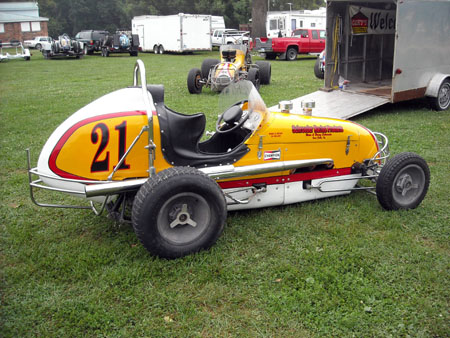

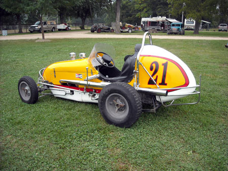

    The Lu Holland V8-60 at Webster City, IA 2008.
    Notice the identically painted and numbered sprinter in the background.

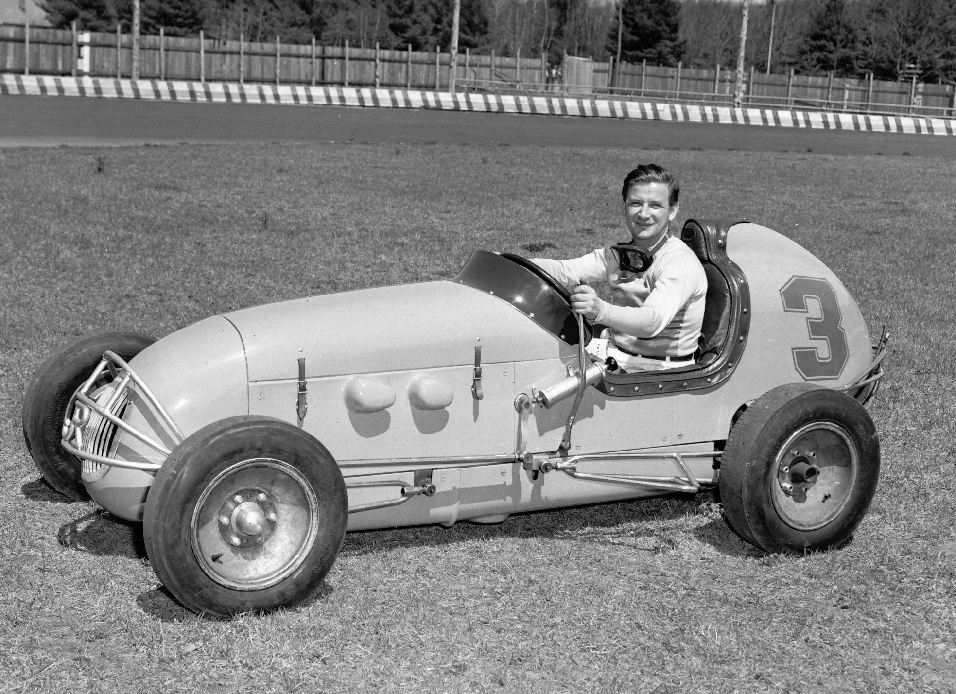

    Here's the real deal - Johnny Ritter in his own Offy.
