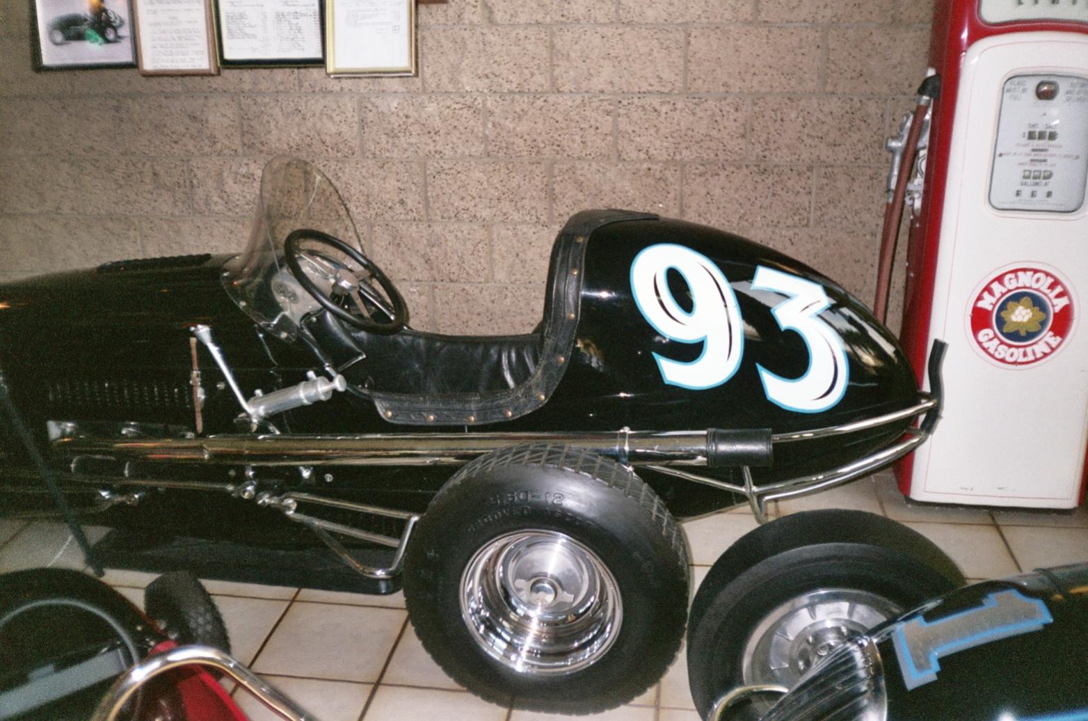

    Later day picture of the Lowe Kurtis in the Justice Brothers Museum and diferent number.

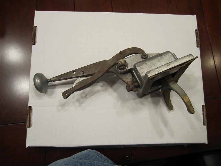

    This box has "Greer Manning" written on it...
    Ambler in/out
    Ambler change boxes
    Can anyone Identify these?
    This one is steel

    Hey Zach, the second one down that you want ti identify is a Progressive In & Out Box, it bolts on the front of a Progressive quickchange. The little dogs engage the driveshaft to the pinion. I had one in a hillegass midget, worked real slick

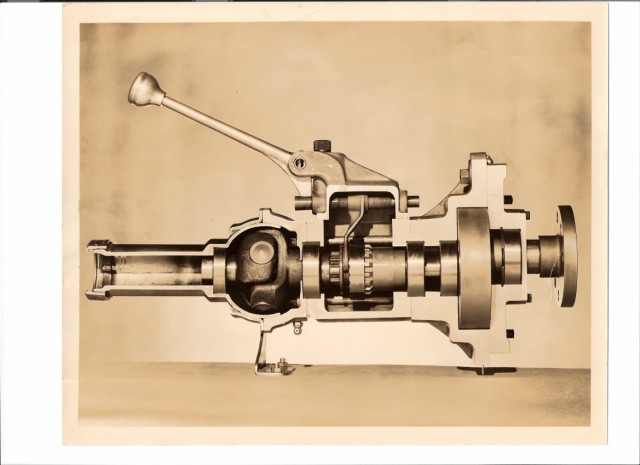

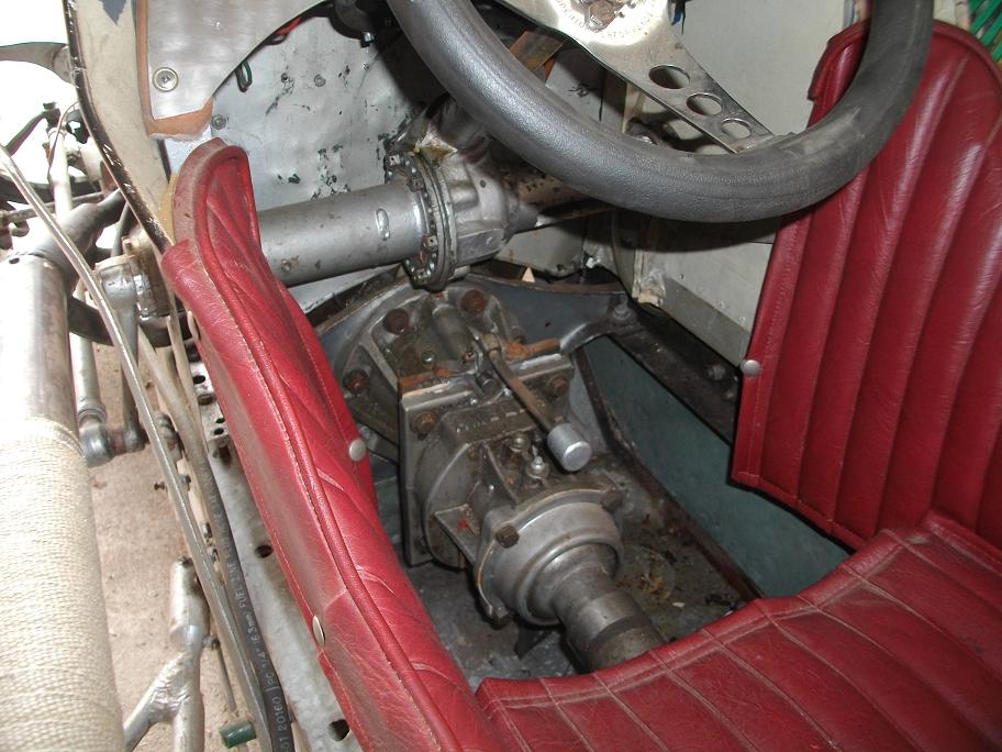

    These are pictures of the Bell front quick change prewar. Hope this helps

    Zach and Sideways27...this wonderful picture and cutaway of the Bell box shows the in out section to be aft of the change gear section.

    so in these photo's I am looking at an ambler in & out box with a quick change gear box in the rear? also in the picture it looks like the box is mounted to a metal 'mid plate" then to the block that had the bell milled off...where's the flywheel?

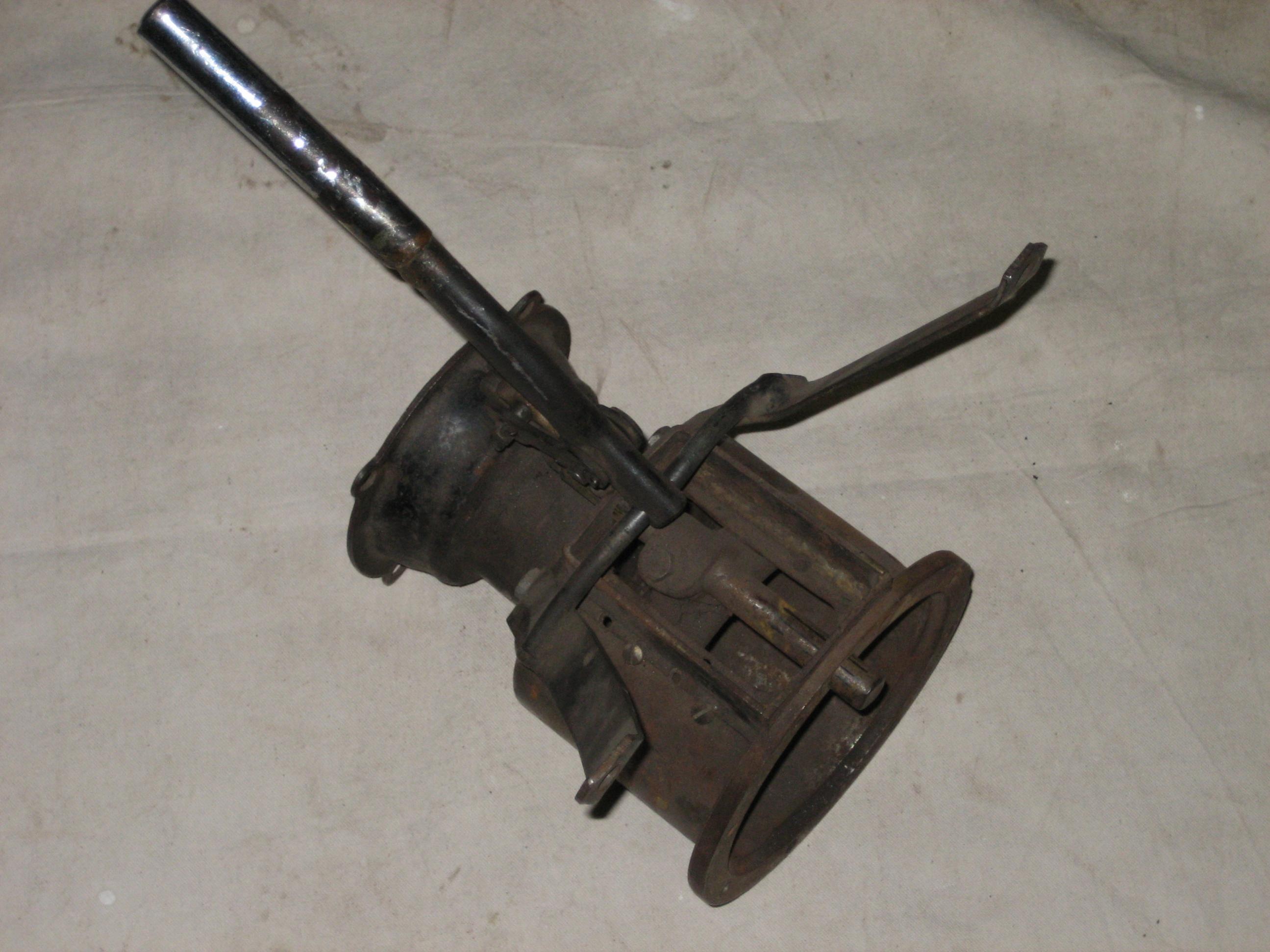

    Here's another in-out box that came with my car project in 2002 and was incomplete and of dubious origin. Looks like a home brew made from a large diameter piece of steel pipe and a decently made flange welded to it, with a torque ball housing off a Ford transmission.
    There were no guts with it.
    It went away the e-way.

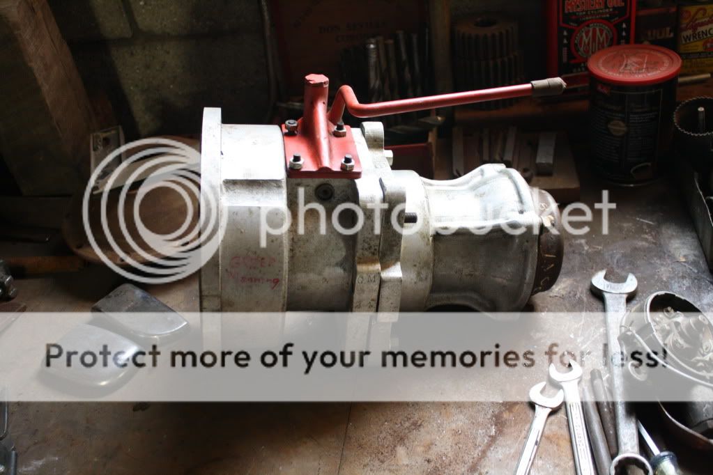

    I am giving up searching for one ( i am always a day late & a dollar short!) I was offered this ARC box, it has no internal gears but would work for a static display & let me finish my project. anyone got any input on this box, what year it was from, would it be used with a
    v8-60 etc?
