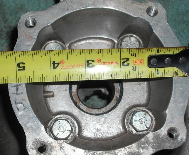

    hey anyone of you guys have a 13"-14" flat 3 or 4 spoke steering wheel laying around that you may want to sell? I have been looking for awhile and either missing the ones that are for sale or finding larger ones. Please PM me if you can help or give me a lead on one.
    also I just posted this in the "wanted" area but figgured I's share it with you guys too:
    I am looking for a torque tube bell retainer to bolt to my in/out box for my midget racer. it is a four bolt mount like the ones shown in the pictures below. Please PM me with any info on one you may have for sale or leads you may know about that you can p*** onto me.

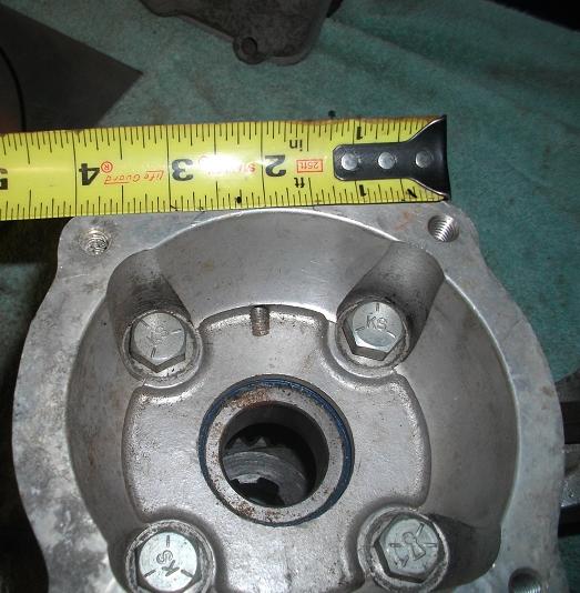

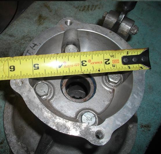

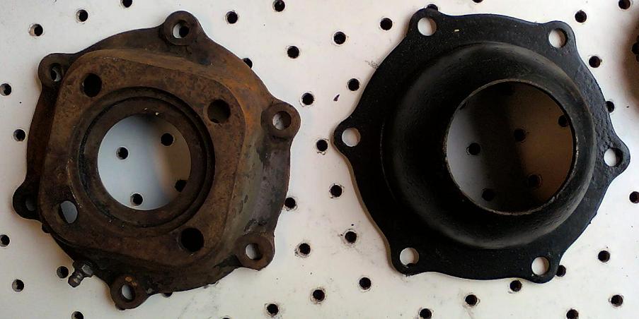

  12. the shadow
    Joined: Mar 5, 2005
    Posts: 1,105
    the shadow
    doc,
    here's my problem, I am trying to figure out how to bolt up my cornis I/O to my existing T-tube that was in the midget originally. the rear t-ball retainer is 4 bolt to the box & to the t-tube but it does not match the t-tube sides retainer (see pics). I need to figure out if I need to change the retainer on the I/O or change the one on the t-tube side. and if so I need to find out what vehicale would I be able to match it up to. did chevy use a t-tube as weel, maybe I can just change the flange on the tube side. also it's one peice & not a 2 piece like most fords I have seen?
    Paul
    the t-tube side cover that I have (1 peice witha groove for gasket)
    this is the back of the I/O box
    here's the 2 together, they don't match but (bolt patterns)
    Paul
  13. gearguy
    Joined: Jan 27, 2010
    Posts: 286
    gearguy
    What is the diameter of the ball and the bolt circle diameter. I have several flanges in my inventory and can help you out if you supply the dimensions.

  15. the shadow
    Joined: Mar 5, 2005
    Posts: 1,105
    the shadow
    chuck,
    I measured the rear bell of the In/Out box and it was a 5.250" diameter with a 5.250" center to center bolt measurement across the top width & diagonaly, the center to center of the side bolts is 3.250" . the measurment from the outside of the bolt tabs is 6". I took some pics to help explain, I hope you have somehting to fit it!
    Paul
  16. gearguy
    Posts: 286
    gearguy
    I have a stamped steel piece that should work. 5.25" bolt circle with (4) eq. spaced holes. PM me with an address. It'll fit in a USPS flat rate box & be there in a few days. More trouble to collect the $5.35 shipping than it is worth. Pay it forward to someone else needing a part instead.

  17. the shadow
    Joined: Mar 5, 2005
    Posts: 1,105
    the shadow
    Thanks chuck! PM sent !
    thats the power of the Hamb!!!
    paul

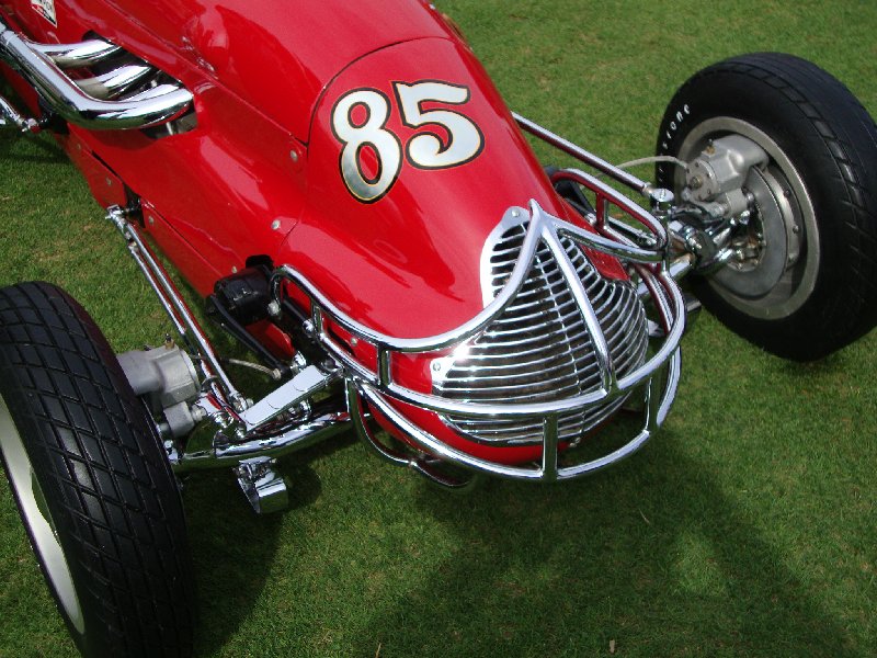

  20. Saw this little Kurtis in the Amelia Island show.......so cool.

  22. Jim Nise
    Joined: Oct 31, 2008
    Posts: 1,211
    Jim Nise
    Black Vette 59,
    that midget looks like the lesovsky Harry Hespell owned and later became the Jolly Cholly car. That is all but the front nerf bar, which is a configuration i have never seen before.
  23. slobitz
    Joined: Feb 1, 2008
    Posts: 245
    slobitz
    from drums, pa
    Looks like the Snook Offy. Afriend of mine Dave
    Clark sold it to a gent down south, I do not know who owns it now.

  27. gearguy

    PS: We worked in the same shop where Harry Turner re-bodied a car for the 1946 Indy 500 and built many race winning midgets. A few feet away the famous Ernie Fredricks' midget roadster awaits a new header before starting its vintage career.
  28. Spoke to the guy who now has the car,and he said it was originally owned by Cadilac Booth in 1948,in 1954 it was owned by Louis Snook,he changed the V8 60 for the Offy.Drivers included A J Foyt and Johnny Rutherford.......love the nose.....
  29. CTtoPA
    Joined: Jun 17, 2008
    Posts: 252
    CTtoPA
    I believe Wayne Ewing built that nose.
  30. the shadow
    Joined: Mar 5, 2005
    Posts: 1,105
    the shadow
    just a quick thanks to chuck (gearguy) for hooking me up with the right bell retainer, bolted right up...Awesome!!!
    Paul
