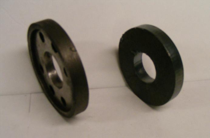

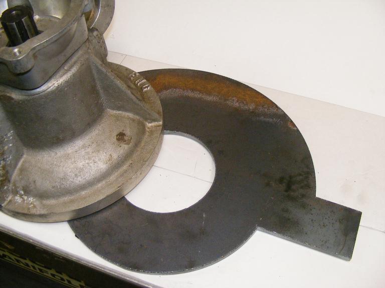

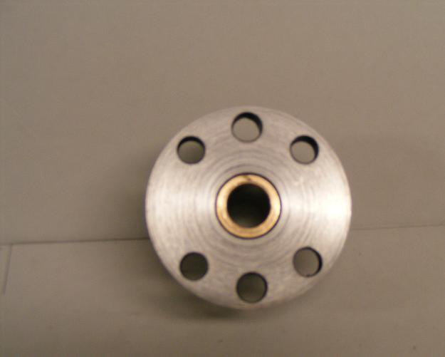

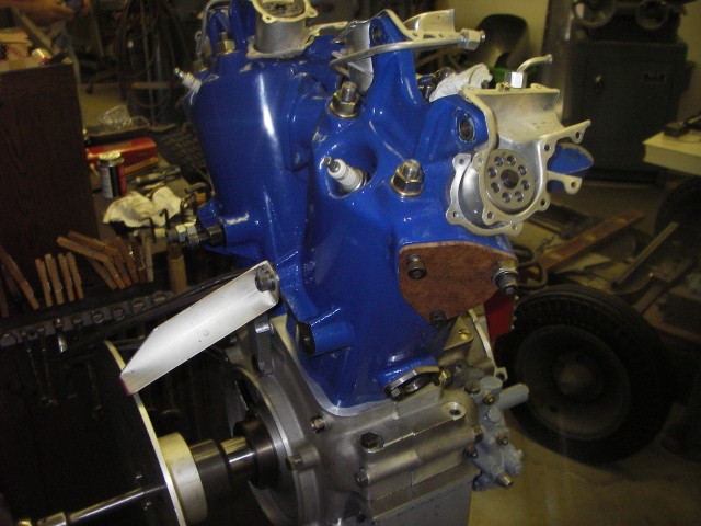

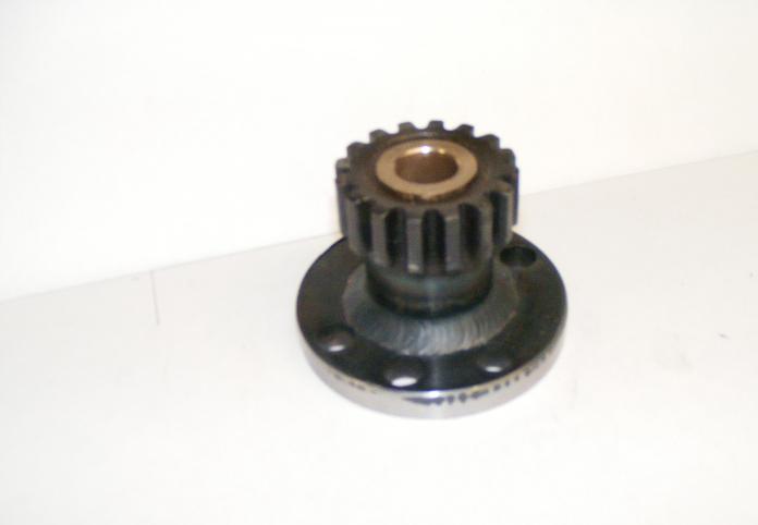

    my progress report:
    a few posts ago I was asking for info on useing the cornis In/Out box I had. after posting pics up of the pieces I had + the story behind them I got alot of great info from you guys with replies & PM's. I bit the bullet I decided to go with machining the rear bell off & mounting the I/O flush tot he crank with a mid plate. I haven't cut the block yet but I got the I/O input shaft & mid plate mostley done. here's a recap on what I did during my lunch breaks & a few saturday afternoons:
    I found I could not weld the input gear to the stock cast steel crank flange, it started to bubble during the tig process so it must not be real pure casting? I ended up cutting a disc out of new steel on the plasma table then machining the dowl & bolt hole to match the stock one. then I machines a shoulder on the input gear ,squared it up on the flange & tig welded it up. afterwards I had my buddy face the ***embly in a lather & we machined a piece of oilite bronze bearing material to be press fit into the center. we cut the input shat to length & polished it then honed the new bearing surface to mate to the shaft.
    then I used the stock bellhousing radious as a templete + my frame ID to make a mid plate templete. once I likes what I saw I plasma cut a piece of 1/4" material for the mid-plate.
    I have to drill & tap the plate for the I/O box + drill the box flanges but that should be a walk in the park. next I have to layout my cut lines on my engine block, cut it on the large band saw at work & have my engine guy mill it square to the crank face.
    Paul

    That looks great. I think you have a good handle on the situation. Jake Jacobson told me many years ago that he had converted one of their midgets to use cut blocks so he could use their hydroplane engines in it. That might be an interesting thing to explore as there are still a lot of limited hydros that use V8-60s and some are wicked fast.
    Doc
