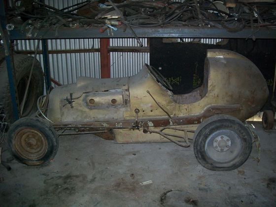

    I'm supposed to go look at this car soon but all I have to go on so far is this picture. The owner is no longer here to answer questions. Would this be a midget or a sprint? And how much of a difference would there be? I'm guessing that some of you guys that know more than me might have an idea of what the engine should be based on the hood sides and scoop on top.

    Offy mdget.. Unless the car has great history it would not be worth spending what an Offy would be worth
  9. All that can be said is that it is a rail frame midget. Knowing the manufacturer would be a big plus. If it was a Kurtis, lets say, then certainly worth preserving.However it doesn't appear to be a Kurtis rail frame midget.
    Offenhauser was an engine manufacturer only. No evidence that an Offy engine lurks under the bonnet. In fact looking at the shape of the sump (oil pan) that looks nothing like an Offy.
    Having said all of that , if you are thinking investment opportunity then do your homework carefully . If you are thinking of a enjoyable project then hop straight in and let the journey and fun of the restoration begin.

    More interested in a fun project, I actually would be more hoping something like a V8-60 but the hood sides dont look like a V8. I've seen pictures of cars with two air cleaners coming out the side, what other engine options would that be? Is it old enough to be a Ford 4-banger?

    The price of the carc*** would be the determining factor to me. Any of a number of engines could be put in this that would be age appropriate. A Ford-Ferguson tractor engine (Triumph TR-3) would work, for example.

    Very few rail frame midgets had Offy motors and even fewer had Ford Fergies. If you are new to vintage midgets your first purchase should be a copy of Jack Fox's Mighty Midgets book. Speedway sells the re-print version.
    In the back of that book is a list of the many types of motors used in midgets over the years.
    Look over the hundreds of photos, particularly the pre-war years. Before WWII there were perhaps 500 midgets total in the country; after the war there might have been 10x that many.
    If you purchase the car take lots of pictures to post here and to show people at vintage racing events in your area. Odds are someone will recognize the car. Once you know what you have you can decide just how authentic a restoration it needs.
    Look over similar cars at vintage events for ideas. A number of people have put more modern 4 cylinder motors in the rail frame cars so they can enjoy running them. A junkyard Ford Focus or Chevy Ecotec or VW Golf motor can be running in a midget with motorcycle carbs & ignition for less than $1500. A 110 Offy motor that runs will be 10x that or more; even a running V8-60 will approach 4 figures.

    What Stan said is most probably correct. That hood is cl***ic Offy. There is a rail frame Offy running with the CVOR group in Colorado. I have forgotten the owners name. It has been rebodied at some point but may well have been very similar to the car you have pictured.
    Similarly, the pictured car may have been repowered with an Offy at some point.
    As pictured it would definitely not have been a Ford Ferguson as they had intake and exhaust on the right side unless it was a rare "F" head conversion which did have a cross flow head with intake on the left.
    In any event, if you buy it, unless you can positively find history, restore it to please yourself.
    Were it mine, I would use an engine that emulated an Offy. I believe there is an Alfa Romeo and a Fiat engine, both from the '60's, that have the left side intake as well as the DOHC. There are probably several later day engines as well as Chuck has mentioned.

    Some good info, but of course some of it conflicting. An actual Offenhauser would be an investment and that's not really what I'm looking for.
    That book sounds great but I couldn't find it at Speedway, Amazon had some and there have been some on ebay but not right now. I had wondered about the modern drivetrain but was afraid it would be frowned upon by the vintage crowd. There was a VW midget at Jungle Park this weekend, was that you? I was there with the 1/4 and 1/2 midget project cars.
    Do you know what time frame the rail midgets were made or were popular?

    Rail frame midgets were made from the beginning in the 30's and in decreasing numbers after WWII with the popularity of the Kurtis type tube frame movement. Solar began quan***y production after the war utilizing a (stainless steel) rail frame
    Kurtis did not start the tube frames however as they were being built in the mid to late 30's by Reichenbach, Marchese, Pete Nielsen and others.

    Just a late afterthought...and only my opinion...if you do acquire this car and restore it, certainly get rid of the that air scoop on the top of the hood, it's got the uglies.

    I see your point 28, but I think if it is original to the car maybe it should stay. Sometimes its the warts that tell the story of the beauty of a restoration.
    Take the Plymouth Superbird stock cars for example. I think the long aero overhang on the front of them is stone-ugly - they're the Jimmy Durante of stock cars. But I wouldn't restore one without that beak.

    I kinda liked the hood scoop, it was the hood sides that I didn't like as much. If you change the drivetrain you would most likely have to change the hood sides.

    It's the intake side that makes it for me because it's cl***ic Offy. That's why I suggested using an engine that had intakes on that side that could possibly match to what you have.
    I don't know what the other side looks like but presume it was for an Offy as well.
    That hood scoop may have been to bring air to the carbs on a V8-60, but it's still **** ugly in my opinion. Attached are photos of one with and one without, carbs/air cleaners through the hood. The one without I made a housing to fit under the hood that utilized a Datsun carbureted 240Z filter element which is very flat and oval and long enough to cover the carb set up.

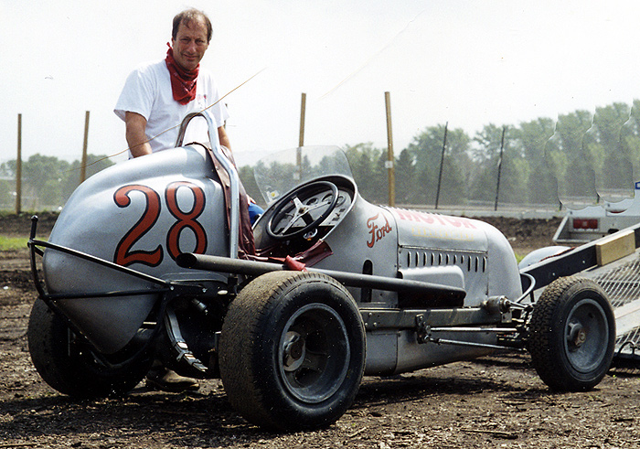

    My 1940 Hilleg*** with Studebaker 6 cylinder engine weighs approx. 200 pounds on each front corner and 250 pounds on each rear for a total of 912 pounds with water and oil, no fuel. I suspect a modern car is not too different from this.
    Midgets have always been nominally 72 inch wheel base. Big cars (later called sprint cars) were from about 82 to 90 and the Champ Cars (made primarily to run 1 mile tracks) nominally 100".
    The early midghet tires were typically 4" to 4 1/2" wide fronts, 4 1/2' to 5" rears all mounted on 12" diameter wheels of 4 to 5 1/2" width. Todays wheels are all 13" diameter.
    Handling and horsepower make today's midget car a world apart from the old cross spring cars with the advent of first parallel (to the frame) torsion bars, then cross torsion bars, and coil springs coupled with hi-tech and high priced shock absorbers.
    Why no more 100 mile midget races? If you had a $100,000 purse spread through the contestants, the winner might be the only one to make any money beyond expenses (with $40,000 engines) plus it would be boring.
    NASCAR rules are orchestrated to provide nearly half the 43 starters being on the same lap as the leader after 500 miles. Read in the news paper the $ payoff for the last place cars and again they all have significant corporate sponsorship as well because they have TV exposure and can keep some people who are waiting to see the next crash, entertained for 3 or 4 hours. Then the winner is rarely the fastest car and driver, it's a matter of strategy, luck, fuel mileage, etc.
    Sprint cars (and midgets) were made to run sprint races. Short tracks, balls to the wall for 20 miles or less on 1/2 mile and shorter tracks. If you can find anything more exciting on four wheels, tell me about it.
