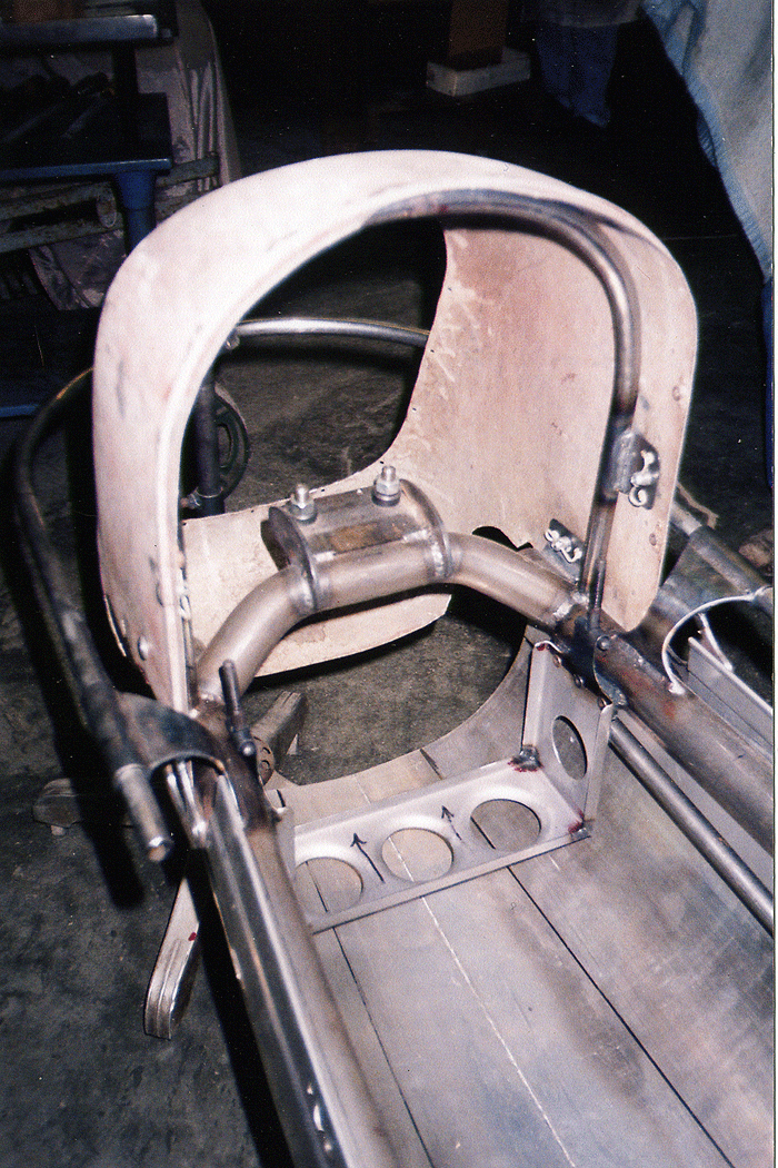

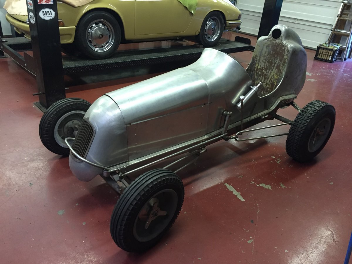

    IMG_0111.JPG IMG_0111.JPG Hi I'm new to the forum and this is a 1946 Solar midget that I am in the process of restoring. I have a v-60 engine that will be going in it. I am currently searching for a radiator and a header kit that will work with this. Any information would be appreciated. Thanks!

    If you want a new aluminum radiator I have had success having several custom radiators made by Superior radiator in Mt Clemens, MI. It is best to sent them a 3D cardboard mock up showing the location of connections, etc.

    When I restored my Kurtis V8-60 in 1987, I got these jig built headers from Ermie Immerso at Thunderbird products. Welded up and ready to go. I don't know if Thunderbird is still around since Ermie p***ed a few years ago.

    Very nice looking Solar. I have a Solar that I bought in 1989 at an estate sale. I ran it with a vintage group on dirt in 1990 and had a blast. It had been updated to a Chev II at some point with a converted tractor magneto and Riley sidedraft carbs. I do not have a spare radiator, but open to any questions, measurements or info you may need. Good luck.

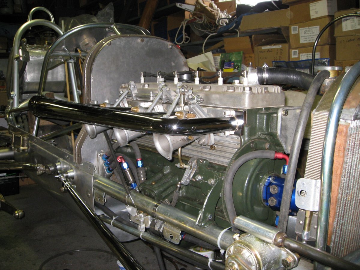

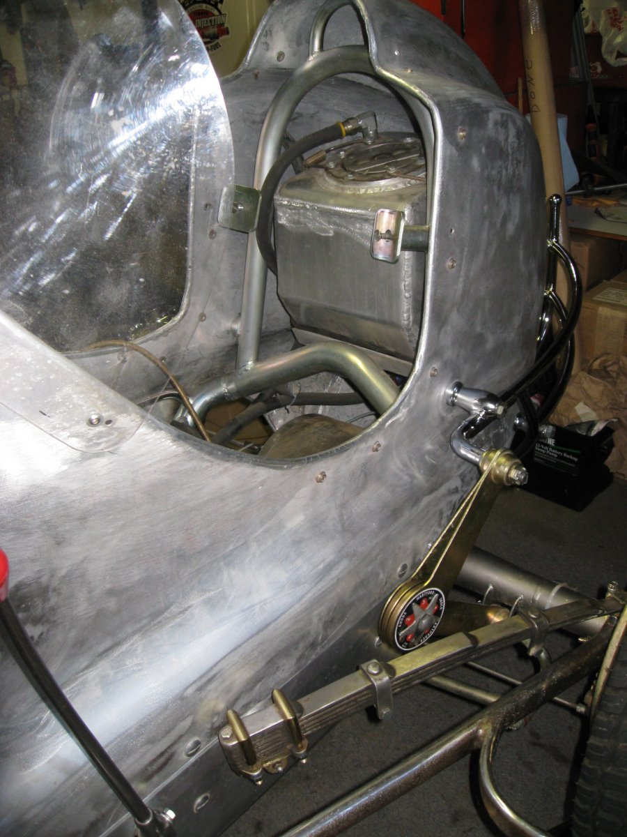

    Thanks. If you could tell me how the radiator is mounted in your car it would be helpful. The other thing I need is a photo of the fuel tank and mounting. I don't have a tank so I am probably going to need to fabricate one. I am going to have Superior Radiator build a radiator for the car.

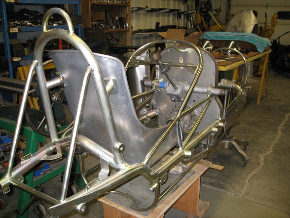

    Here is a picture of the radiator saddle and the threaded swivel mounts mounted to the frame. The second picture shows the nylon strap up and around the radiator with a sheet metal right angle bend which rivets to the ends of the strap on the vertical and a hole on the horizontal that goes over the threaded swivel mount and has a spring then a tall tightening nut made from hex bar stock, partially turned on the OD and threaded for the swivel mount. There is a rubber pad in the saddle the radiator sits on.
    The last picture show the frame where the fuel tank mounts. The tank rests on the corner brackets and the angle iron on top of rubber pads. It has a similar arrangement to hold it down but the flat sheet metal that is riveted to the straps has two holes to bolt directly to the tabs welded on top the frame rail. Across the top of the tank is a 1/8" formed steel rod that each individual side strap connects to and is fastened to the tank by the filler mounting bolts. The tank we custom fabricated.
    Hope this helps.

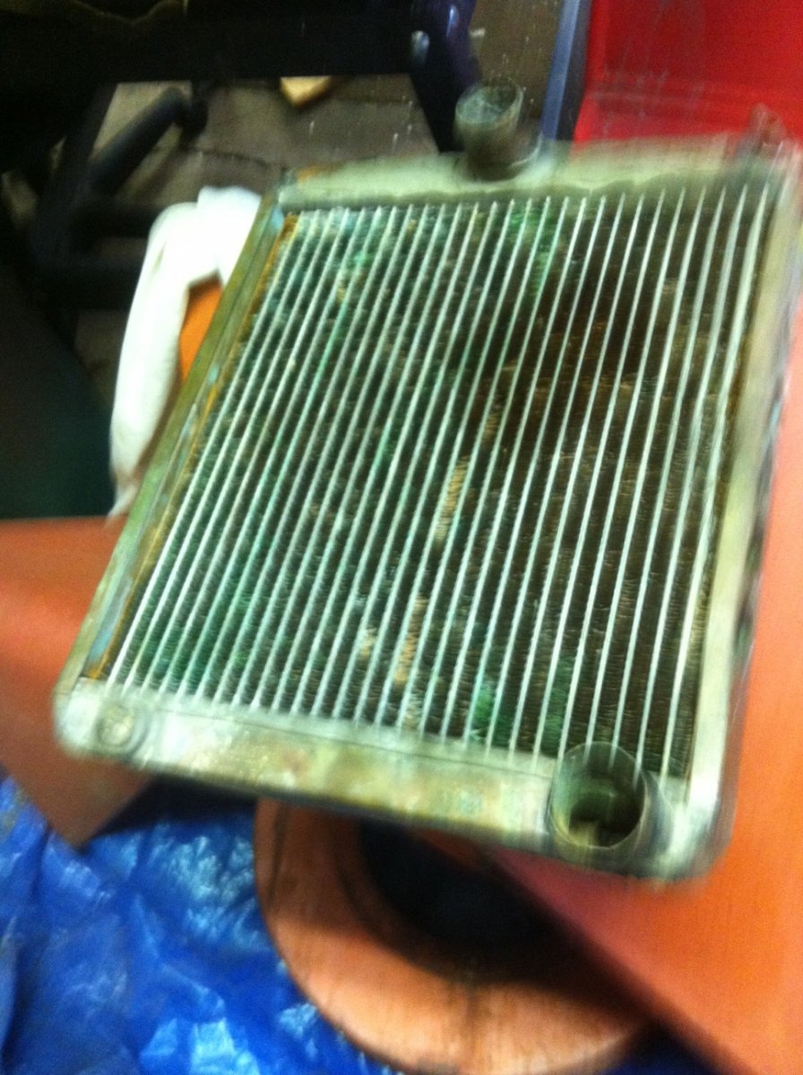

    I have three radiators suitable for vintage midgets. PM if you need one.

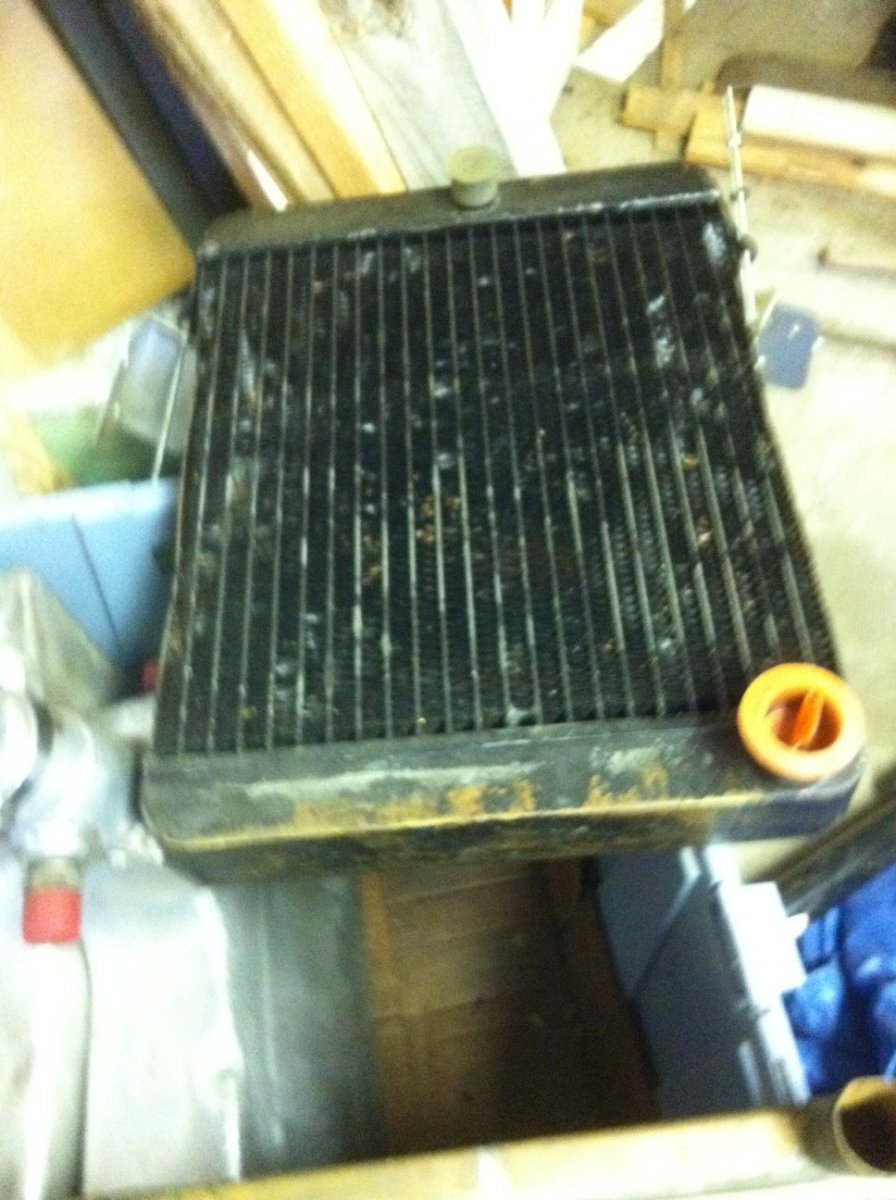

  19. gearguy
    Joined: Jan 27, 2010
    Posts: 286
    gearguy
