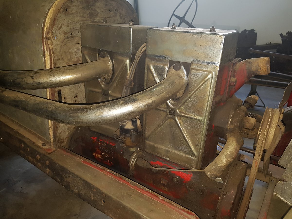

    Thank you for the reply
    The ch***is on the first car looks very well made .almost too good to be home made .. but guess it could have been .
    Attached is a picture of the right hand side of the engine ..

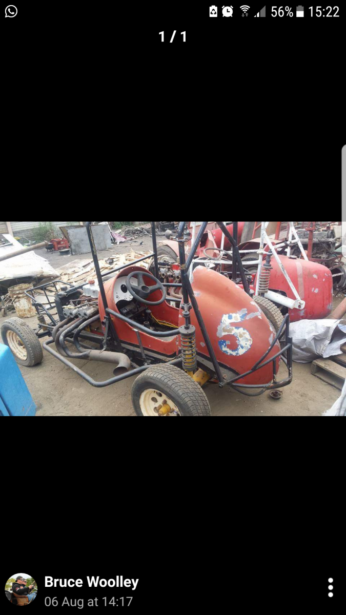

    The second car is a chevy II engine .
    I was thinking of using a flat head v8 in it as it has been butchered already so I can make a bit of a fun toy with this ..
    Some more pics of both cars

    Some more pics of both the cars ..

    That first car with the Chevy is really nice, Vintage photo and a Miller carb, it doesn't get much better than that. Bob

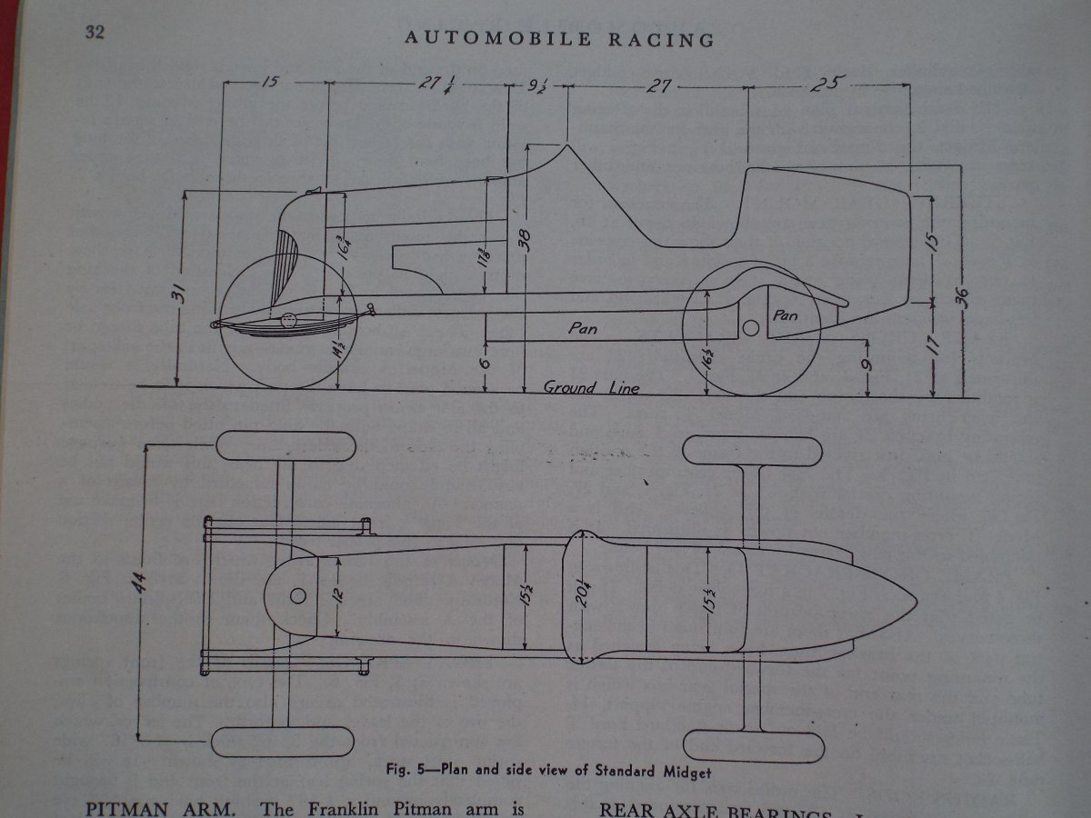

    Do you think the car was built in South Africa or imported? The three spring design was popular with early 1930's builds in California, but plans were sold all over the world. Bob DSCF7253.JPG

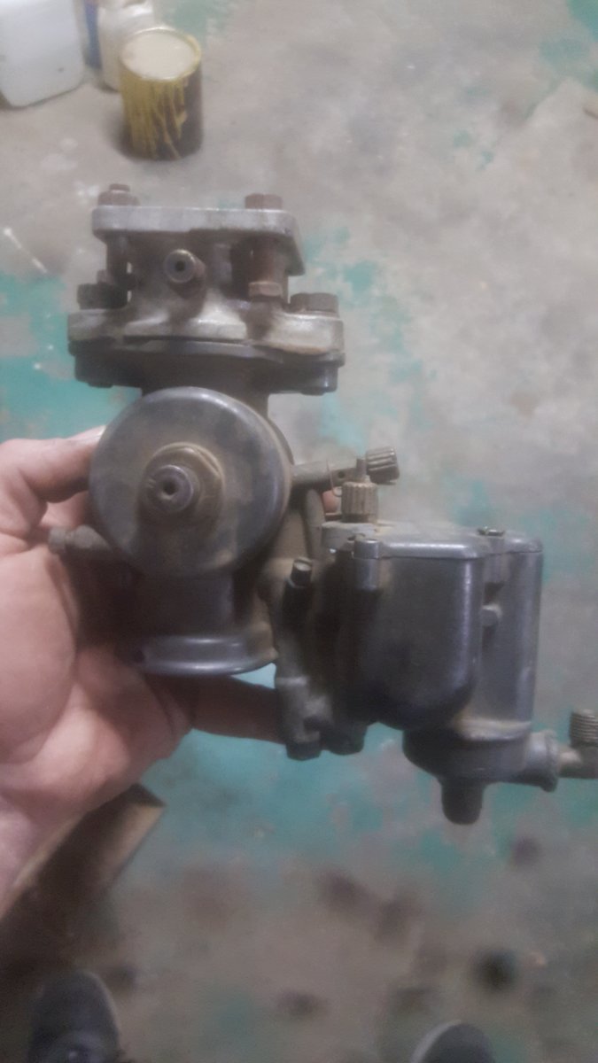

    This is the carb ...

    Ok, I saw the barrel throttle and thought it was a Miller, my mistake. Winfields are great too! :)Bob

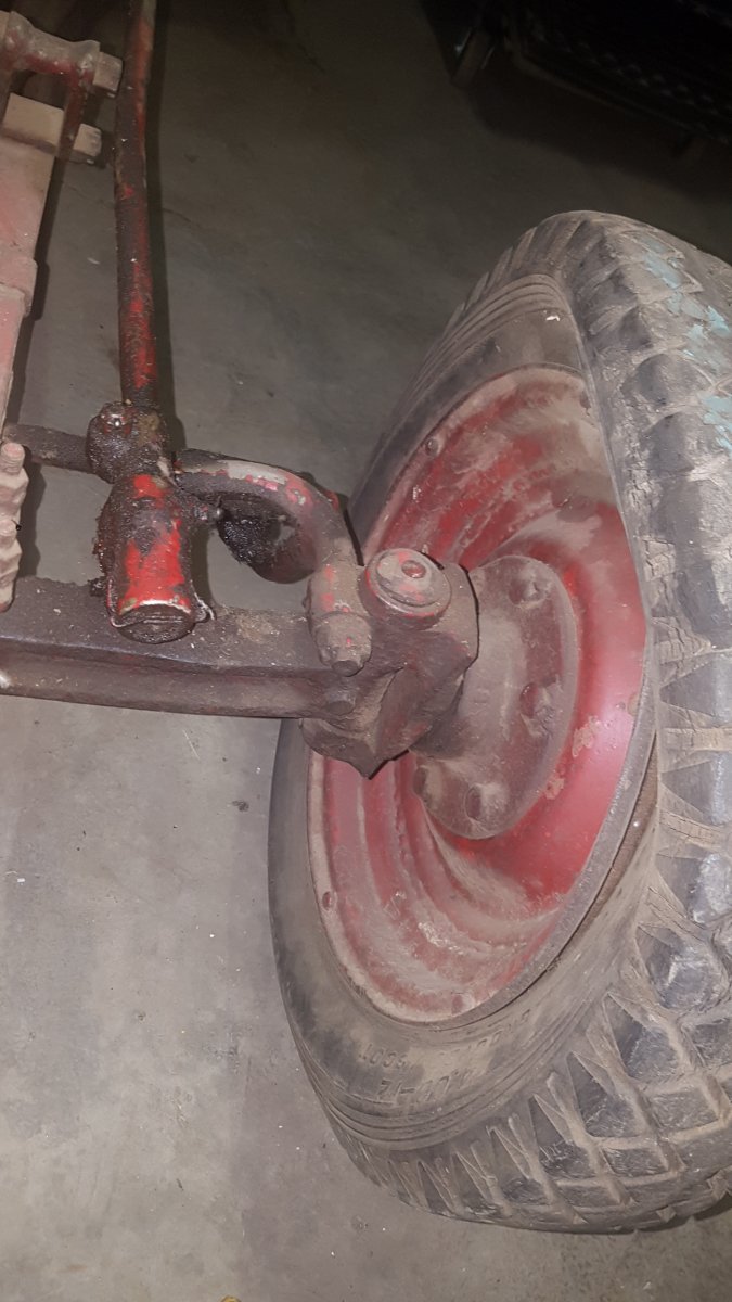

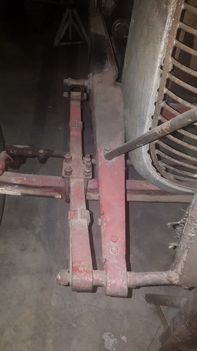

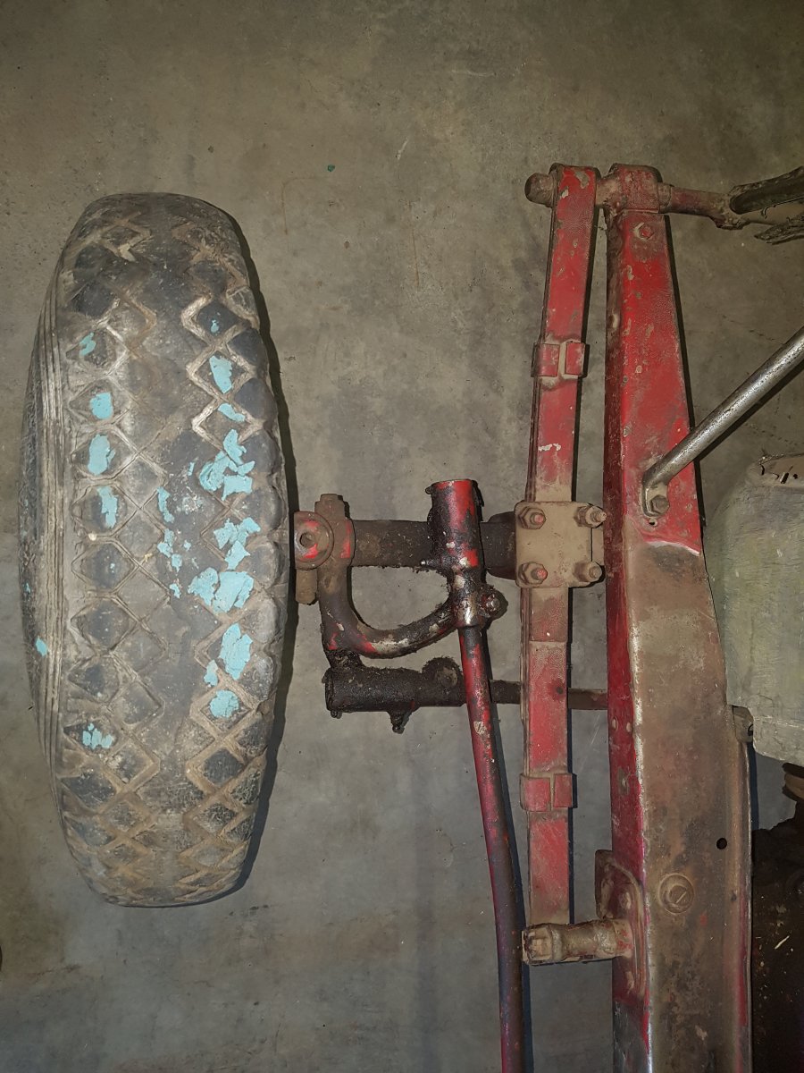

    Pictures of the front axle ...

    The front axle, spindles, tie rod are modified Model A parts the wheels at that time were made from 1926-27 brake drums welded to 12 inch utility rims. The front hubs are Model T wood wheel hubs. Bob

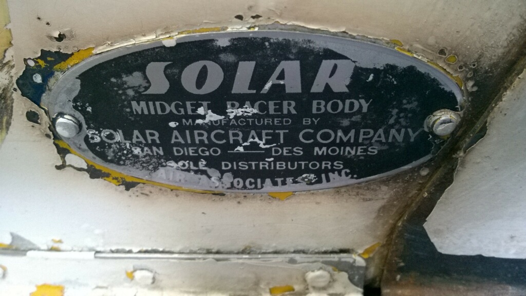

    I'm in the process of restoring a Solar Midget. I'm in search of V8 60 parts, specifically a in and out box and a radiator. I would also be interested in some photos of how the fuel tank mounts (with a strap???) how the fuel lines are ran and gas pedal setup. Here are a few photos of the car pre-restoration. Thanks

    That is a nice looking Midget.
    If you don't have to have a br*** one but are OK with aluminum, try Superior Radiator, Mt. Clemens MI. I just had one built for my drag car. About $300. Five days turn around time. radiator new 01.jpg
