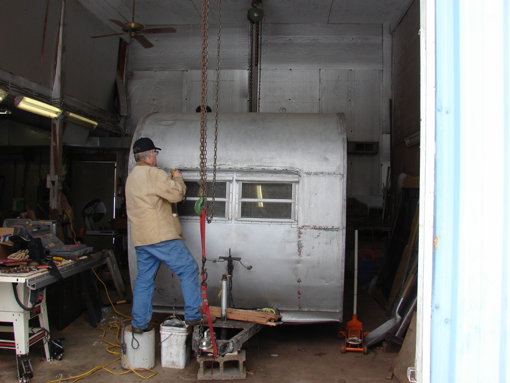

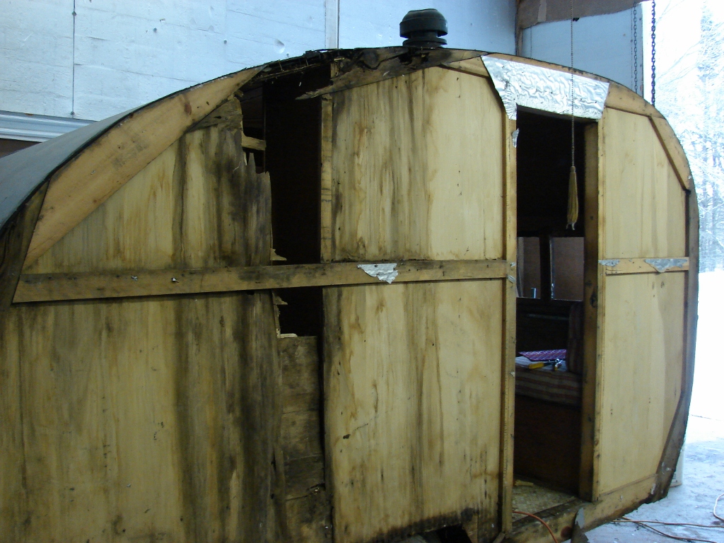

    And some of you thought I wans't going to do anything with this! Yesterday my wife and I started tearing into the "Tini-Home", and the results are disturbing. What in the Hell are we thinking?
    I told here before we started we'd be better off just stating from scratch, but I don't listen to my own advice. It's rotten. Really, REALLY rotten (which we knew), but it's amazing it didn't fall apart on it's own.
    What little framing it had as originally built is largely gone, crumbled into smelly black dust. It is easy to take apart, however, which is a plus.
    Today I'm planning on getting the skin all off, and then we'll go to Home Depot and get a pile of stuff to build a new trailer.
    Here are a couple of "teaser" pictures, more at my blog, just click on the link, shake your head and wonder...
    http://flynbrian48.wordpress.com/

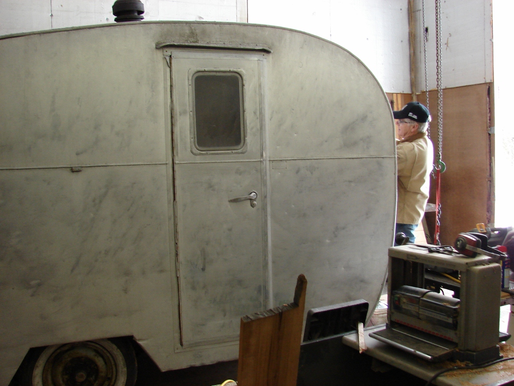

    Remember my cute little camper, the "Canned HAMB" seen just a few days ago hitched up behind the '51 Pontiac wagon? Here's what it looks like after today "deconstruction" session. Yikes.
    It's actually (I THINK) going to be pretty easy to put back together. Amazingly, the floor isn't rotten, nor are the white oak stringers which hang from the outside edge of the floor to which the side walls are attatched. The birch paneling is simply nailed to these stringers, and the 3/4" pine framing which forms the perimeter is then screwed and glued to the paneling. The paneling then is the main structural element of the walls. I'll add more cross stringers than the 3 (aside from the front and rear window frames) and make trusses for the ceiling ala newer RV construction so the roof has a slight crown. It was unbievably flimsily built.
    Anyway, here's a couple pics, more commentary and pics at "Cool McCool's Garage": http://flynbrian48.wordpress.com/
