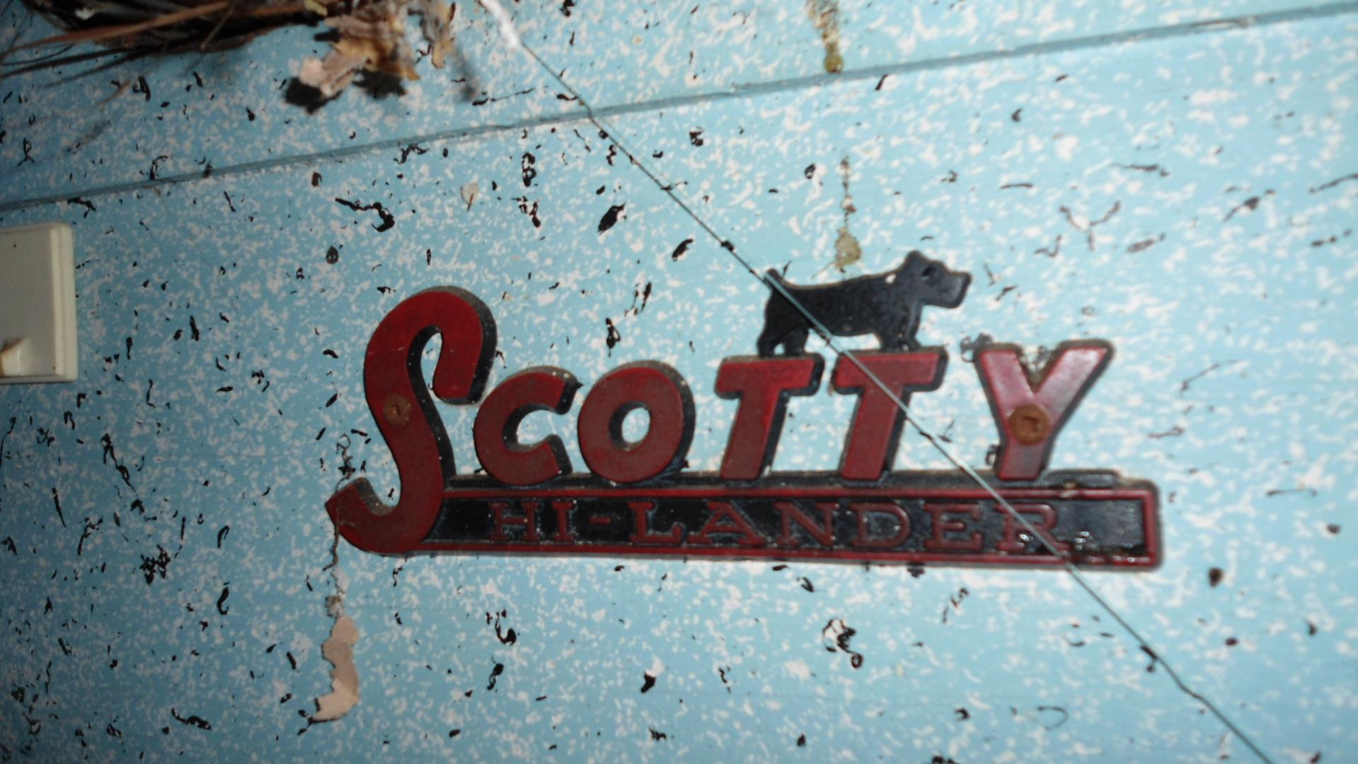

    cool camper,brian. you inspire me! this one needs work.
