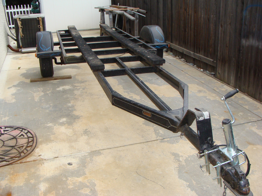

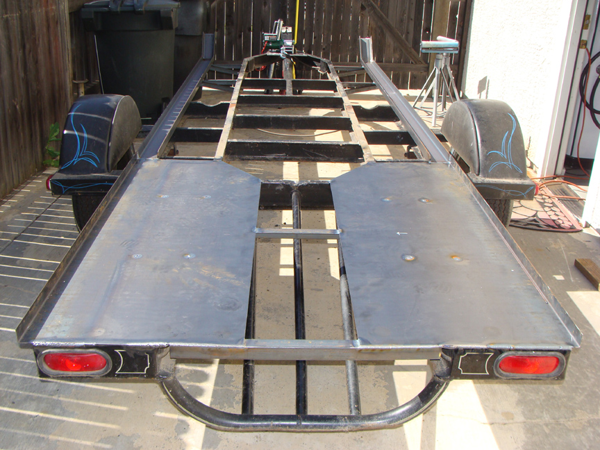

  8. THE FRENCHTOWN FLYER
    Joined: Jun 6, 2007
    Posts: 6,109
    from FRENCHTOWN
    trailer 01.jpg sr_072.jpg trailer 01.jpg I picked up a cheap house trailer frame and made into a car trailer for my Anglia and champ car.
    In the succeeding week I chopped three feet off the back, moved the axle forward, fixed a faulty hitch, mitered in a skid plate to the tongue, added a third draw bar member to the tongue, boxed the front crossmember, added fenders, added three tie-down sites, and narrowed it down so the Anglia and Speedracer will just fit.

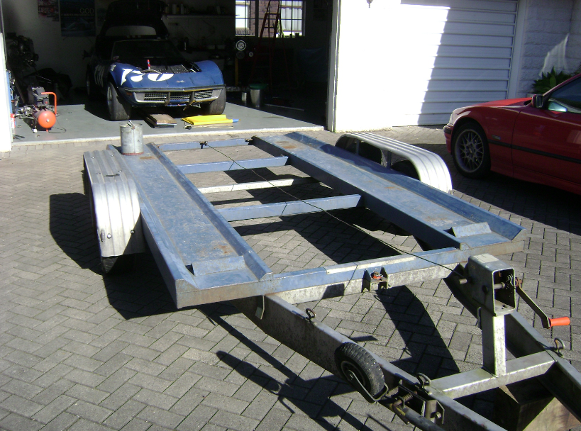

  12. Mimilan
    Joined: Jun 13, 2019
    Posts: 1,255
    Mimilan
    I totally agree here! And the cost of 4 x LT tyres is the same as two truck tyres . The extra axle cost is minimal.
    Single axle trailers are prone to "roll oversteer" due to design. [they sway] This is because the axle steers in the direction of suspension compression which then transfers weight to the opposite side [starting oscillations]
    If the trailer builder does the "unthinkable" and mounts the spring hangers at the rear and the shackles/sliders at the front the trailer induces "roll understeer" which is more stable and self correcting.
    To make a trailer appearance look period requires old style fenders and wheels [keep the rest of the trailer modern]
    Here is a trailer that kerrynzl built 20 years ago. Apart from the 4 x cross-members [75 x50 x 2mm RHS] the whole trailer was folded up from 2mm sheet steel , including the tongue.
    For a spare he simply welded tie-down loops above the axles on the underside. A puncture simply involved jacking and chaining the wheel off the ground [just to get it home].
    He also made the wheels the same as his tow vehicle.
    This trailer weighed 380kg [836 lbs] and was also used to tow farm equipment.
    The life expectancy of paint in NZ is short due to UV
    A few years ago Kerry decided to build an improved version , longer with galvanised deck/runners.
    The runners double as the frame rails.

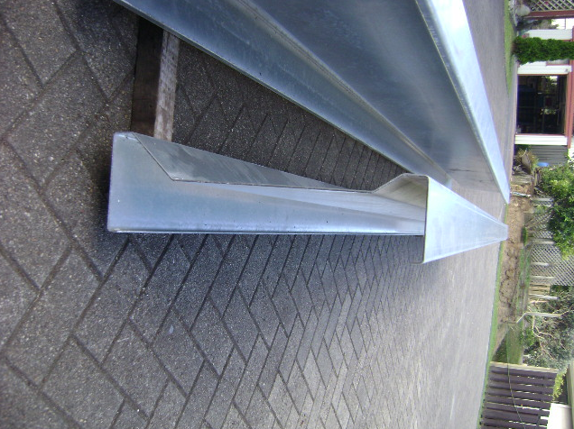

    These were folded in a press brake [to cut costs he built a pair of trailers] This time the tongue wasn't folded , but 100 x 50 x 3mm RHS
    Here is the profile of the runners/frame rails
    Here is a finished trailer with galvanised fenders. The 4.8m deck [16'] weighed 475kg [1045 lbs]
    The 2nd trailer of the pair was dressed up a bit with teardrop fenders and chrome wheels
    It was 5 kg heavier due to the wheels [the fenders were lighter as they don't need brackets]
    480kg [1056 lbs]
    Because the drawbar / tongue is long, it behaves like a longer trailer. It is easy to back up and tows beautifully [behind a S/W]
    All these trailers were homemade using basic garage tools [the pressings were outsourced]
    Kerry said the most difficult part was the thinking and daydreaming ideas
    Deuces, rod1, Sancho and 1 other person like this.

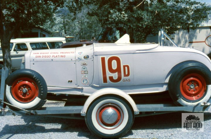

    In those days, the San Diego Roadster Club car was owned by Lou Bingham, he owned the Mobil Gas station in Bird Rock, La Jolla. No dual axle trailers were built back then, so the standard single tire trailer was the choice. This trailer had a custom touch: Note ½ tire carc*** for each Firestone Racing Tire so as not to damage it while transporting it to the drags or dry lakes. If the ½ tire carc*** was bolted to the trailer tracks, then it would also give it some protected support while transporting anywhere.

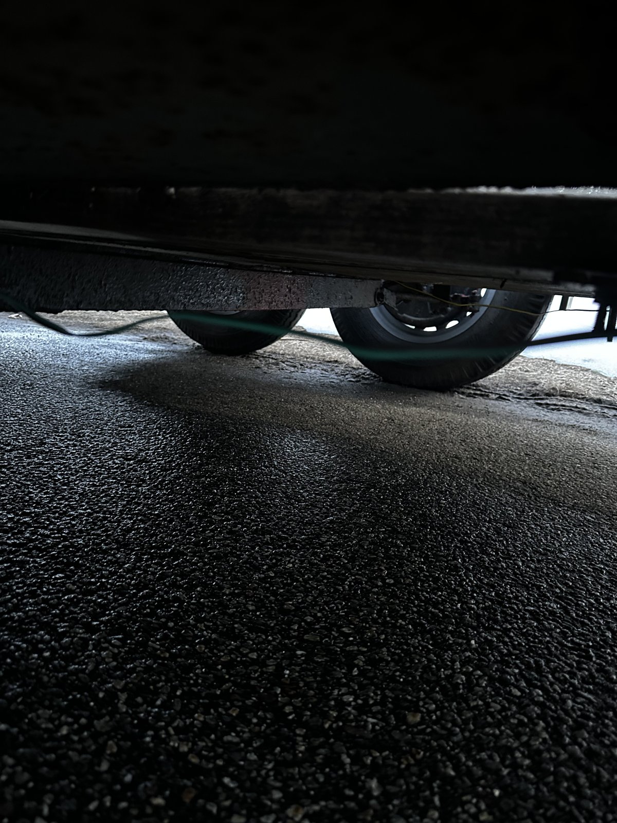

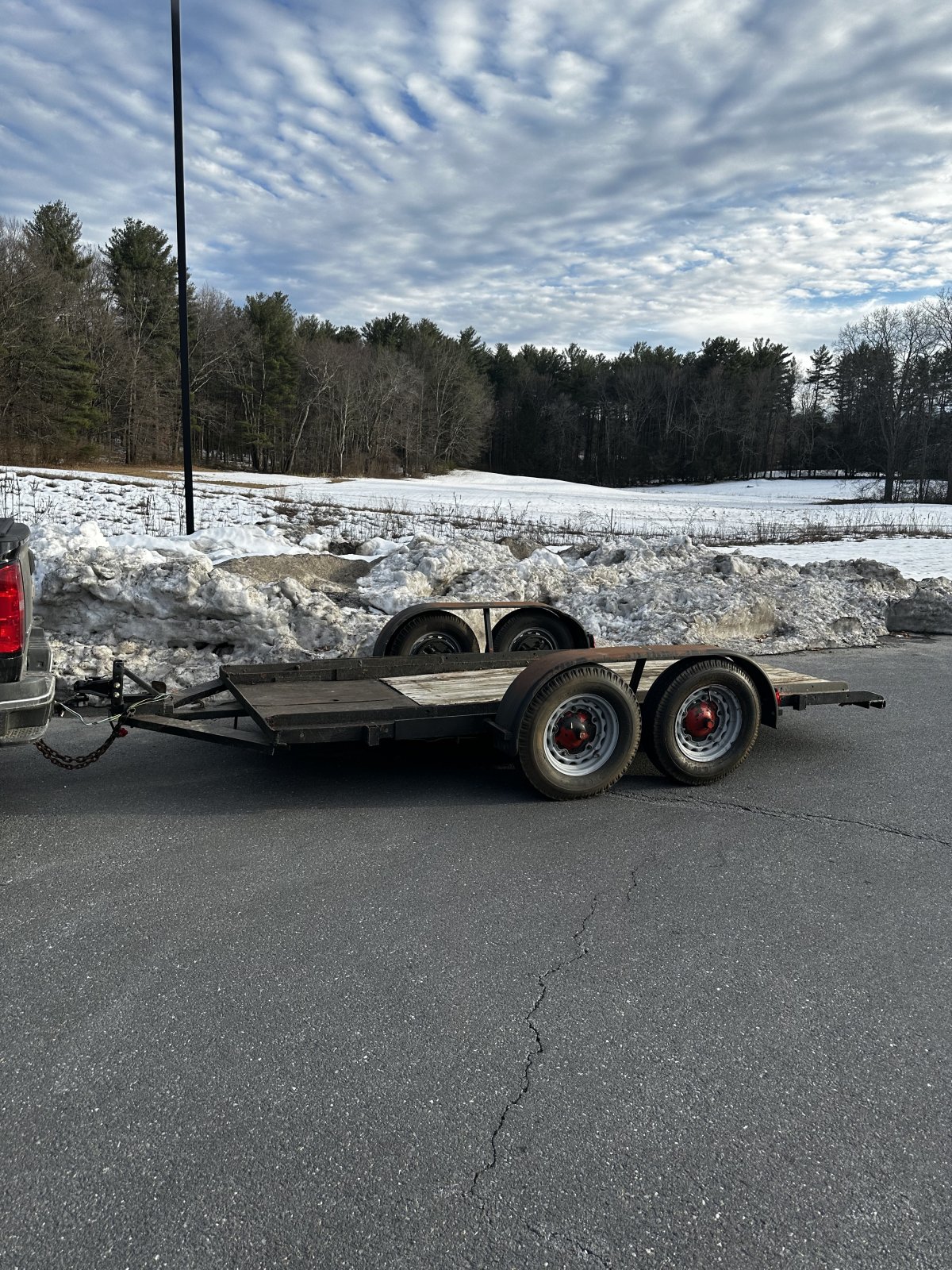

  18. 9AFDFFD2-5783-40F1-8F0C-23F0EEEB960E.jpeg 3DB7216C-90E5-45DA-B1E2-50A5CF645159.jpeg A7B9DABF-422A-4C8A-B6D9-3827C83A2EDE.jpeg I just picked up this one today definitely an old homemade job. Used 36-39 Wide 5 axles, drums and wheels. Newest tire is 1968 if I remember right. Someone cut the hitch all up for the Pintle style but towed great considering there is no suspension. I figured 68” wide and 13’ long it was built for earlier style cars 20s-40s. Of course I’d love to believe it hauled a *****in 22-34 ford but that’s just my flavor of car! May put suspension on it but will definitely be getting fixed up regardless! Old style tail lights/tires/wide five V8 caps! Will make a killer trailer for my 3 window A! 4A60B83F-C746-42A4-BD64-CEDD1EBD459D.jpeg 9EE00ED5-E06E-4F2D-974C-609CAA3EC0C8.jpeg 1D16D883-E48C-497C-824B-6798B0D9A44C.jpeg 5A3465A3-0CAF-4D08-9F75-A25AD55FC33D.jpeg
