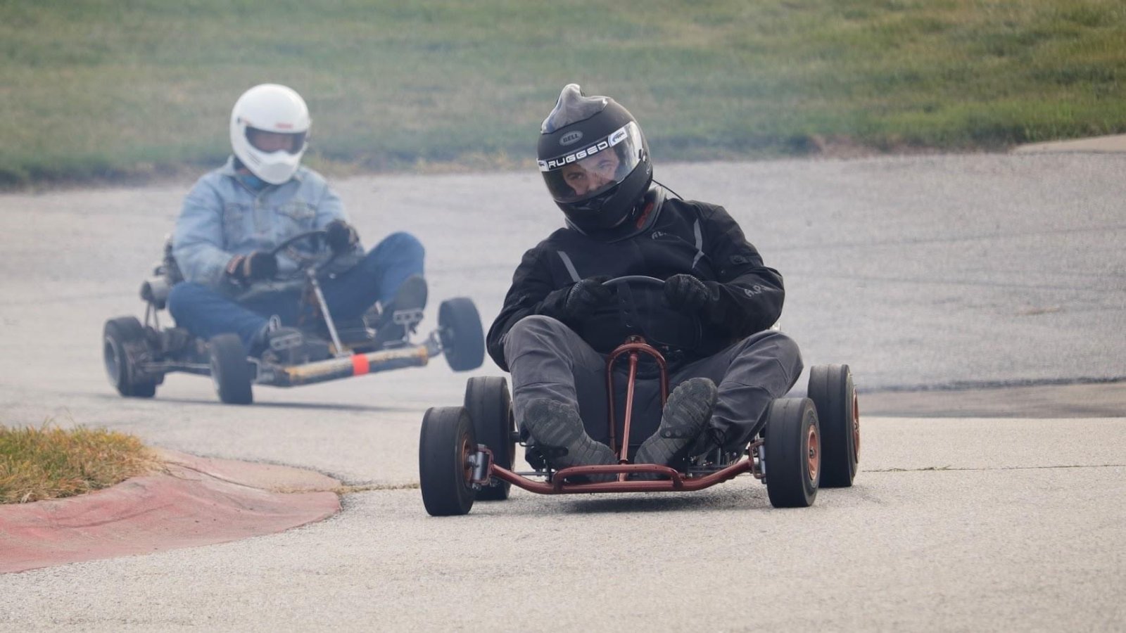

  1. It's hard to tell, but both of those carts sure display the Ackerman affect for anyone who has a hard time understanding it!

    I remember being about 15 or 16 years old when an old timer explained to me what Ackerman does and why it is important.
    Front wheels should be set up so each one is turning a slightly different radius so without setting Ackerman correctly one tire is being drag through the corner and s****ing off speed.
    I am 76 but when my two boy's back in 1984 wanted to start racing karts with the WKA ***ociation I was explaining to them what rolling residence was and how to correct some problems that effect it.
    Getting the toe-in set correctly was also very important and when I used to see new kart racers going down a straightaway with he kart darting back and forth I told him to bring is kart over to my shop and I would fix for Free.

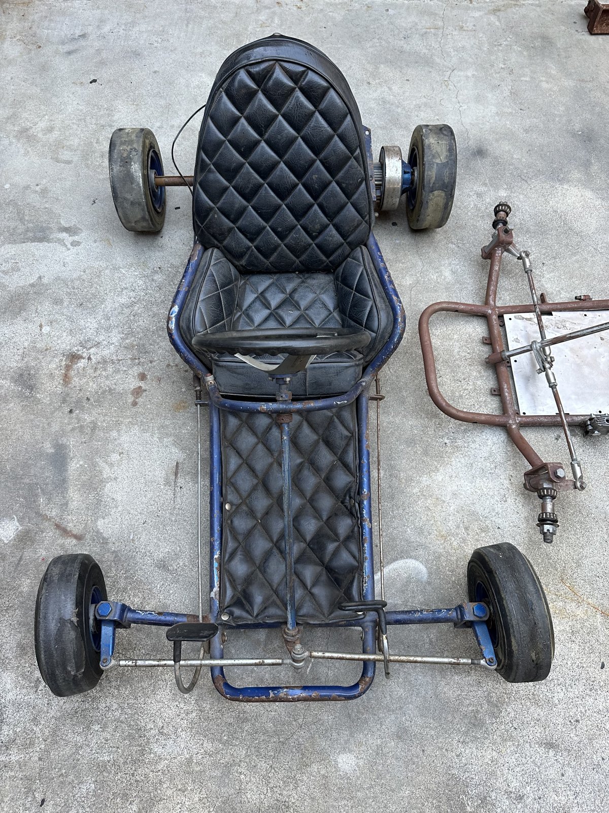

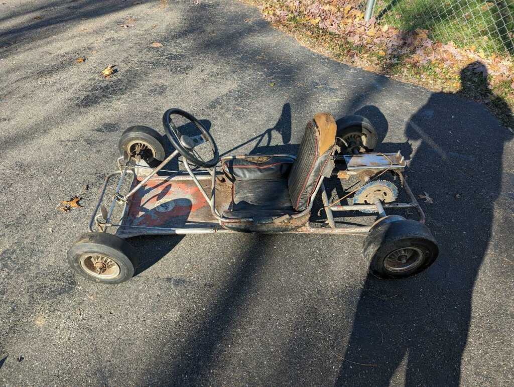

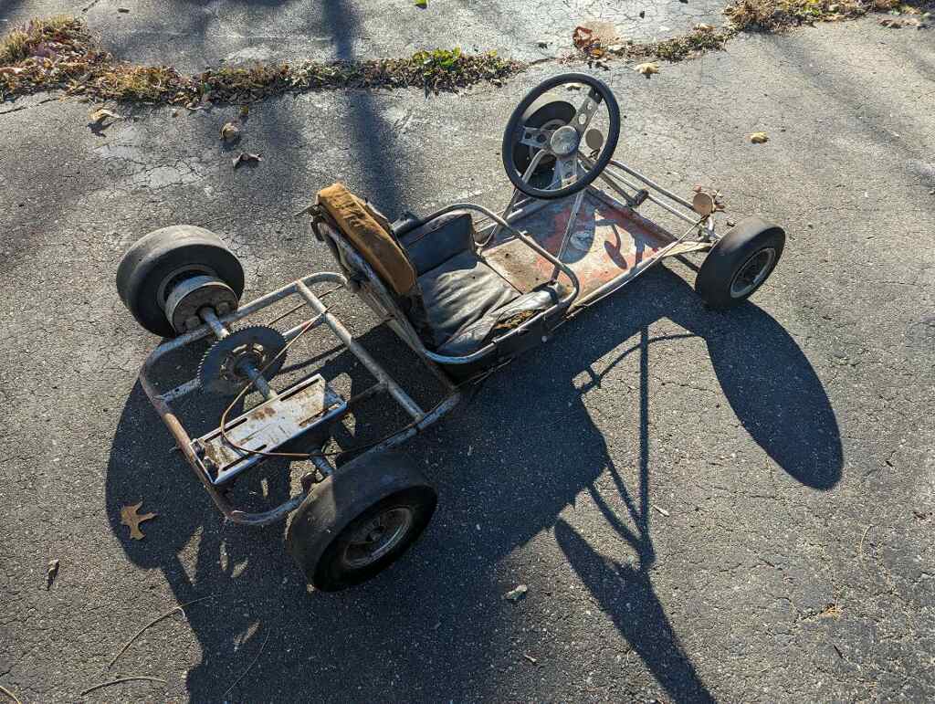

    Hello, I am looking for some help identifying this kart I picked up Wednesday. I'm thinking Rupp Dart, but there are differences in photos I see online. Any help would be greatly appreciated. Great thread. Thanks, Kevin

    It’s got Rupp turbine wheels but nothing else I recognize. I restored this on during the Covid scare. IMG_3573.jpeg

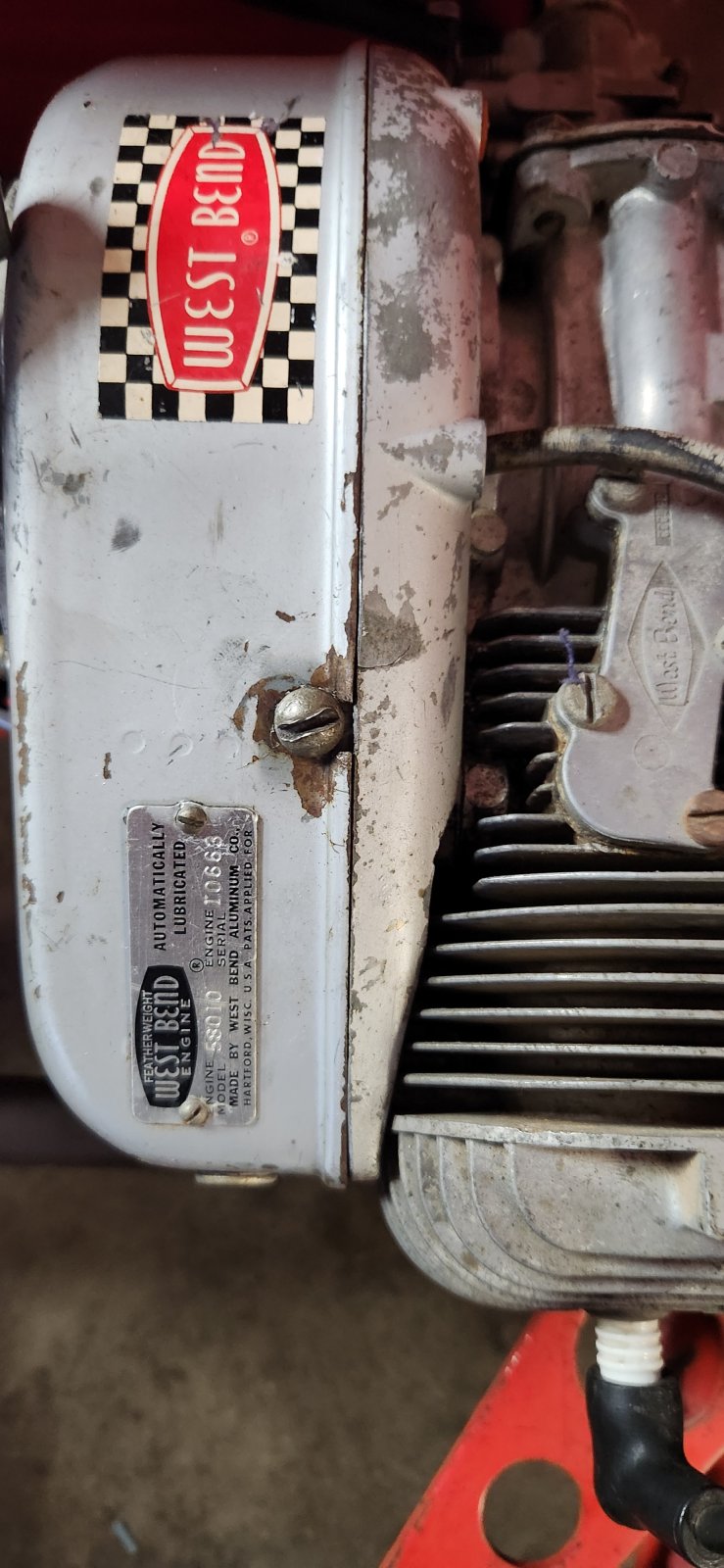

    IMG_4700.jpeg IMG_4136.jpeg IMG_4137.jpeg Just finished this 1961 Fox West Bend 820 engine in September

    The trailing cart in the first photo is defying the laws of physics.
    How does one accomplish this Joey Chitwood type of move?
    Inquiring minds would like to know.
    Photo shop? Nice photo though.
    Bill

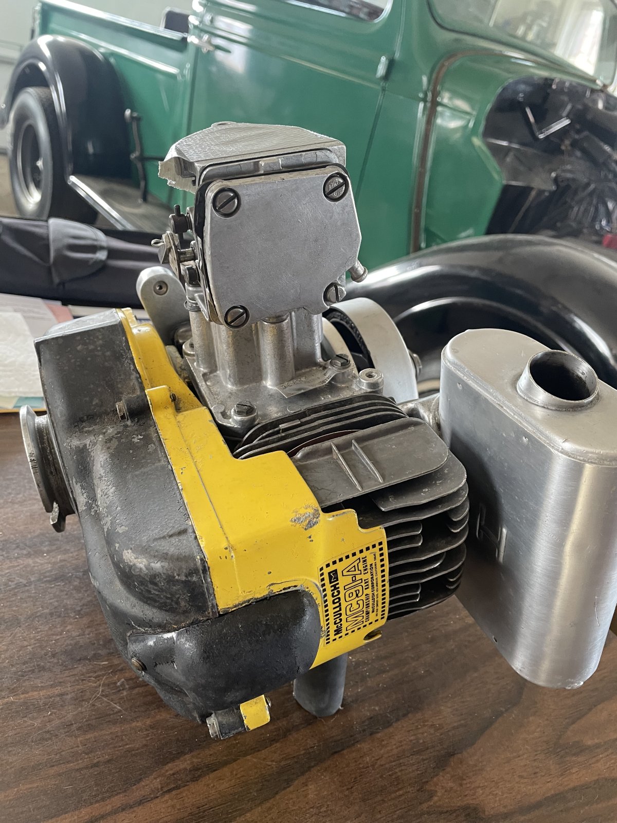

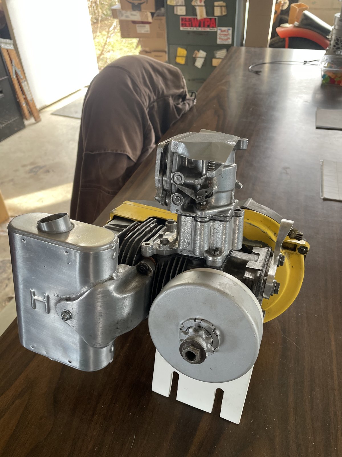

    A small update, the Mac is back! Where I left off, I entrusted my engine to go kart expert and racer Kent and his machinist buddy Mike. They went all through her with new crank bearings , rings and, gaskets. Carb is now all new internally. I will probably wait till spring, to put her back on ; and get it running. D9E57B93-9B80-47BA-A1AD-85BABC7D2997.jpeg 5C2F5360-E3B8-4C52-BB2A-8C9FCEFF324B.jpeg

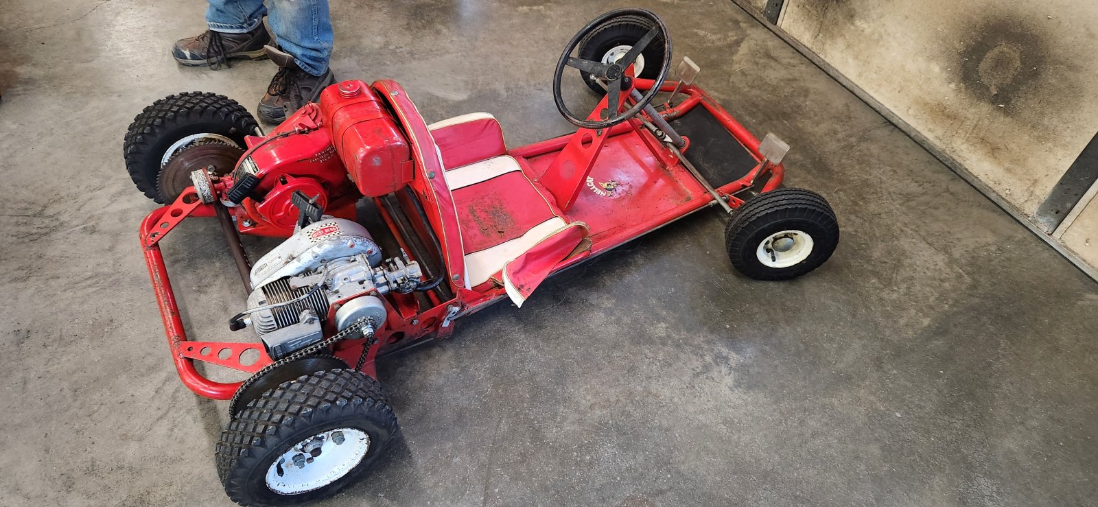

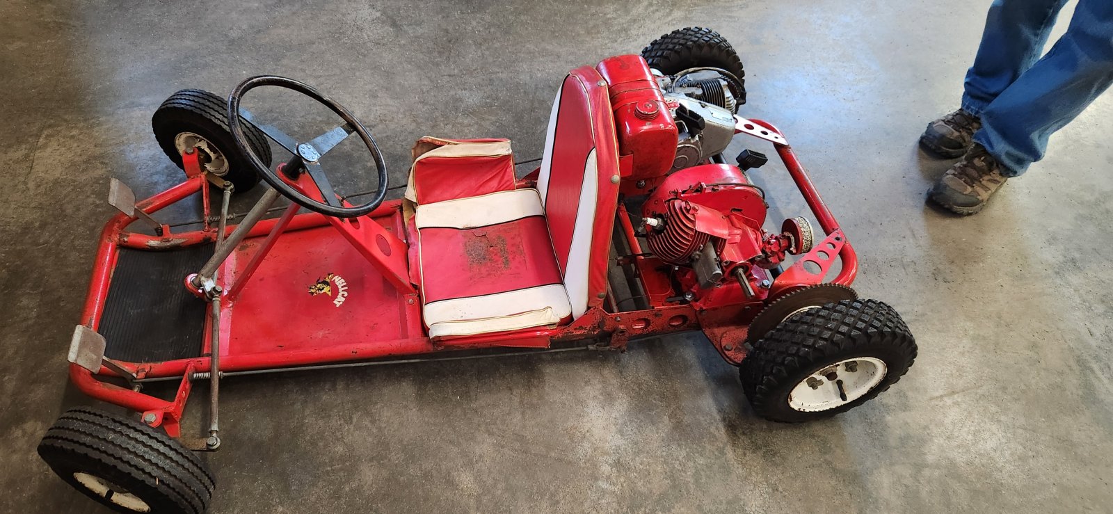

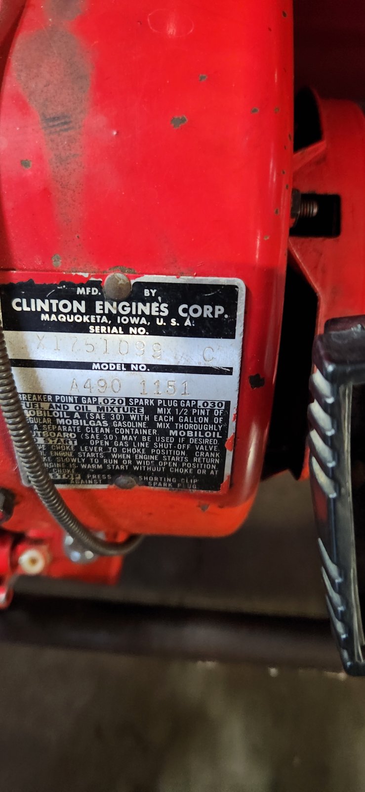

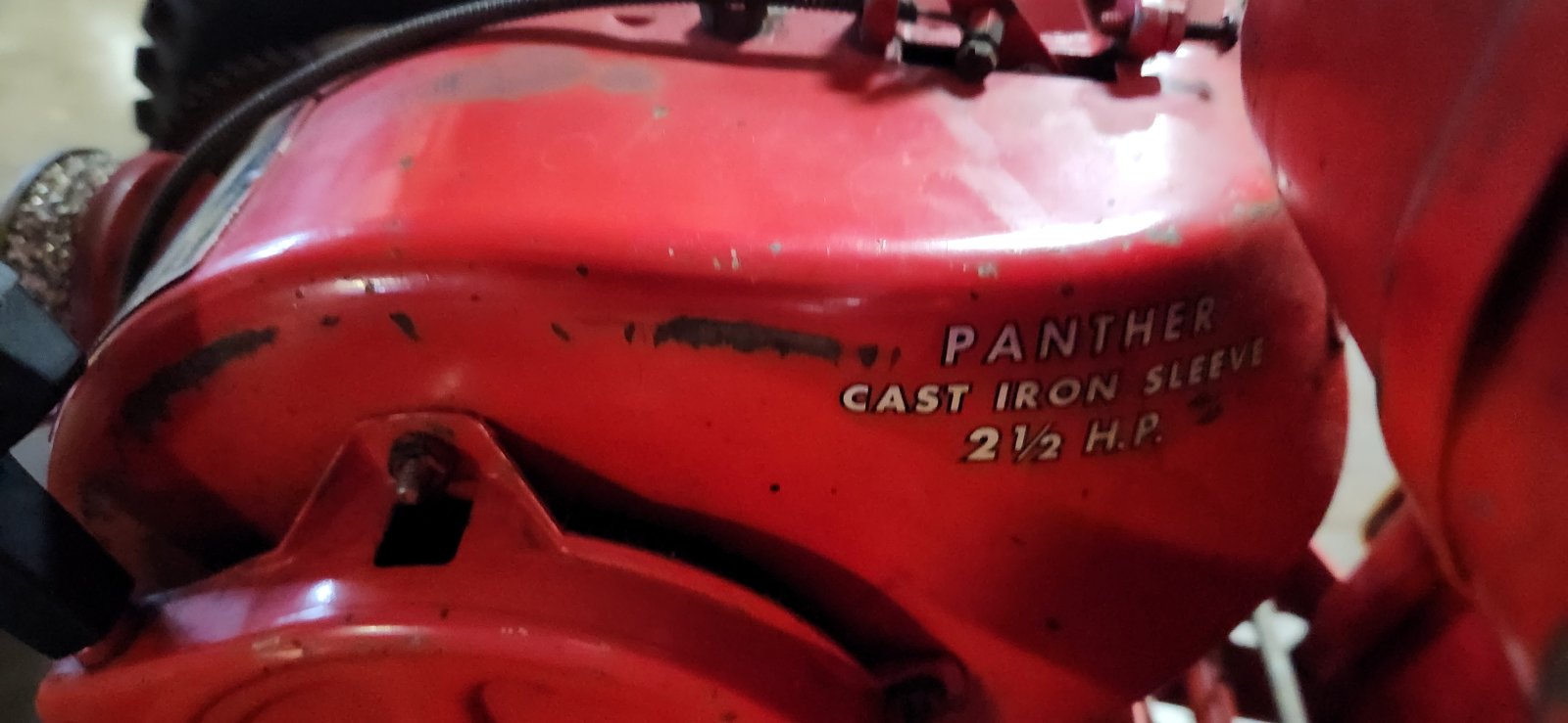

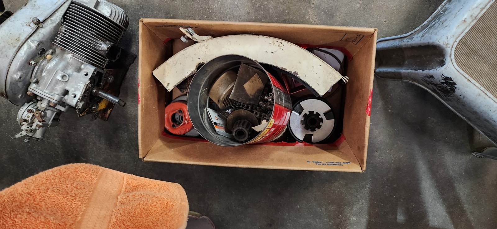

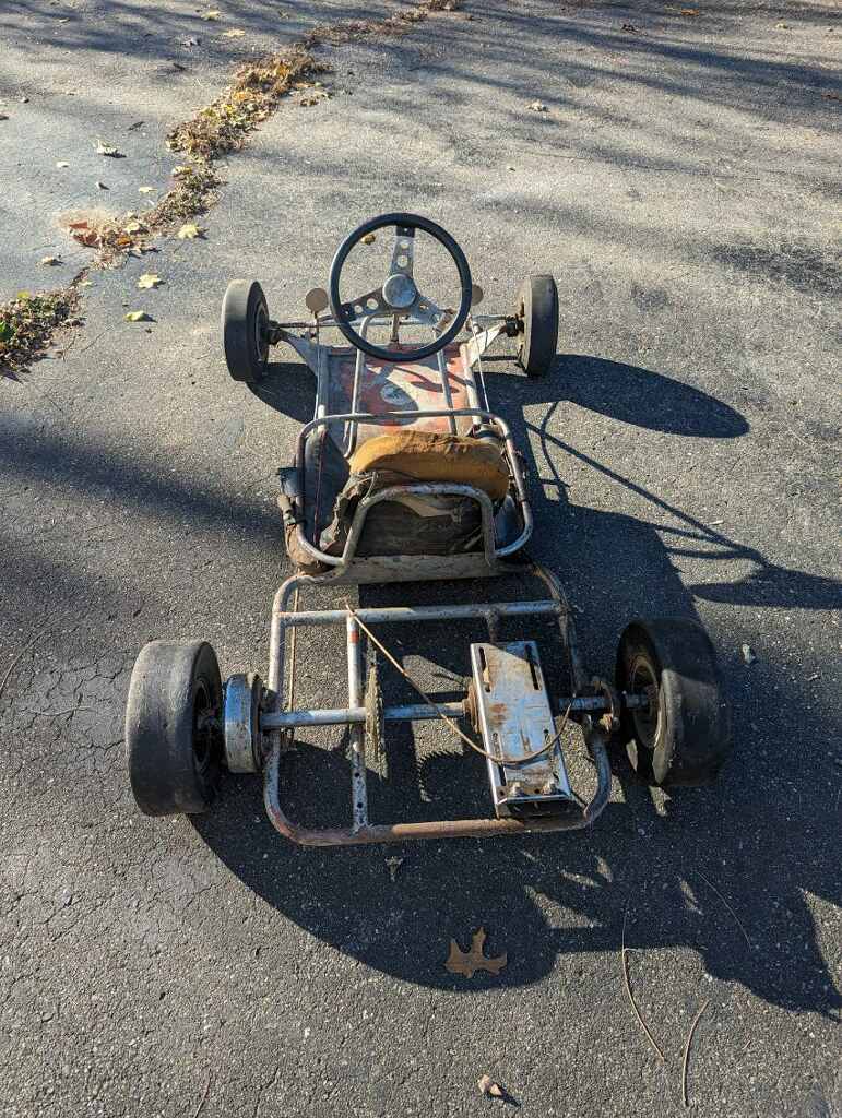

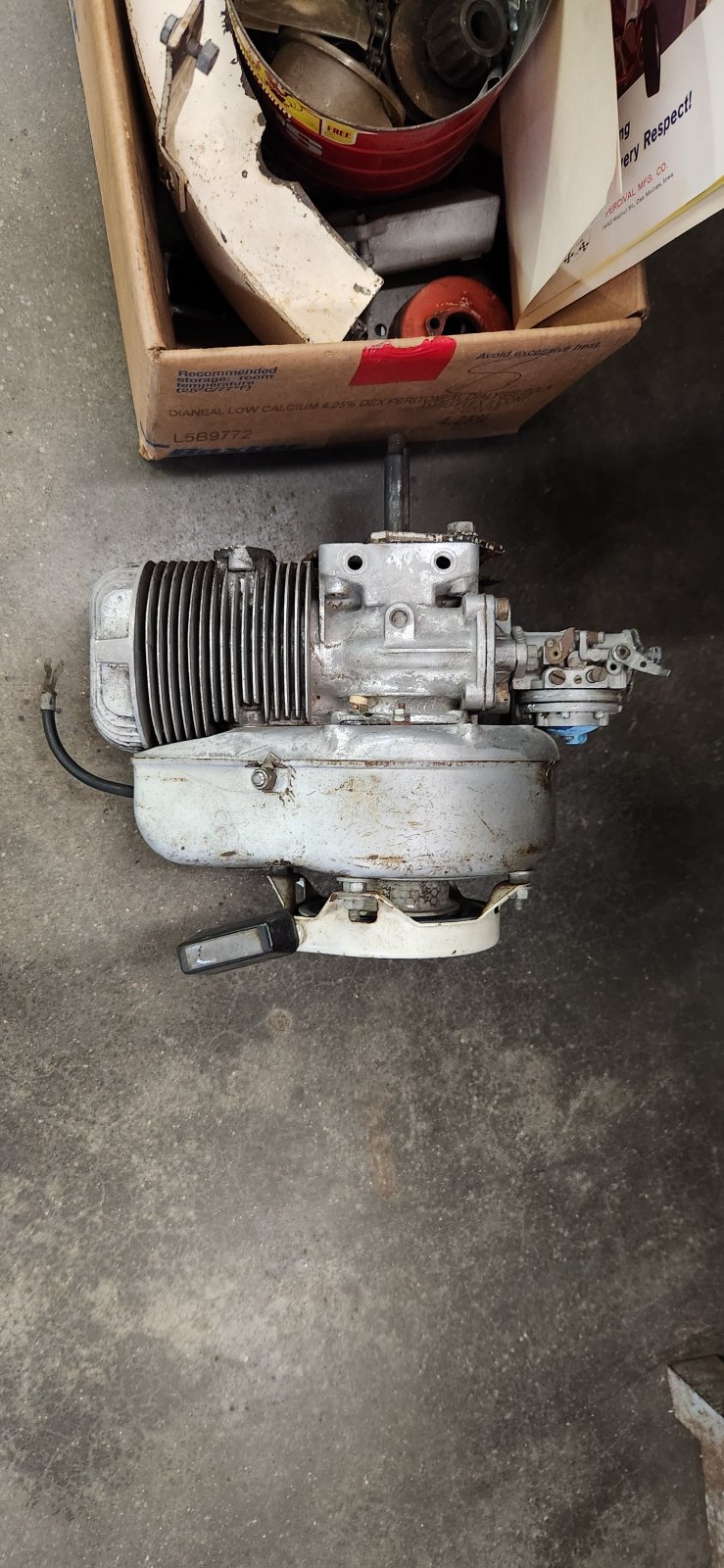

    Bought this today. Bought it off the original owner. Percival Hellcat. Bought in Jan 1961. Came with original paperwork, parts lists and brochures.
    He said it came originally with the Clinton engine. His dad bought the West Bend that's on it now. There was a model with two West Bends so he bought another to put on it but said he no longer has any interest. He asked to hear it running again if we get it running.
    20240219_174636.jpg 20240219_174649.jpg 20240219_174710.jpg 20240219_174742.jpg 20240219_174810.jpg 20240219_174814.jpg 20240219_174820.jpg

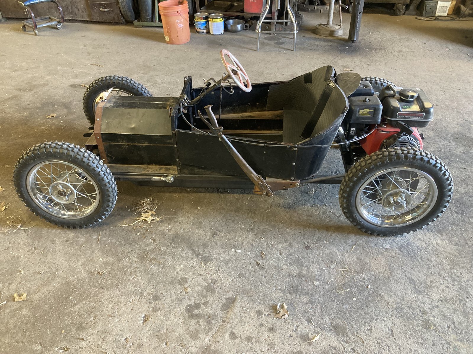

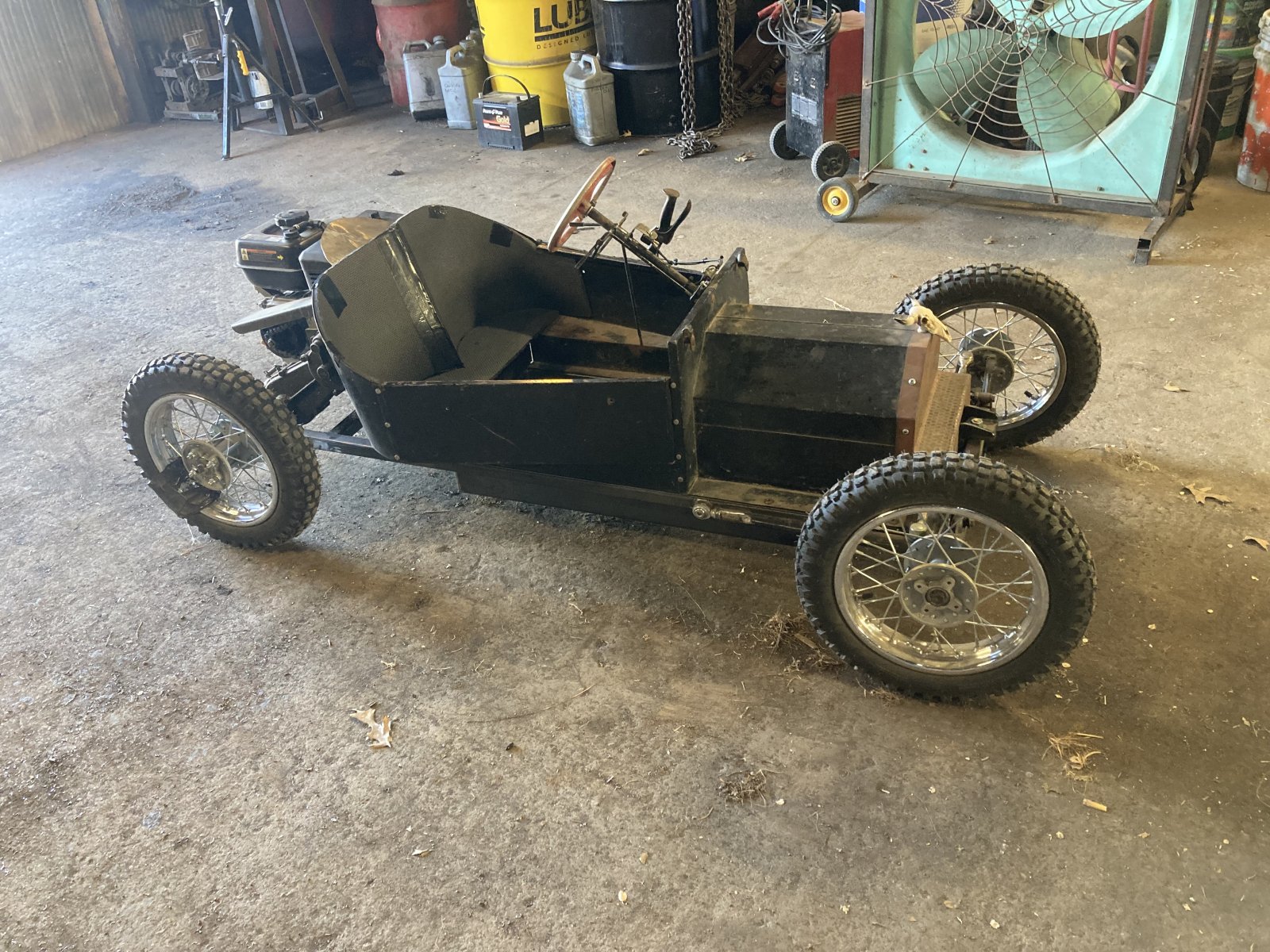

    IMG_8843.jpeg IMG_8842.jpeg Here’s a Tin Lizzie that I modified. I had gotten the original Briggs engine running but couldn’t get it to idle. So I got a predator engine. The wooden spoke wheels were in bad shape. I replaced them with mini bike tires/wheels off eBay. A Friend that works in a machine shop made the rear hubs and drilled the bolt pattern in the rear wheels. The brake is off a HD golf cart . The brake lever is out of an early 70’s Ford truck . The radius rods are early 60’s Chevy truck parking brake levers . I built the frame .
    Delete if this doesn’t fit .

    It fits! Looks like a little hot rod to me.....:cool:;)

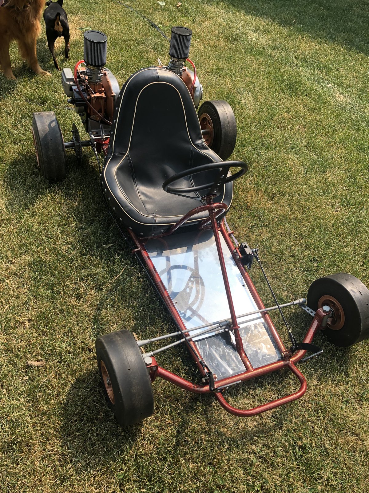

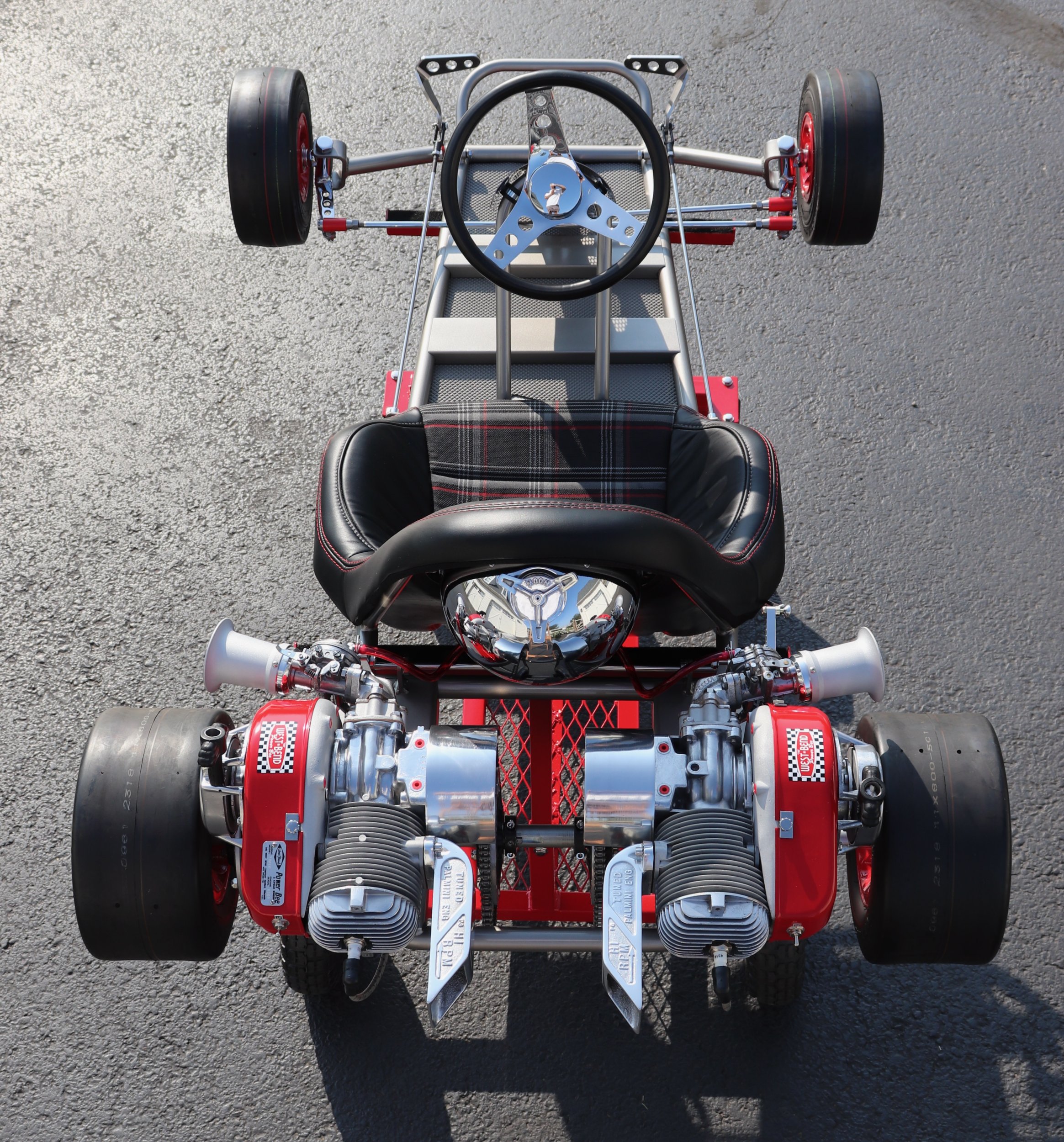

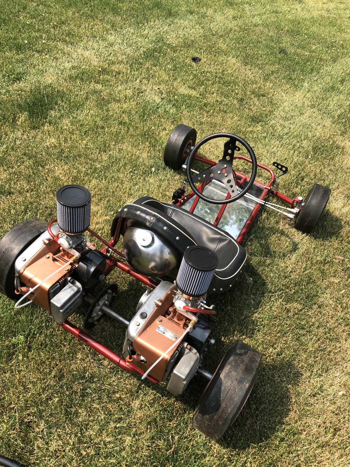

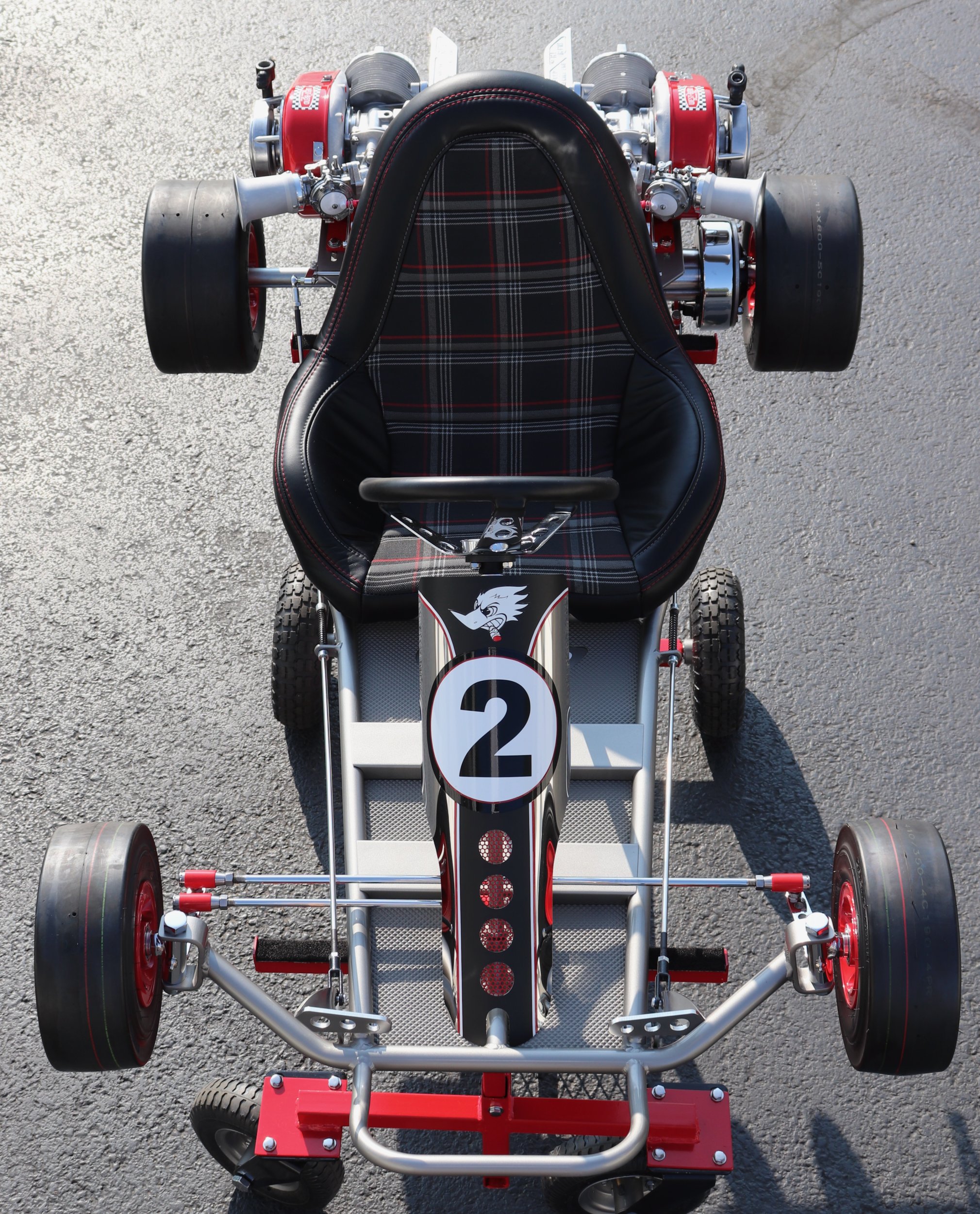

    It's been a year since the last post so I'm going to try and start up again. This is one of many vintage twin engine karts I've restored. This is a 61 Fox with dual 2 stroke West Bend 700 engines.
