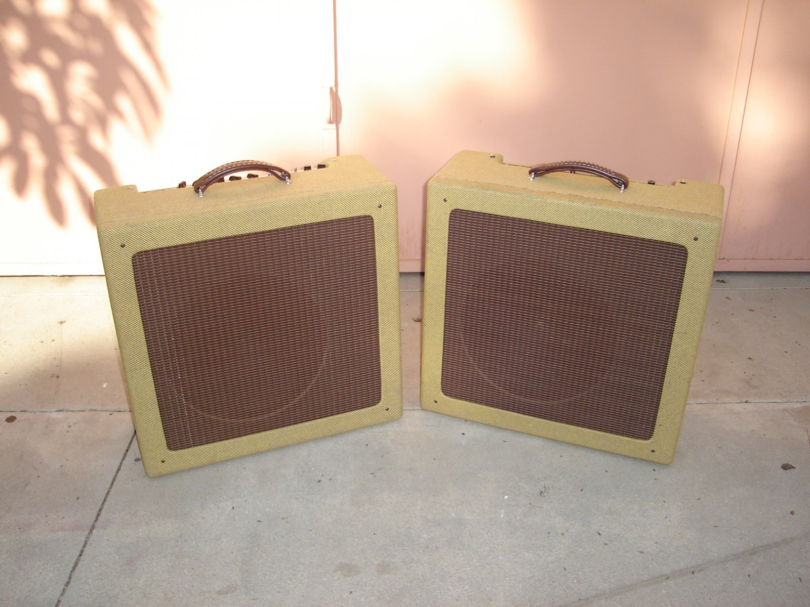

    Here's a couple of amps I built. 1 is kind of a copy of a Fender 5E7 tweed Pro, the cabinet is a little larger than a real Pro, and the TV style front is not accurate, but electrically it's pretty much spot on with just a couple of modifications (like a master volume). The other is my own circuit design loosely based on a Fender 5E3 tweed Deluxe. I'll post more about both later.

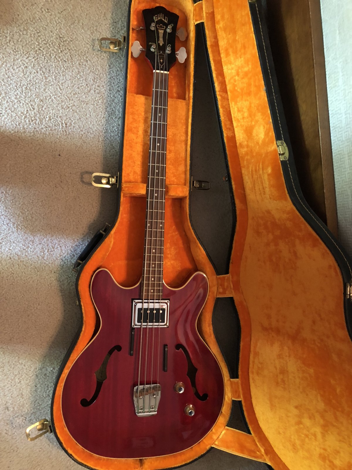

    '67 Guild Starfire. I swear it was purchased, stuck in the case, and never saw daylight again. Not a scratch on it.

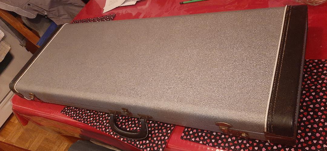

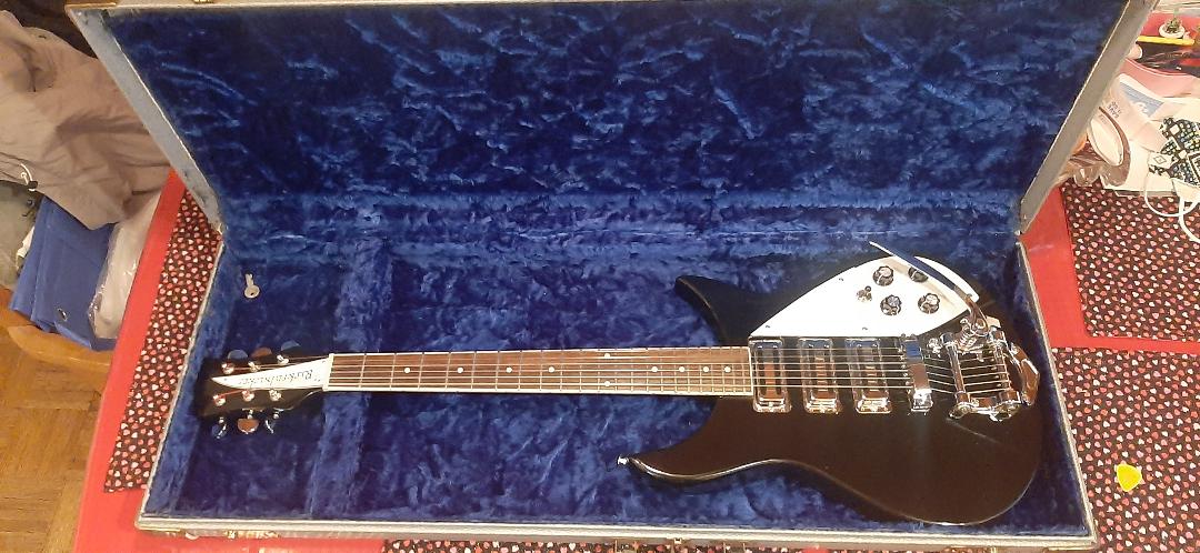

  8. ... Just got lucky as hell and found a vintage case that was made for my Rickenbacker ... and it fits perfectly! ...

    Dam you did get lucky, that case looks like new! Nice old Rickenbacker too.

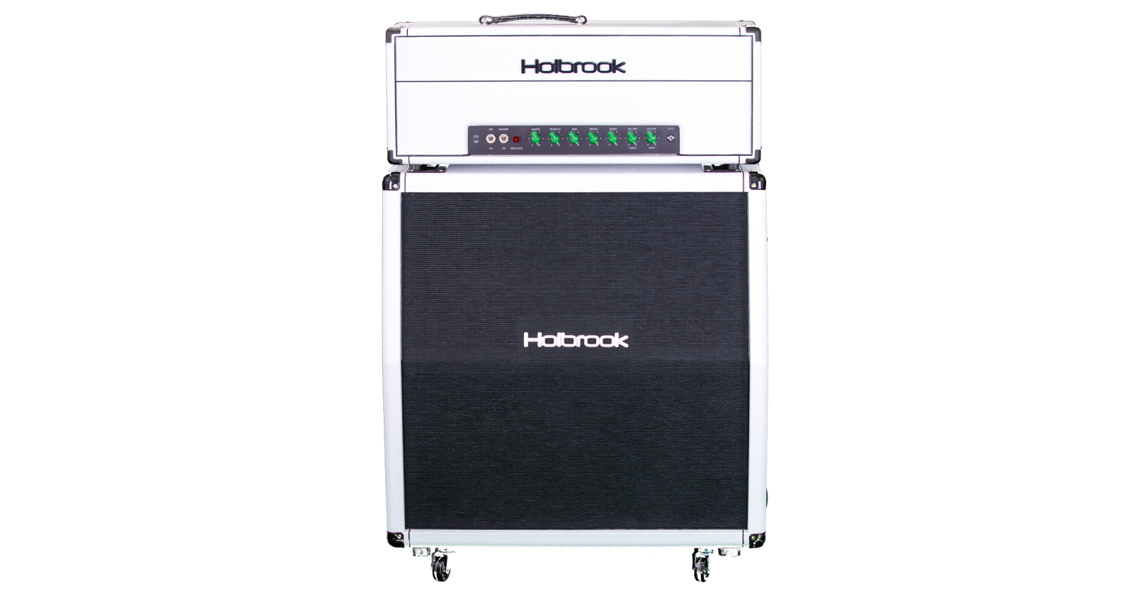

    I'm not musically inclined whatsoever, but I've got a good friend who makes tube amps. He has some gorgeous builds. This stack he built belongs to Jeremy Von Epp. He's been chasing tone for a LONG time, and has done a great job of building bespoke amps and guitars for many musicians. His amps do have a nice vintage look, and from what I've heard personally, he's onto something...they sound awesome!

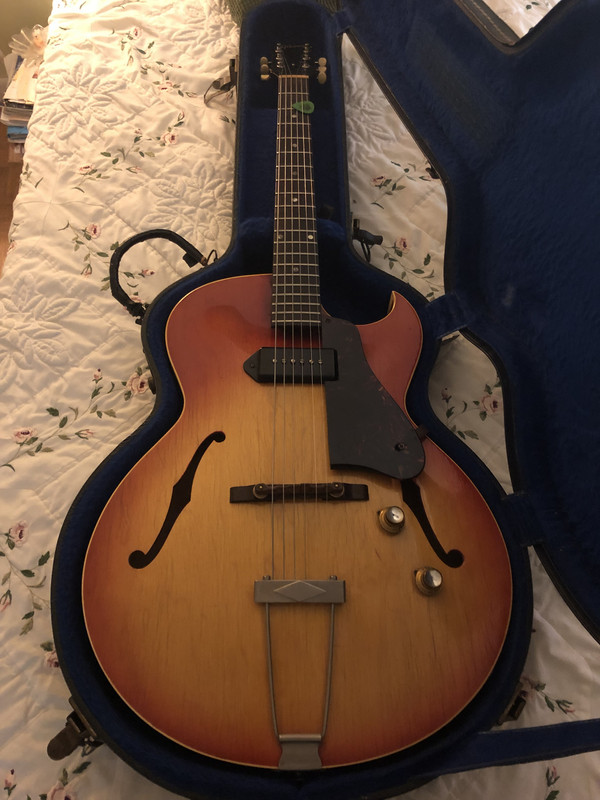

    I digress, back to the geetars, here's my '65 ES-125TC jazz box-

    Love the ES125!

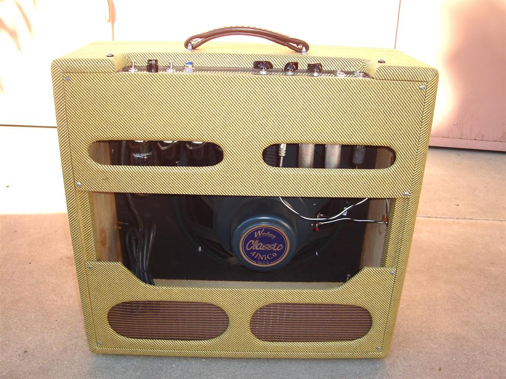

    I posted earlier that I would add photos of the tweed amps I built. So here's the first one, which is an amp of my own design based on the Fender 5E3 Deluxe from '59. But mine is powered with a pair of 6V6 tubes, plus a pair of 6L6 tubes (I originally set it up for 4 x 6v6's, but I ended up changing out 1 pair of those for 6L6GC's). Also, the preamp uses a 6AU6 pentode for one channel, a nd a 12AX7 for the other. You can use either one, or both and blend the two together to your choice using the Volume controls. The Tone control effects both channels. The speaker is a 15" Weber 15A150, about as close to an old Jensen P15N as you can get. I have a lot of amps, but this one here is probably my favorite and the best sounding amp I've ever played through, simply amazing.
    Here it is when it was first completed, all fresh and new.

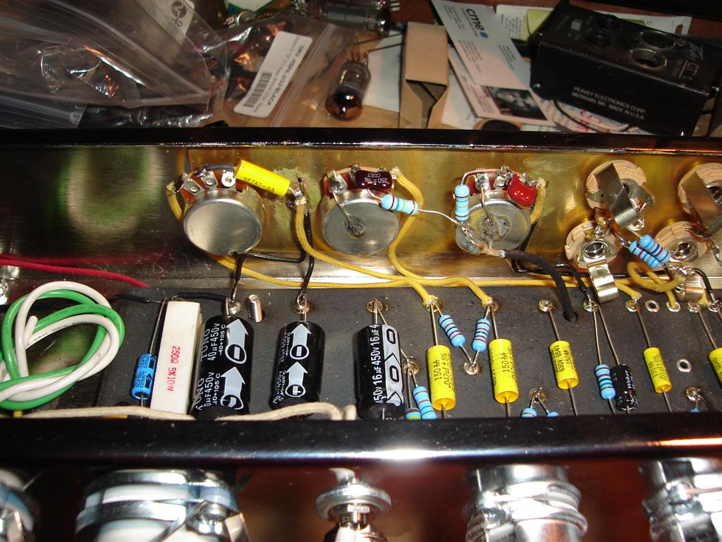

    All hand wired, JJ's 6V6S & TAD 6L6GC-STR power tubes, and an old 5U4 rectifier I [icked up somewhere.
    Cloth covered wires. I love working with them. The switch allows me to turn off the 6L6 power tubes for "half power" for smaller venues.

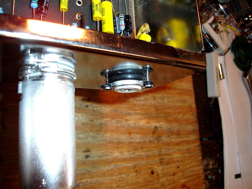

    I cushioned the socket for the 6AU6 with orings, to reduce vibrations from rattling the grids. Pentode tubes tend to be susceptible to microphonics, vibrations can cause them to be noisy. I wenth through a bunch of tubes to find a low noise tube, and I've had to replace it a couple of times because even a god tube can become microphonic over time due to the vibrations from the speaker. Good thing they're cheap, I have a large stash of them, some given to me for free. I have a few amps that use these tubes, I love them. Much higher gain than the typical 12AX7 triode used in guitar amps, with a wider band width.

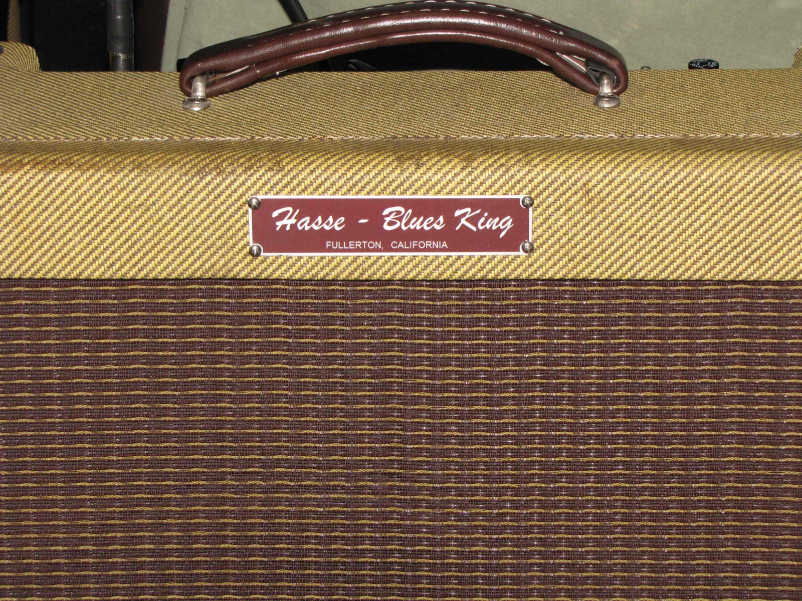

    Here's the tag I came up with, trying to emulate the style of the old tweed Fenders.

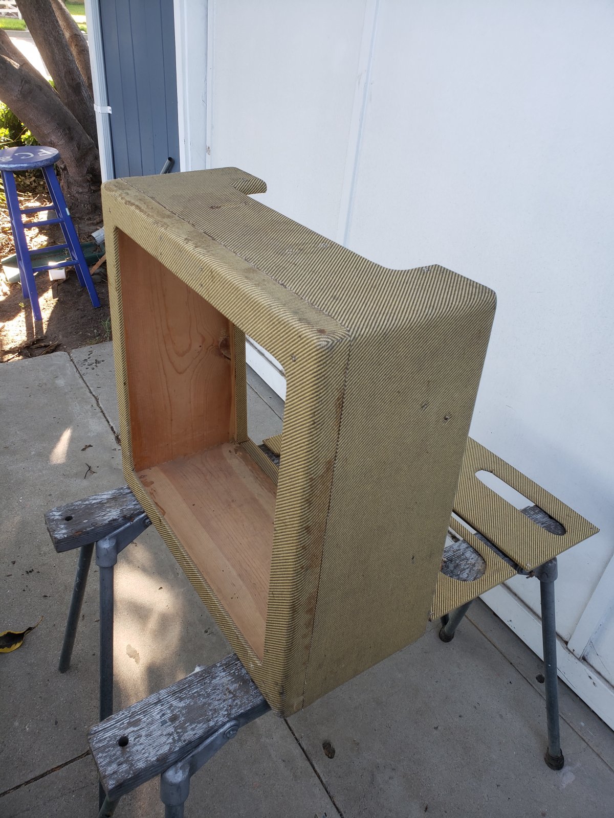

    After more than a few years of using the amp on countless gigs and jams it started looking really rough. I had left the tweed bare, natural, because I thought I mistakenly thought that's what Fender did back in the 50's. I was wrong, and over time it started looking really crappy.
    So I stripped it down to lacquer it. Here is the bare cabinet getting ready to apply the lacquer. Actually, I didn't use lacquer, I used polyurethane, Minwax PolyShades Honey Pine to be exact.
