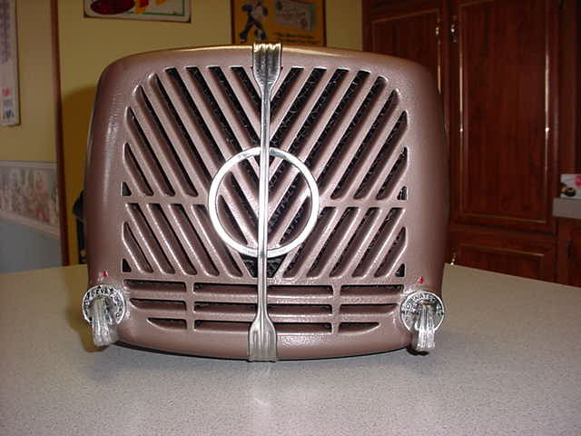

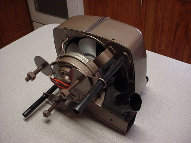

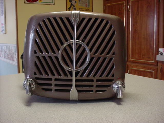

    Here's my Chrysler model 21, just finished it, gl*** beaded, primed, painted, pressure checked, new 12 volt motor, now all I need is a decent cab and I'm all set. My 32 cab is a bit rough, so I'll keep looking for a 32 - 34 that's better.

    I have this same one. Yours is the only other I've seen.
    On mine the center division bar is a little bent, but I think it is potmetal so I'm afraid to try to straighten it.
    The little winged emblem says Francisco (or Franciscan- I can't remember which.)

    johnnymac1
    I used a Four Seasons 35576 in my Chrysler model 21, it's rev rotation, 3 inch dia, just over 3 inches long with 1/4 inch shaft, CARQUEST 208910 for $28.00 got a resistor and switch off the Bay for an old International truck for my 3 speeds, a real cinch to wire up too. Have fun,
