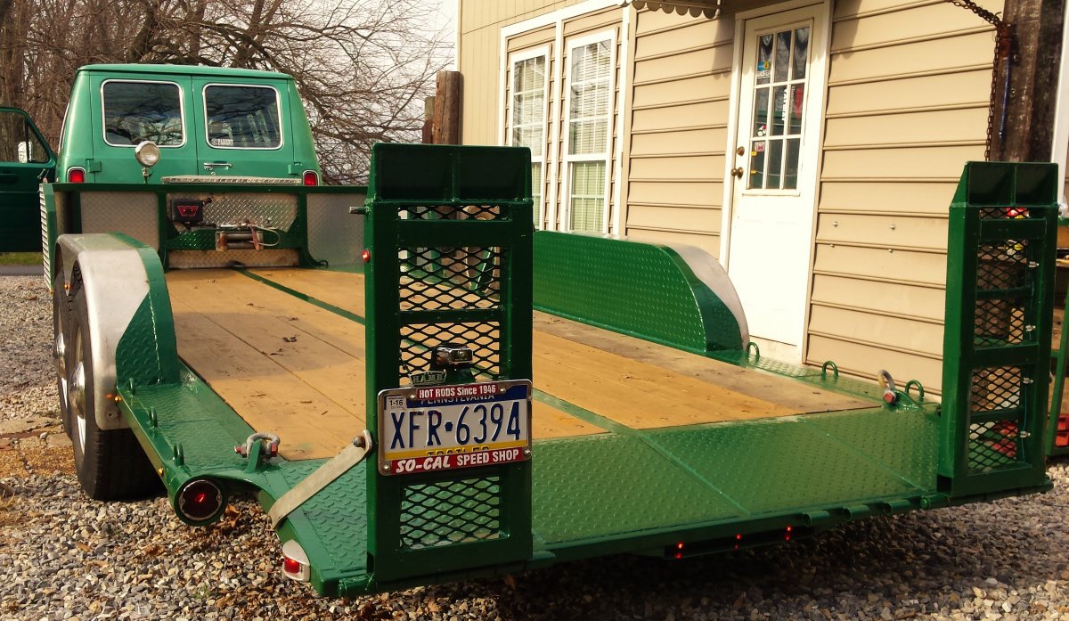

    '52 F3 - Good trick, hiding the tail lights in a shroud. That ought to keep them from getting rubbed off!

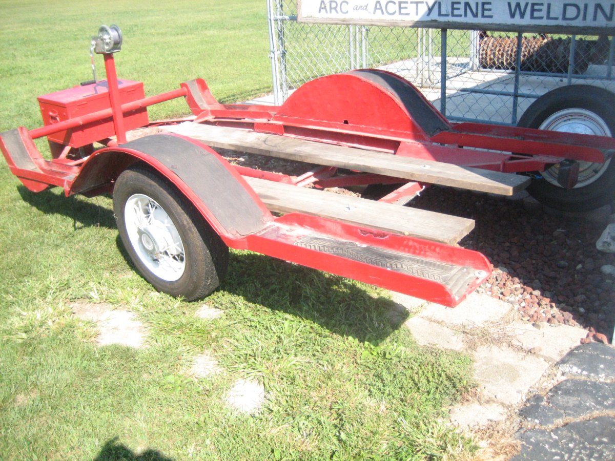

    Those are Auburn knock off wheels on that red trailer. They are valuable on Auburns and terribly unsafe for a trailer.

    just curious, are you talking about my trailer picture?

    no, there was another post that was deleted. Sorry for the confusion.
