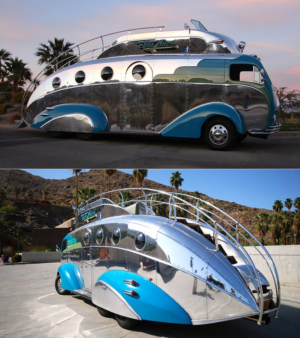

    go fo it !! I think the blastoline rv was built out of a white garbage truck !
  3. ^^^ That's a LOT of ****ing alueminnyum to keep polished!!!

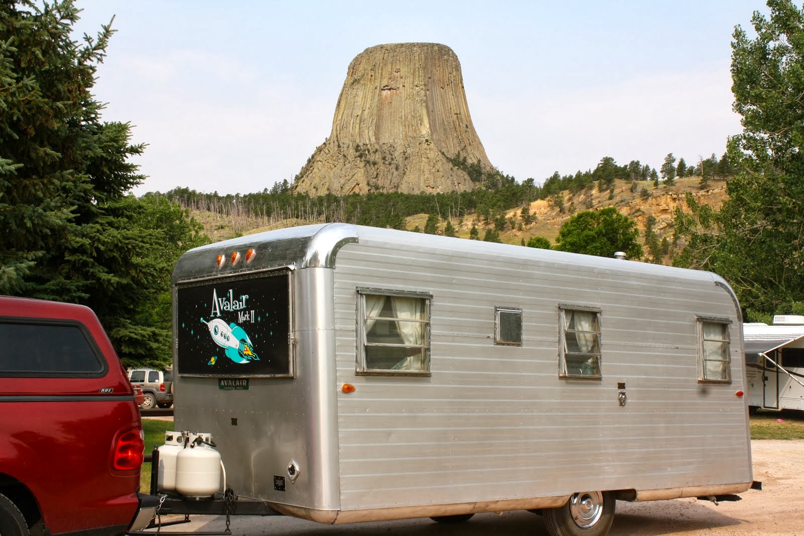

    I have been RVing for 30+ years. This is my current trailer. Took about a year to restore. We have probably 15k miles on it now.

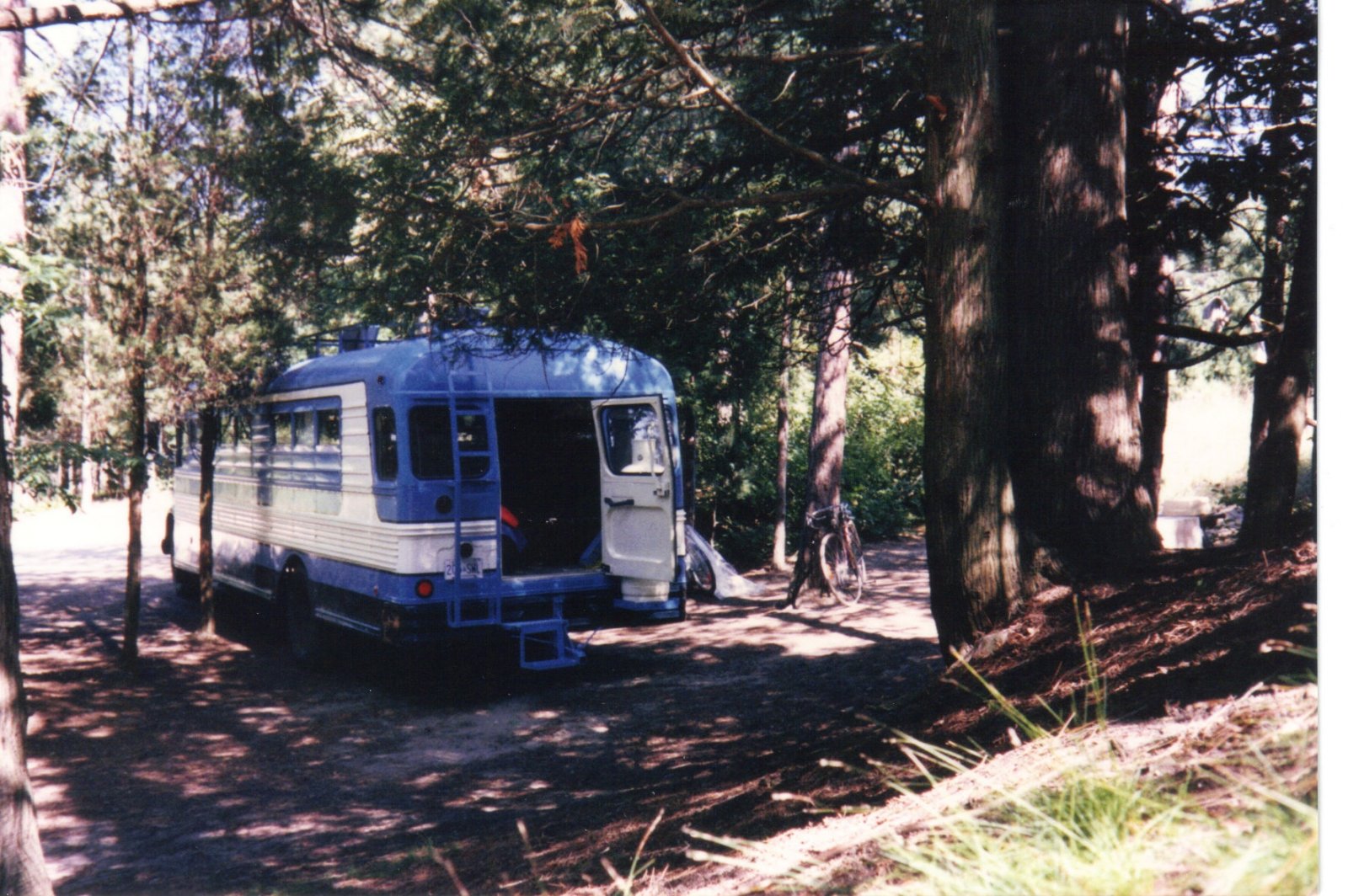

    I built this one in the early '80s from a GMC ch***is, BlueBird body , a 300 cu in inline 6, mated to a 4 speed saginaw. Paid s**** price for the bus, bought the engine off the shelf, NOS from the GM dealership for the "want it gone" price of $400. A month later, drove it over 3500 miles on the first trip out. Used up old fleet truck paint, scavenged steel. Used it for going to the races, fishing, hunting, camping and cross country vacations. Usually had a canoe on the roof and pulled a 4X4 behind it or had off road machines inside. It had a creeper gear and would also cruise at 70 mph all day long. It had 4-30 gal fuel tanks. We even built a 20' X 12' add a room with greenhouse hoops for the longer stays.
    Nothing fancy, but we had a blast with it. bus 1.jpg bus 4.jpg bus3.jpg bus5.jpg

    In an attempt at weight savings, I built angle iron frames with vinyl coated chain link fencing, covered with foam for the 6 fold up beds in the back. They were very comfortable but you couldn't sleep on one while moving. The wind would get ****ed out of your lungs with every bump in the road. LOL
    You can do a lot to an old school bus. We had a full kitchen with a stove, oven, fridge and a full size barbecue that was modified for easy fold-up storage when not used, a simple bathroom stall, tables that sat 8, a 45 gal. water reservoir with hand pump, a double sink, a vented propane heater, captains chairs for the driver and co-pilot, an air compressor pump fitted to the engine to operate air tools or whatever, a sound system, CB radio , auxiliary battery with isolator.
    The 20' voyager square back, cargo canoe took two to get up onto the roof and the 4 HP Chrysler motor clamped on the ladder. By folding up the lower beds there was room for 3 off road machines. A few had to have some wheels removed to fit in the door.
    It didn't have air conditioning but we never missed it.
    I do miss the old bus though. After the kids were all married I just had too many vehicles, boats, motorcycles etc. Some things had to go.
