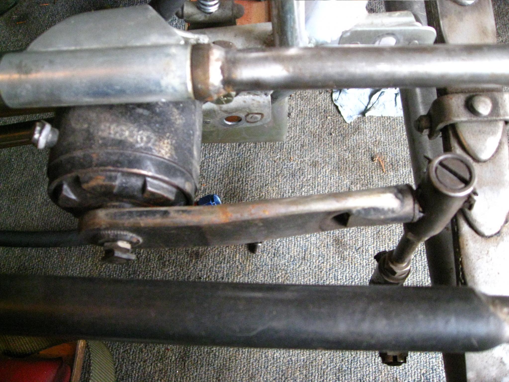

    I need a little help from you guys.
    Regarding building front nerf bumpers, how do they attach to the frame stand (as seen in the picture below)? Is there shaft from the bumper that goes into that short tube, then locked in with set screws from the side???
  2. 28dreyer
    Joined: Jan 23, 2008
    Posts: 1,166
    28dreyer
    from Minnesota
    The shaft is the continuation of the bottom hoop through the mount on the frame which is tubing into which the hoop slides. You will need to provide a shouder for the tube to **** to the mount. The end of the tube is best filled with a welded spud and drilled and tapped for a 5/16 or 3/8 cap screw and washer as under some conditions you may be pulling the car by the bumper.

    Thanks for the nerf bumper advise. I understand your description too. I usually have a knack for figuring this stuff out in my head. But I wanted a pro to back it up.
    I just don't get to see these cars on a regular basis, and never seen one apart (in person).

    One of three I tried, not the best one.
    This is a top view, the receiver tube for the bumper is part of a triangulated shock mount welded to the main frame tube which is totally hidden behind the bumper tube. You can see the Dzus tabs which are also welded to the frame.
  6. AJofHollywood
    Joined: Oct 3, 2008
    Posts: 641
    AJofHollywood
    Nice, compact design. I see the shoulder you mentioned earlier. It has to be on there pretty tight, and use heavy duty hardware to stay together after contact with another car.

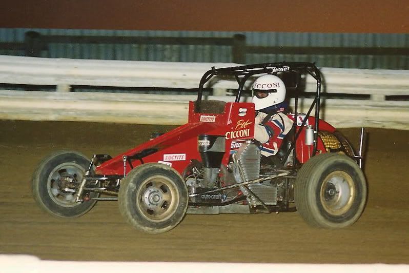

    Bob Cicconi at Williams Grove Speedway 1989! enjoy! :D
  19. indybigjohn
    Joined: May 22, 2008
    Posts: 1,713
    indybigjohn
    Great photo of Bob! Merry Christmas and Happy New Year to all.
