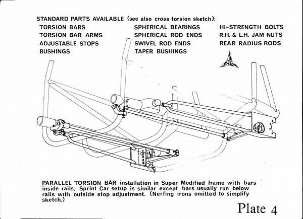

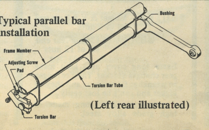

    Enlarging the thumbnail clearly shows the rear torsion bar mounted outboard of the frame and body unlike original Kurtis. I am presuming the car was changed over from originally being either a cross spring or a quarter elliptical rear.
    Can any one expound on variations of parallel torsion bar upgrades and who was prominently doing them and/or if kits were offered?
  6. Rootie Kazoootie
    Joined: Nov 27, 2006
    Posts: 8,130
    Rootie Kazoootie
    from Colorado
    Both Halibrand and CAE offered parrallel setups and I'm sure most others did also. Theirs used conventional bars but another setup used bars where the arm and adjuster were on the same end with the arm floating and the adjuster turned down on the arm.

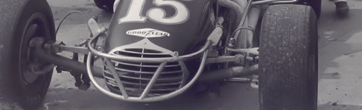

    .....'Hey! Of all people to chime in, thank you, mac miller! I've always noticed that back in the day, whenever Wally and later Paul Leffler would build their sprint cars with parallel bars on the front, the bars were always mounted 'above' the front axle. Whereas, two well known midget car builders, George Benson and L. T. "Red" Caruthers and even Mike Fedorcek's "Munchkin," their bars were always mounted 'below' the front axle. Since you are our resident expert, what do you think was behind their way of thinking??? I know those little LTC cars were very successful, but how can you argue with the sprint car design of the man that built the Sheraton-Thompson Special dirt cars???
  12. Rootie Kazoootie
    Posts: 8,130
    Rootie Kazoootie
    from Colorado
    Meskowski's was a leaf spring conversion.

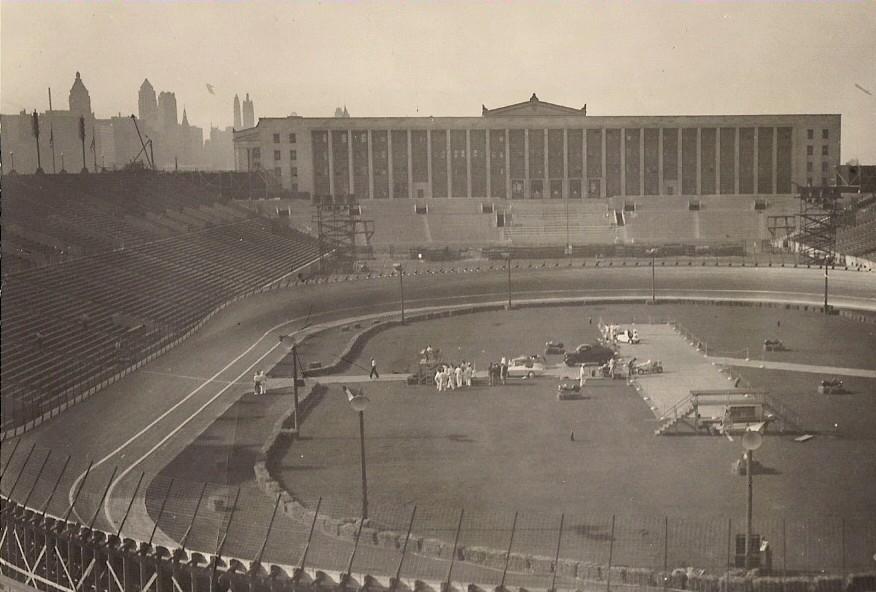

  19. Rootie Kazoootie
    Posts: 8,130
    Rootie Kazoootie
    from Colorado
    Back in 1939, they built a 1/4 mile board track inside Soldier Field for midget racing. Wasn't meant to be portable though.

  20. easter
    Joined: Nov 25, 2010
    Posts: 554
    easter
    I wonder if the "crossover" through the infield and the parking area/pits were wooden as well. I can't imagine racing on wood tracks of any size.
  21. Rootie Kazoootie
    Posts: 8,130
    Rootie Kazoootie
    from Colorado
    Being exposed to the elements like that, it probably didn't take long for those boards to start warping and cupping. Must have been a bumpy ride indeed.

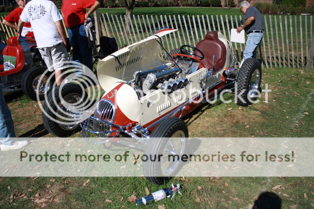

  24. baldtireman
    Joined: Aug 3, 2009
    Posts: 378
    baldtireman
    Did **** Linder drive this Vargo car? :confused:

  27. ron kramer
    Joined: Nov 26, 2008
    Posts: 94
    ron kramer
    from penna.
    We went to the Reading Fairgrounds Reunion show where the car was displayed, hence I read the info about the car, and the drivers. Yes, **** Linder is listed as one of the drivers. Its a beautiful piece of history.
