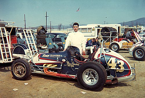

    Ask him when you see him at Fontana.
    (He did run it last year at Milw)
    Tom had that car at our Desert Cl***ic Concourse last month and I believe he said it is now en route with a few others to Indy for The Centennial, not sure if it was one of those he said was then going from Indy to Goodwood. (What a life eh? I'm pinching the pennies for Miwaukee)
    http://s1011.photobucket.com/albums/af233/carl44s/DesertCl***icConcours 2011/

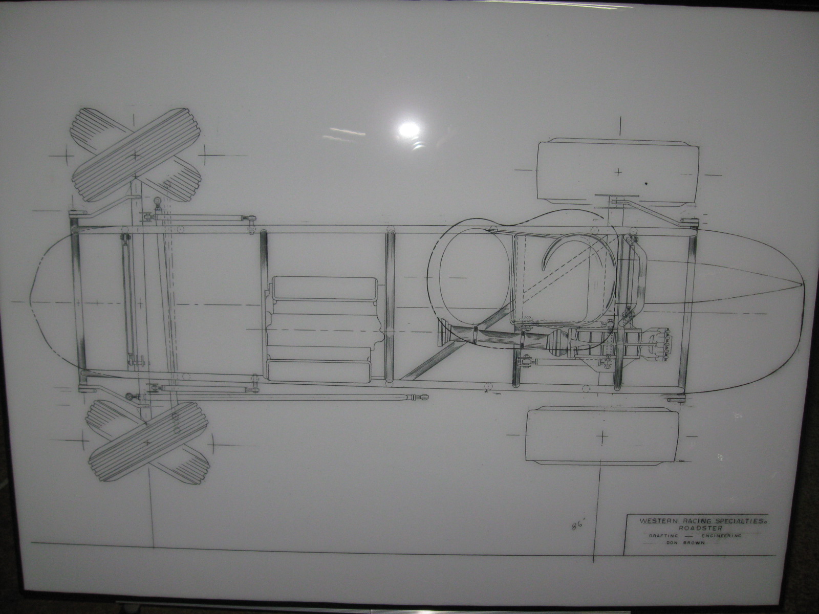

    Bob: Power steering on sprint cars was developed by none other than Tommy Lee for Don Brown's Mechanical Rabbits. Tommy was a machinist and had a shop three doors down from Don's shop and he worked on the Rabbit's in the evenings which was of course the time of the day that the Prince of Darkness worked. The first steering box was a Saginaw p***enger car box and in pic's of the cars you will notice a very long pitman arm so as to quicken up the p***enger car ratio. Many people wondered how the Rabbit's worked so well on dirt! It was because they ran a ton of caster that could not have been steered by conventional means. I believe Rootie has posted these pictures which brought back great memories. The first is Don leaning over and I don't remember the guy's name in Little Joe's car and that's my Dad in the background looking at them. The second is Don at Whiteman Stadium in his cars maiden laps at a private session during the filming of a Ford TV comercial. Tommy Lee would finish that day with backing the car into the fence! Notice no injector stacks, thats another great story!
    Dan Ruth
  13. Steve Bonesteel
    Joined: Aug 31, 2009
    Posts: 166
    Steve Bonesteel
    from Clovis, Ca
    Great drawing of Brown's roadsters

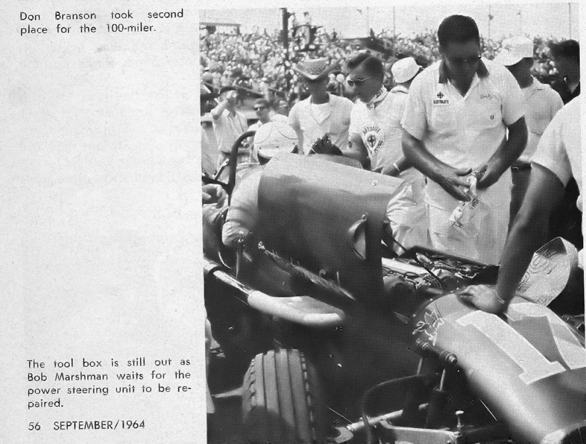

    Came across this a while back, seems they may have been messing with power steering fairly early on in the 60s.

    Oh my God! where did you get those? I remember a drafting table in the shop and remember the plywood fixtures that Don used to create the sides of the frames. Don created wooden bucks for the bodies which were then sent to LA Metal shaping for ruff out and then returned for welding with cobalt blue lenses and a gas torch. What followed was hours of file work and hammering. Man was he an Artist!
    Dan Ruth
  24. Steve Bonesteel
    Posts: 166
    Steve Bonesteel
    from Clovis, Ca
    Dan,
    These plans, drawings are framed and hanging at the Woodland Museum in Paso Robles. Not sure where Woodland got them. There will be an open house car show at the museum Sat. May 14, with the Estrella Warbirds Museum on the grounds of the Paso Robles airport. www.ewarbirds.org

    Rootie, The Hopkins dirt car got Saginaw steering after Trenton in 1961. Bettenhausen was gone and Branson got the ride. I have a photo showing black tape over the hole for the Halibrand unit. The left mount is still in the car and the side panel hole is welded shut. Also have Saginaw manuel that was sent to Yunick in 61.
