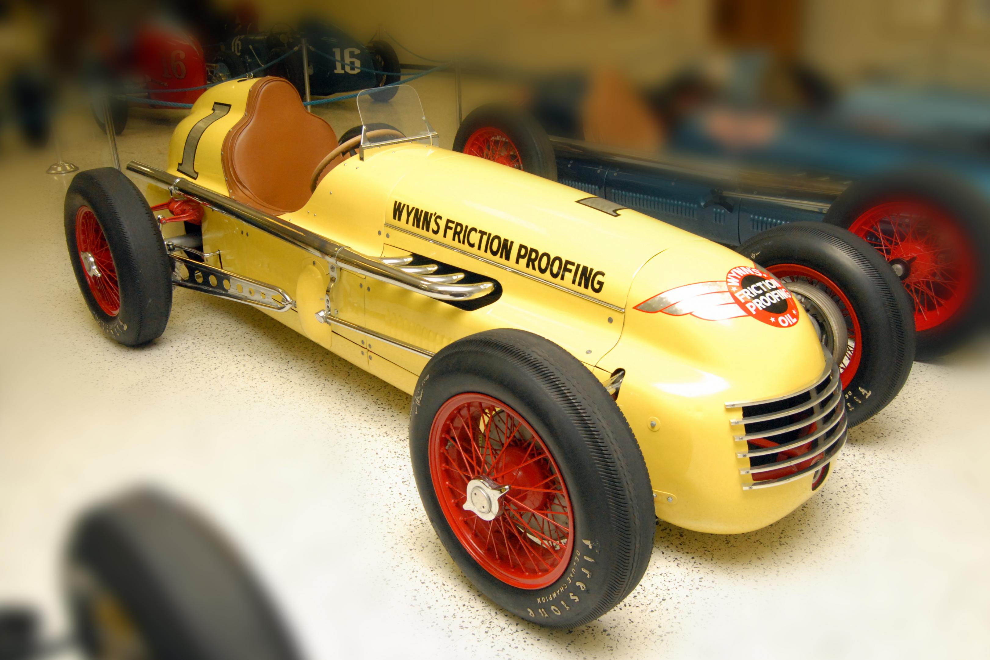

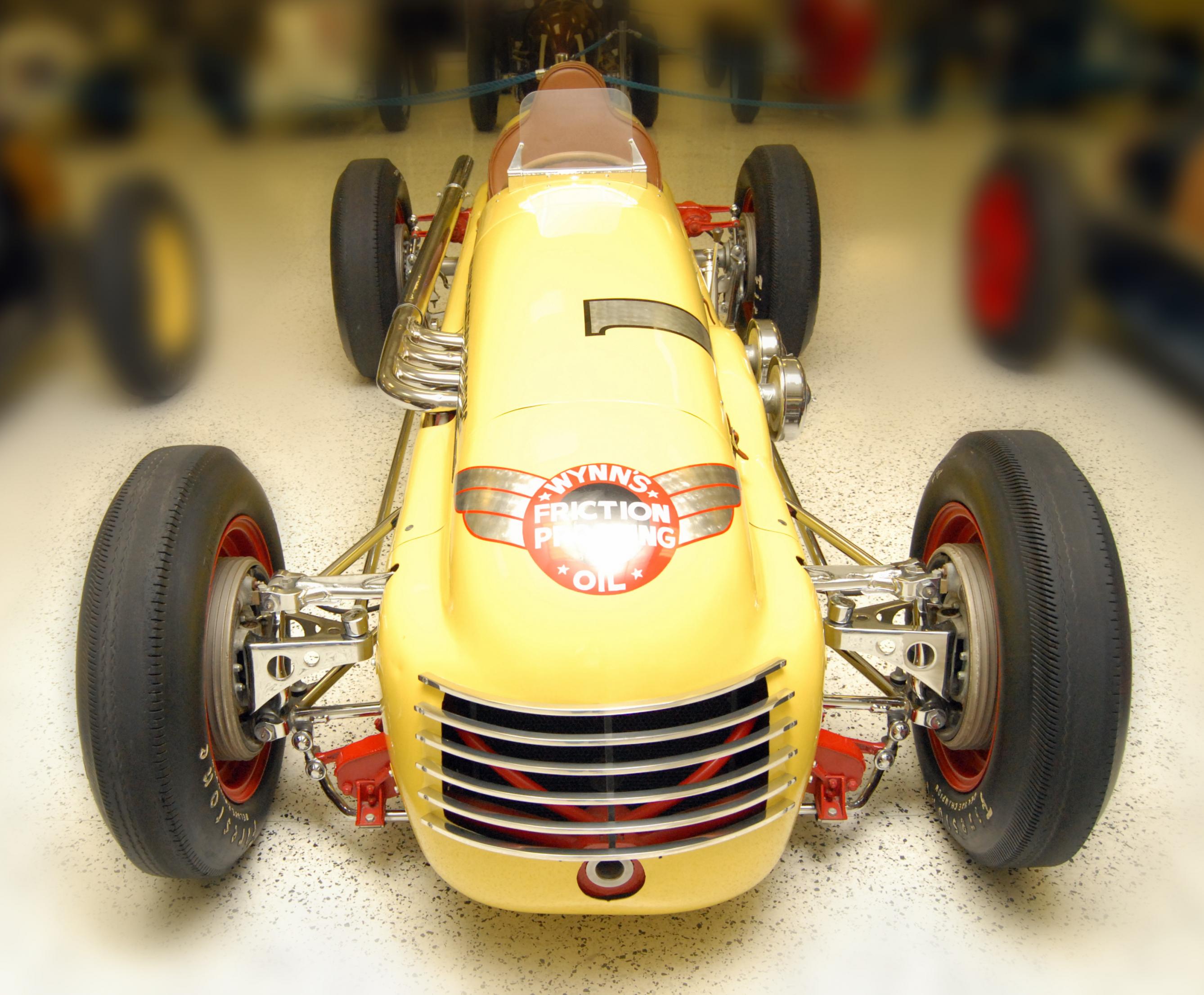

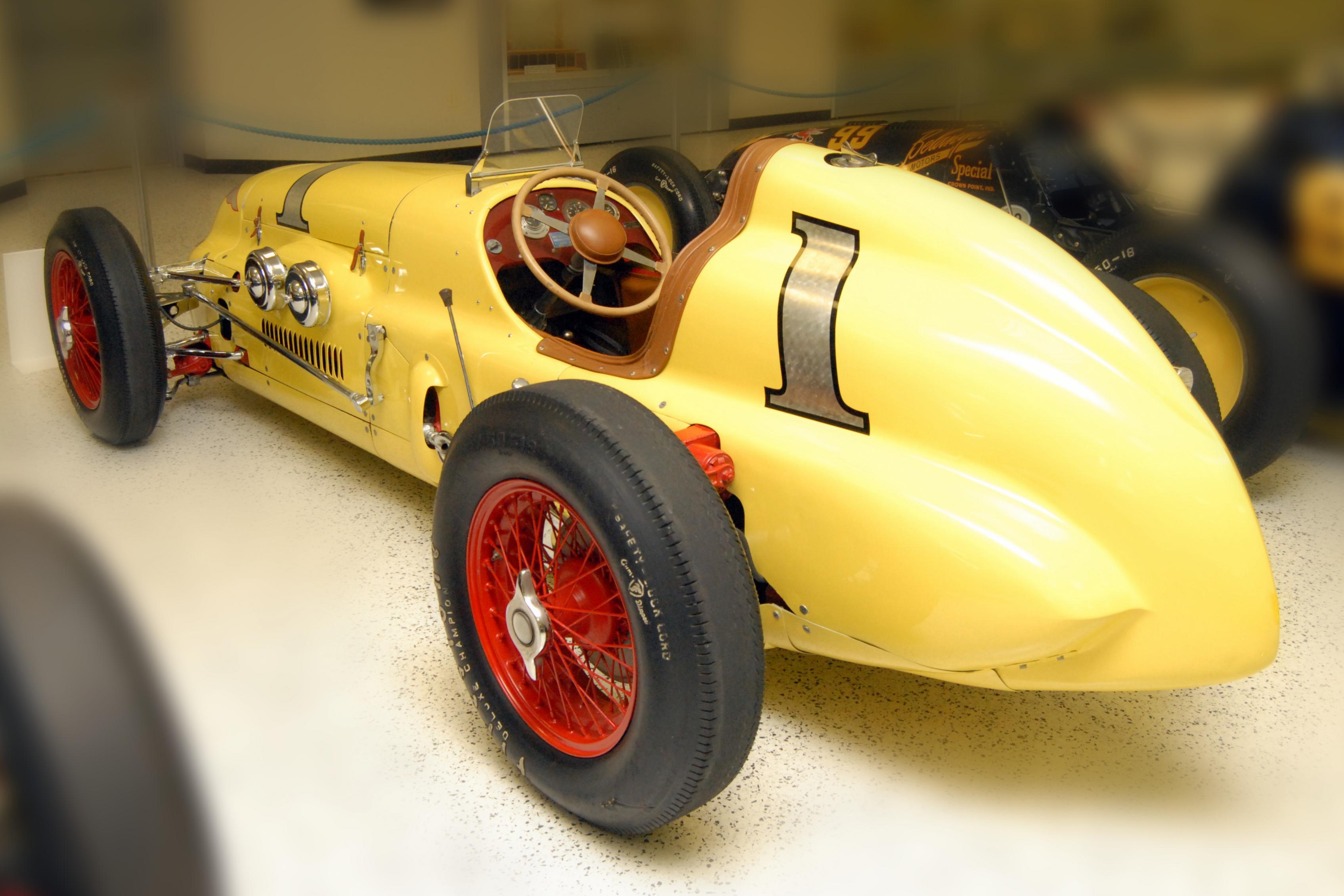

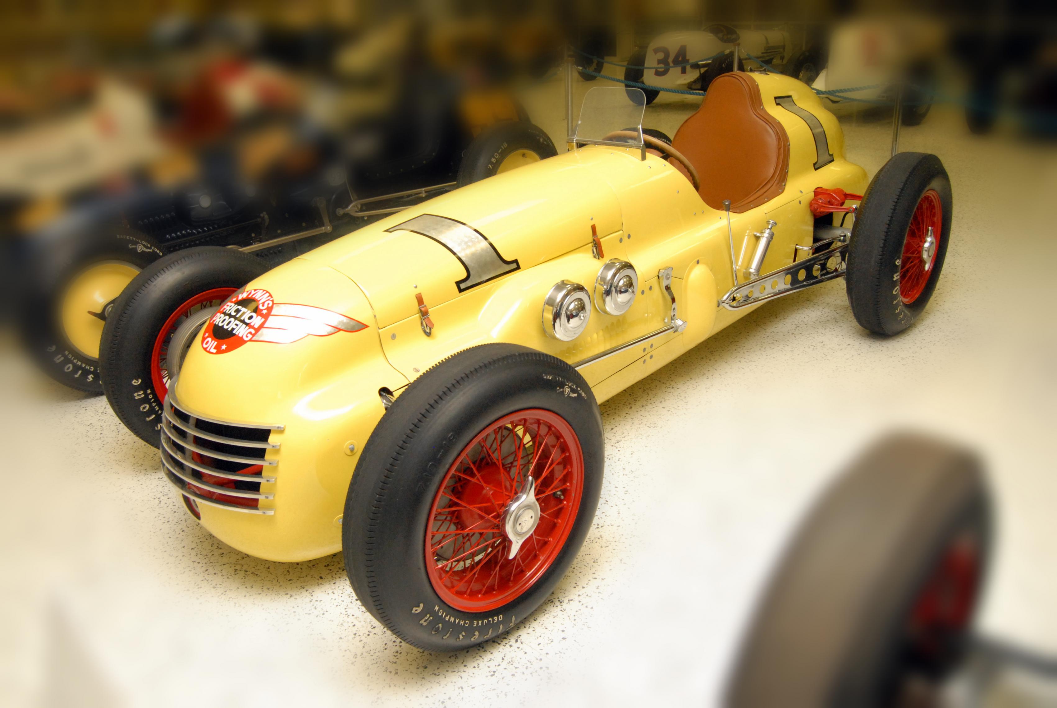

    1950 "500" winner Johnnie Parsons - Kurtis/Offy average speed - 124.022 MPH
    Johnnie Parsons had a most enviable record with this Ed Walsh-owned, Offenhauser-powered Kurtis-Kraft. Taking over the car ( then painted red ) durning the 1948 season, Parsons won the final AAA Championship race of the year at DuQuoin Ill. In 1949, he finished second in his first "500" start, after which he claimed the AAA National Championship ***la by winning five major events, all of which were conducted on dirt tracks. In 1950-the car now yellow and sponsored by Wynn's-Parsons was running in front when the "500" was halted by a downpour at 138 laps; Declared the winner, he had led for 115 laps. The car was the sold to Jim Robbins and in 1951, East Coast dirt track spe******t Mike Nazaruk made his "500" debut and finished second. enjoy! :D

    That DuQuoin race he won was October 10, 1948. Should
    be a very significant date for all race fans!

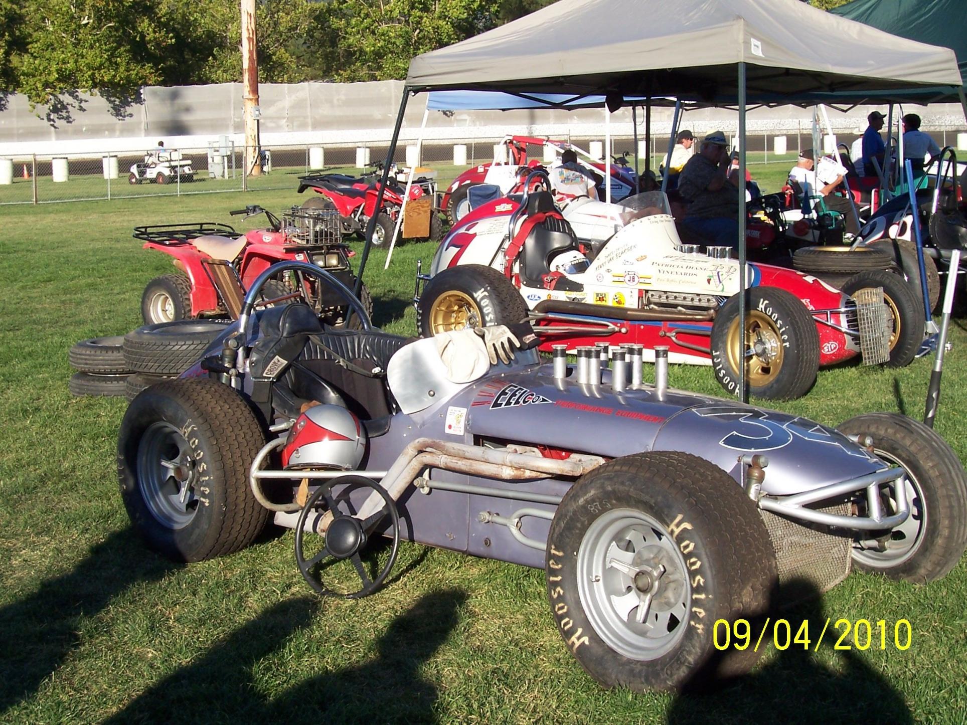

    Friends came for dinner tonight and brought photos they took at Calistoga this year, this one got to me. Kenny Van Blargen and I pitted together. All my best wishes Kenny. Off to Fontana in the morning.

    You can't fool me,that's a Ford Fusion ! (The grille that is )

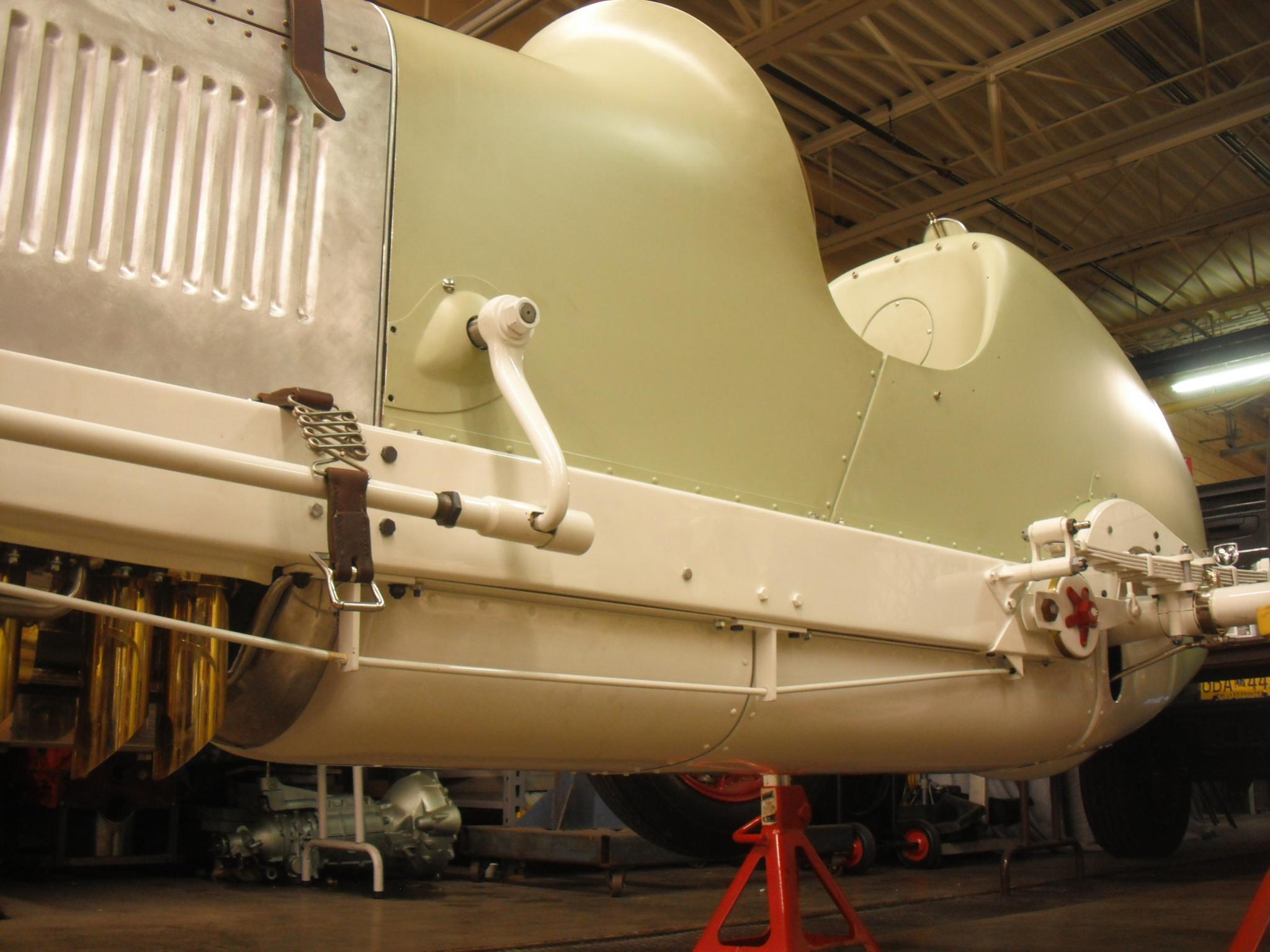

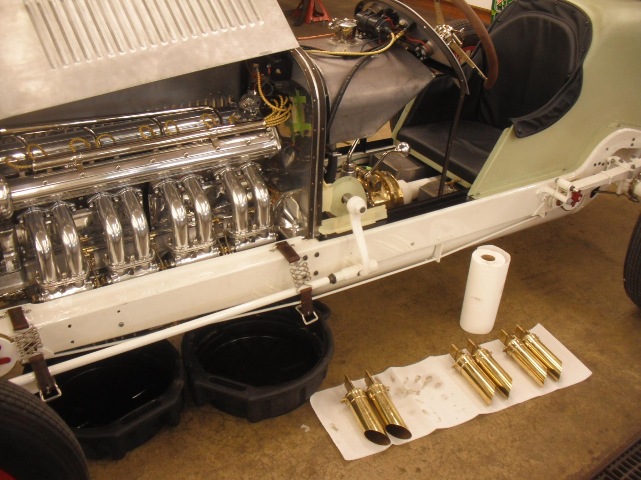

    It's been a while. Been slamming on the Milton/Miller. Here are some progress shots.
    State we are in now= Car has been driven with Body on it. (Pictures ten pages back) Sent Body out for paint. Will get body back this week, Going back trough and finalizing a MILIION lil things that needed more work.
    What's below=
    Full body shots
    Original Pictures of the car (and twin car)

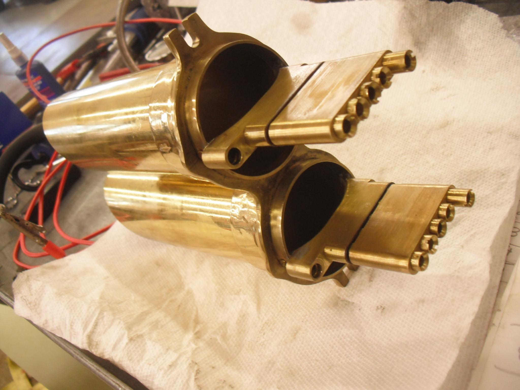

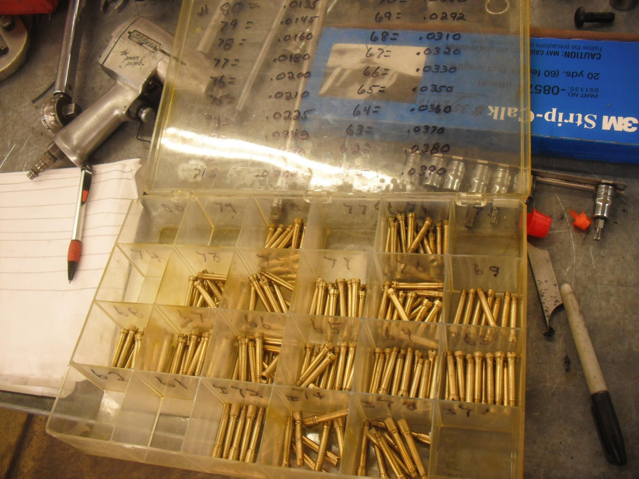

    The Re-Jetting process- Run it, see where in the throttle stage the engine needs to be richer or lean and change.. I ran it, pulled the stacks, Changed Jets and ran it again 5 times.

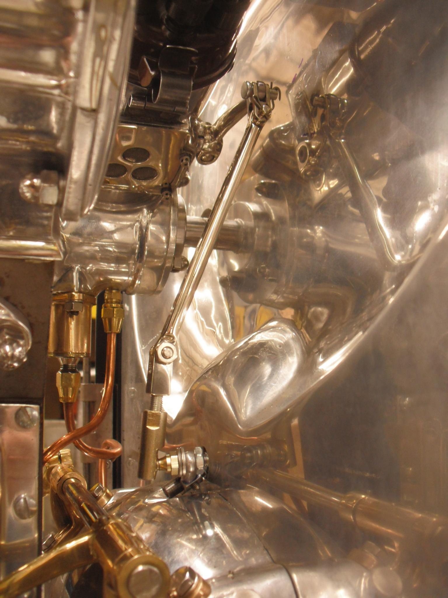

    Building the Linkage for the Steering wheel operated Spark advance

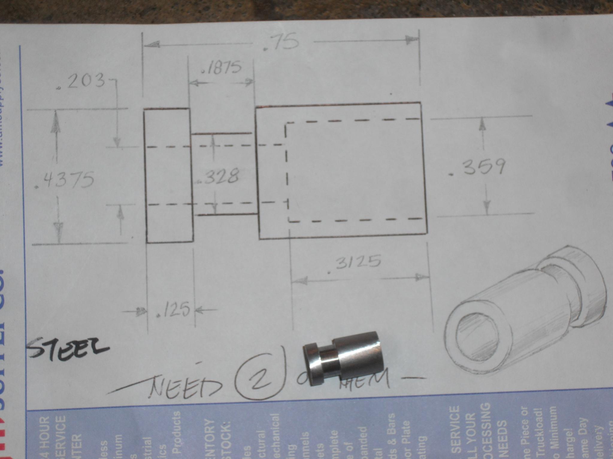

    Little "End Clamps" I drew up for Don (the machinest) to make. Jim told me what He wanted, I drew it, Don made it.. and they worked Great!
    Enjoy!

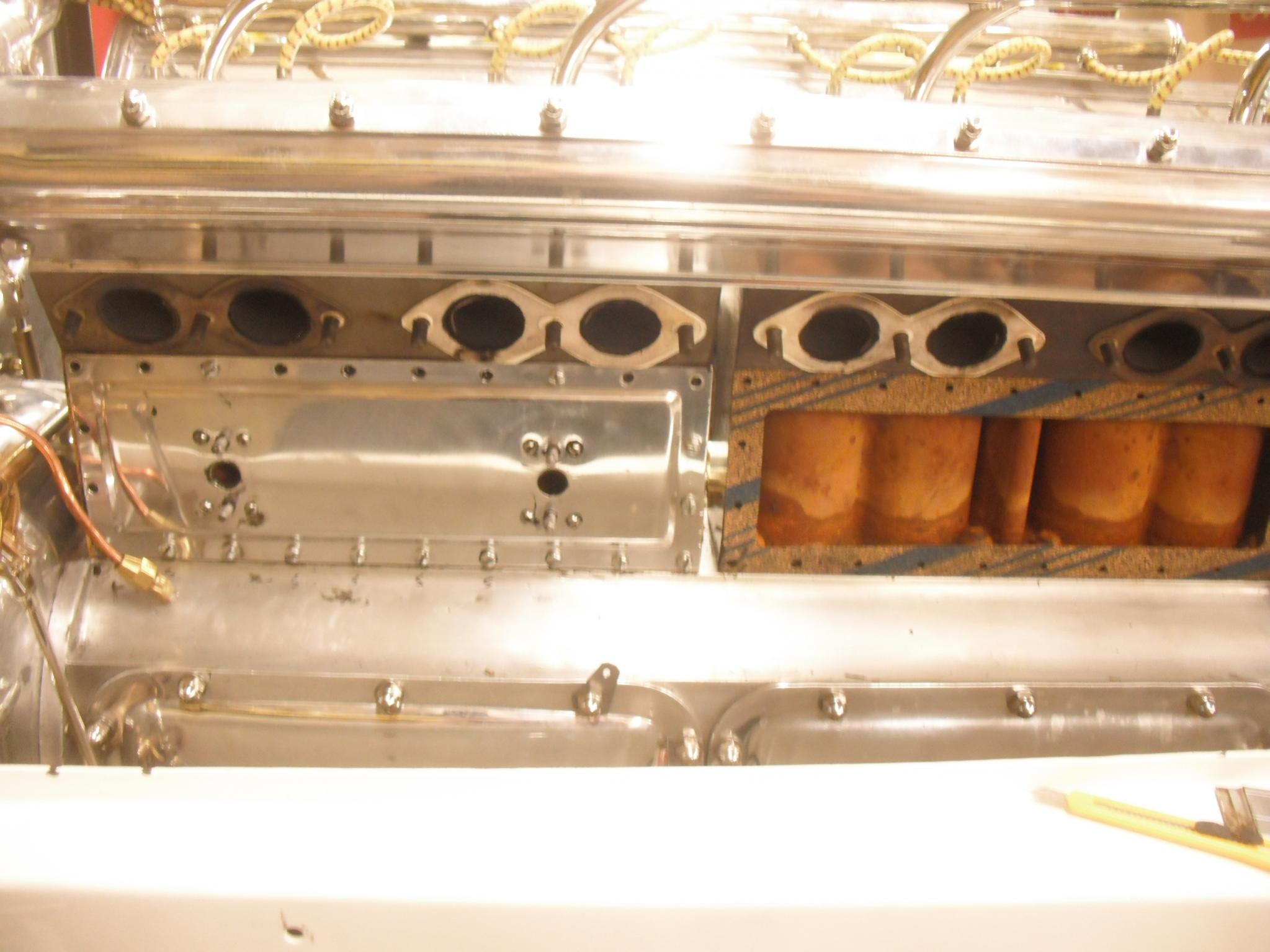

    More..
    Vent for Rear End
    Checking and re- adjusting Hand Trans break (what actually will STOP the car at the moment!) :p
    Chrome got done on second Hand pump.. switched out.

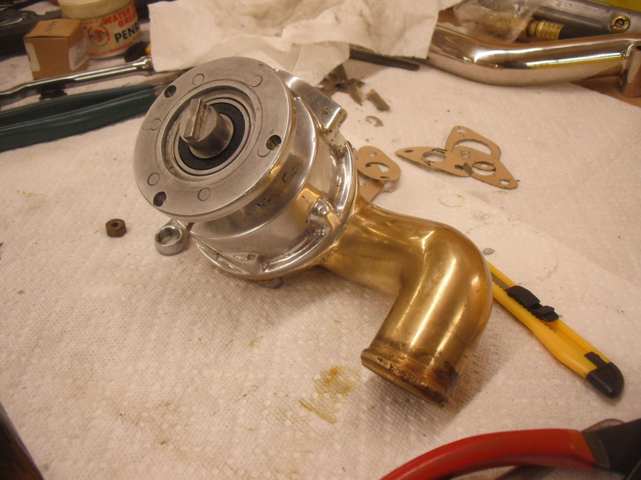

    Rebuilt water pump due to a small leak

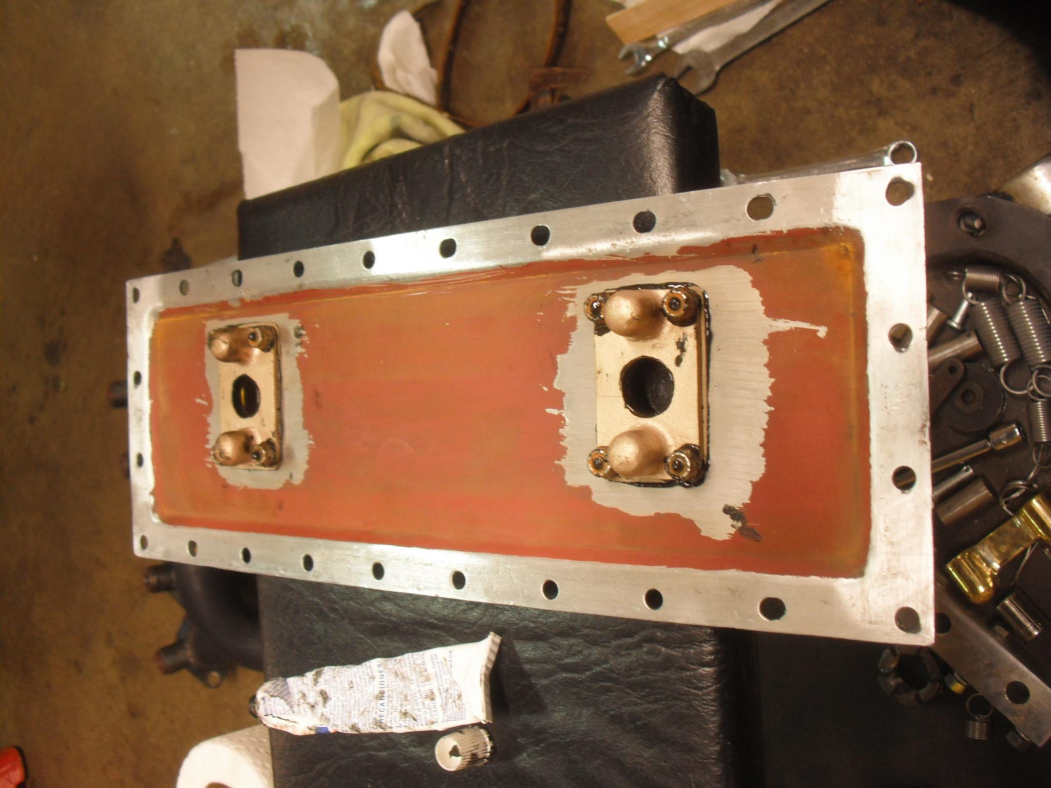

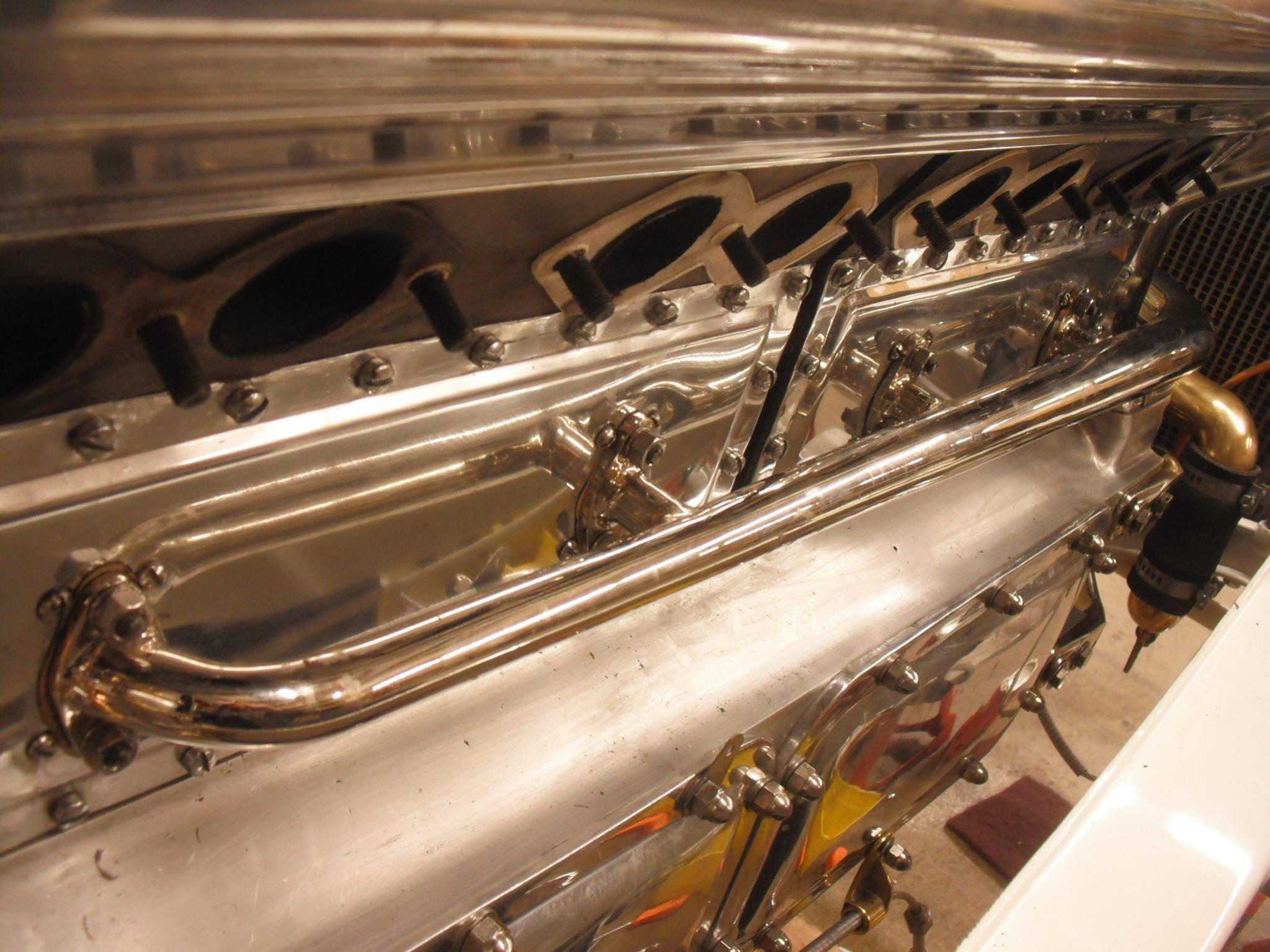

    Two of the unions on the Water manifold were leaking at the block, so I had to pull the Block side covers and re-do.
    Finished, and fine tuned the Hand crank
    She'll be at INDY. See ya'll there! I'll post mor pics of her as I get a chance!

    Great work! That must sound pretty weird with the 8 straight stacks and no collector!

    Those are the updraft carbs, Bob. You can see the tailpipe peeking out from behind the fuel tank in this shot.
    Josh, was there any kind of baseline setup book still available to start figuring out the jetting?
    I get more envious with every posting. Can't wait to see it at the Speedway.

    I feel like such an idiot! I thought they were exhaust stubs! Don't tell anyone, promise?
  23. Buildy
    Joined: Jan 29, 2008
    Posts: 1,521
    Buildy
    Hey Bob,
    Don`t feel bad,some of the earliest race cars had single pipes for each exhaust port. They sounded like cannons going off and flames shot out the pipes!
