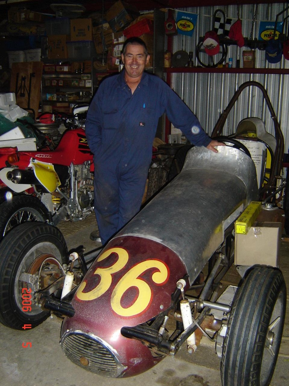

    INDYRJC, the Rutherford picture shows an offset to the suspension that isn't in the unknown car picture. Just an observation.

    Not to mention the JR 36 looks to have a 'watts' shackled arm/2 link setup and the ? 36 has a 4 link roller arm setup.

    Another possible "clue" that the two 36's aren't the same car is the grill, a piece that's possibly less likely to have been changed:
    Although it's difficult to tell due to the different angles the pictures were taken, the JR 36 seems to have fewer bars in the grille, and the starter snout hole appears to be lower in the opening than the 36 that's now in Oz. Also, it doesn't look like there's a scalloped edge around the JR 36's grille.
    Shock mounts are higher up on the JR axle, no visible exterior oil tank, and it looks like a one-piece hood rather than a separate cowl.
    Nothing definitive, though; I say ship it back up and gissa look!:D

    There ya go, if he ships it back over to it's motherland I'm sure we can figure it out and it probably won't get lost in shipping or anything. ;)

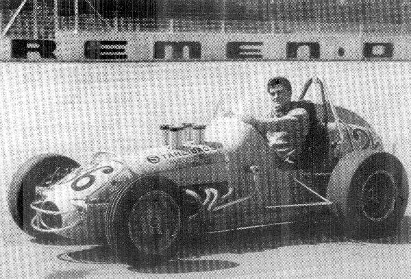

    re: ?36 car- The plot thickens, as jjones pointed out the Stahl Bros. (out of Ohio) ran a #36 Champ car in 66. According to Ultimate racing history it was a 1953 Kuzma, so I think we can rule out a 4 bar with a roller arm 4 link. However, they also ran a sprint car in the 60s and though it's not much of a pic, compare the lettering style of the 6 to the 6 in the Aussie pics. Also check out the shape of the cowls. Hmmmmm.

    Rootie, that 36 sprint car looks like a Ron Ward car.

    Rootie, Is that Cy Fairchild in the 36? Denny Z.

    Yes it is. Here's a shot of him at Salem in the Stahl car that shows the numbering style better. Not definitive, by any means, but kinda makes me think there could be a connection between the Stahl Bros. and the ?36 down in Australia.

    I think we're sneaking up on this one; I see a connection too, but I don't think the Stahl Bros. sprinter is the car in Oz. No oil tank, I can't see the radius rods on the sprinter, so I think they're shorter than the "mystery car", and although the cowl shape is similar, it's still integral with the hood .
    It's definitely not a '53 Kuzma, though. That would've no doubt been a single rail with a spring front or parallel bars.
    It may even be that Ron Ward (or somebody) was building the Stahls an updated Champ Car to replace the old girl, and it was never finished; I once had a TQ that was a Sherman Oakes' copy of a Bob Bogan copy of a scaled-down AJ Watson 4-bar design that never got past the stage of completion the 36 car sits in today.

    HA! I'm getting confused. You guys claim the car in Aus is a champ car and now you are comparing it to the Stahl Bros. sprint car. It seems easy enough for someone to measure the wheelbase to decide if it is a champcar or a sprint car.
    Actually there were quite a few of the Ward-Watson-Phillips space frame/4 bar sprint cars with Watson bodywork built in the midwest by various car owners and builders during the mid 60s for USAC compe***ion.
    The Stahl Bros. were farm implement dealers from Fletcher Ohio. Their sprint cars were painted Case yellow.

    Yeah, nothing proof-positive about this at all and I agree that it's not the sprint car streched out or anything. I'm kinda thinking along the lines you are though, in that somebody (maybe not even the Stahl Bros.) was building/rebuilding/recreating a champ car and used the nose off the Stahl's Kuzma of 66. I've looked high and low for a pic of the Stahl Champ car but with no luck. That doesn't surprise me as it was only entered in a few races and didn't qualify for any. So I doubt there was ever a throng of photogs gathered around to take pictures of it. :)
