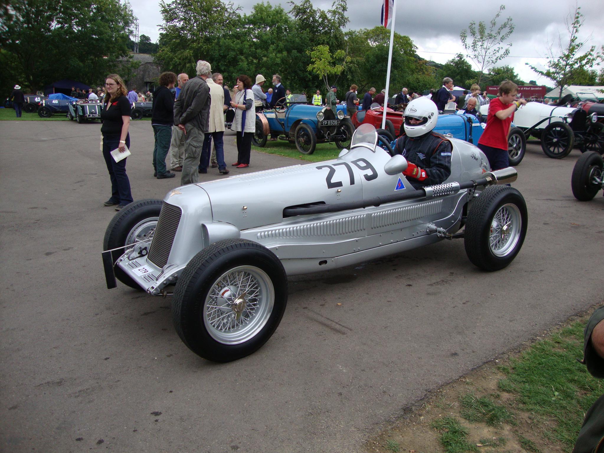

  3. Rootie......the Lagonda in my photo was built in 1935,and I suspect the ''Indy'' car was an early model revamped for the race. Here are a few more photos,

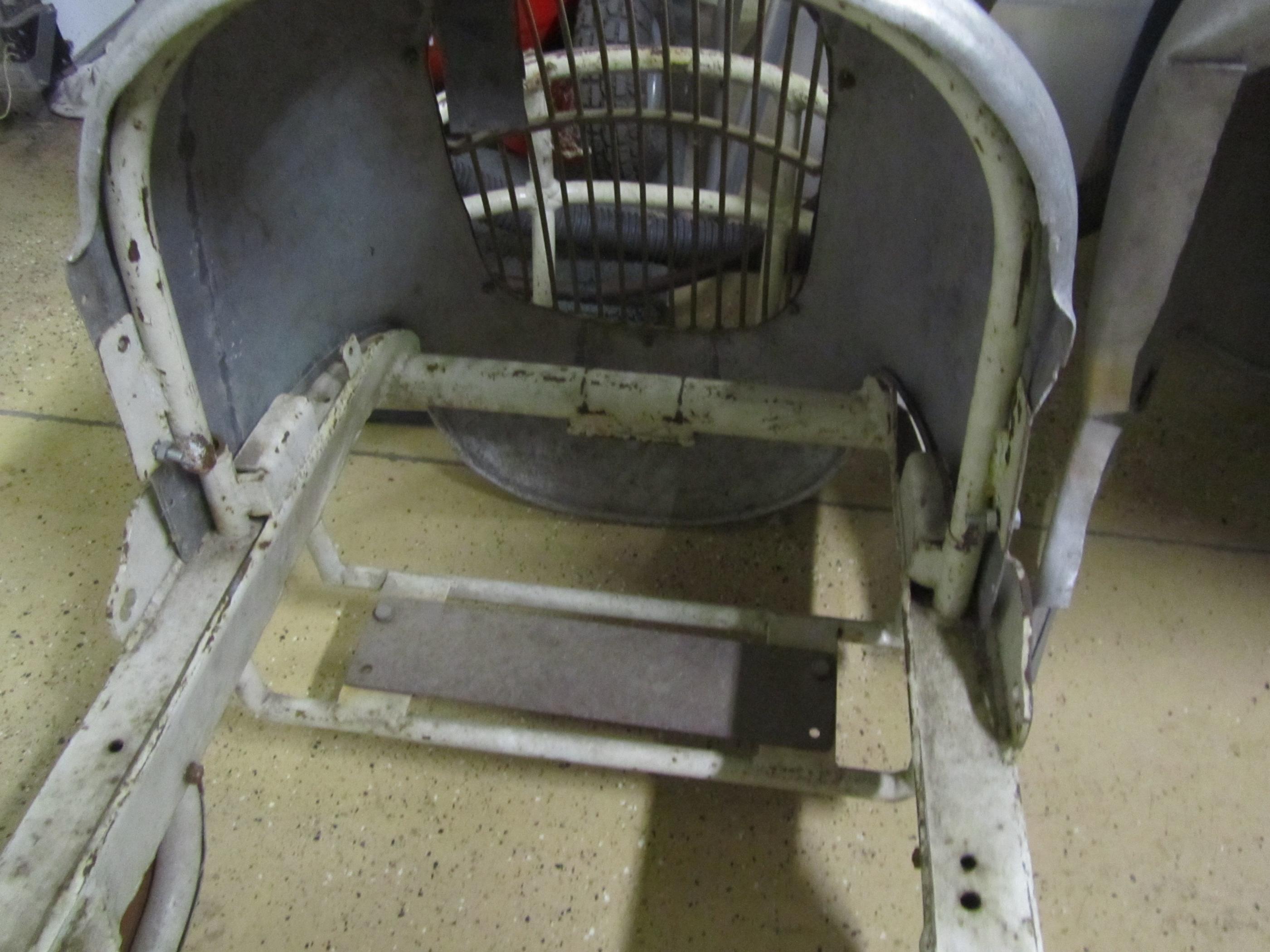

    We picked up this ch***is at the Hadly estate auction. Anyone know who and when this was built? What would have powered it? And anything else you may know about it.
    Thanks

    Homemade, possibly reworked early Chevy rails, built in the 50s-early 60s would be my guess. The drilled brackets look like the may match the front of a early SBC. Easy enough to measure and compare.

    It's pretty nice for a homemade job and its only 20'' wide at the front motor plate. If it is homemade the guy was one hell of a fabricator and welder. All the aluminum body panels and belly pan is also very well done.

    HA! That's kind of an odd statement. Where did you get the idea that nice cars can not be homemade???.... Back in the 50s and early 60s, there were no Gambler factories or Beast factories cranking out dozens of ***embly line sprint cars like they do now.
    Frankly, the greatest sprint cars in history were "homemade jobs". Its not about where they were built, its about who built them.... well, at least, it used to be.

    An EXCELLENT point, Mac Miller.
    I have friends who are excellent car builders and their cars are the equal of any "factory built" racers currently available. People forget where the cl***ics came from. The equipment in the Miller/Offenhauser shop was very typical of high school/tech school shop of the day. It was design and operator skill level that set them apart. We've come a long ways from the days when everyone in racing had a father/uncle/brother with a machine shop in their ba*****t and on the balance that is not PROGRESS.
    My current driver, his father, and I laid out and drilled a motor plate yesterday. We're proud to be p***ing our limited skill set along to a young guy who is eager to learn.
    Unless people make the effort racing will continue its march toward spec cars in arrive and drive series. I tell people you aren't really a racer until you bleed on a few homemade parts. We have two first aid kits in our shop. The results aren't always pretty the first time but eventually they will be something we are proud of.
    I think the ch***is in question is mid 1940s not 50s/60s. By 1948 guys were sold on tube ch***is and the rail frame wasn't widely used in new construction. I understand rail frame cars could still be compe***ive in later years but is was actually easier to build with tubing.

    Like I said The guy must have been one hell of a fabricator!!! And I respect anyone that can do work like this
    Any idea of who made it? I'd like to find out any info on it

    Could be, but there were still plenty lowbuck/ homebuilders using rails in the 50s. The big money USAC guys were all into tube frames then but a lot of the small time local guys still were using rails. The Chevy frames were popular as they were straight without any bow and still readily available though heavy and about as easy to bulild as falling off a log.

    I'm admittedly not the sharpest tool in the shed, but not seeing any roll bar mounts, and if the front mounts are for a small block chevy, would that date the frame to somewhere between 1955-58? I also was wondering if it might have been built to rules for a specific track, that required stock, or stock type, frame rails.

    Of all the cars there THAT ch***is you pictured was the one I thought had the most "hope". It's pretty cool.

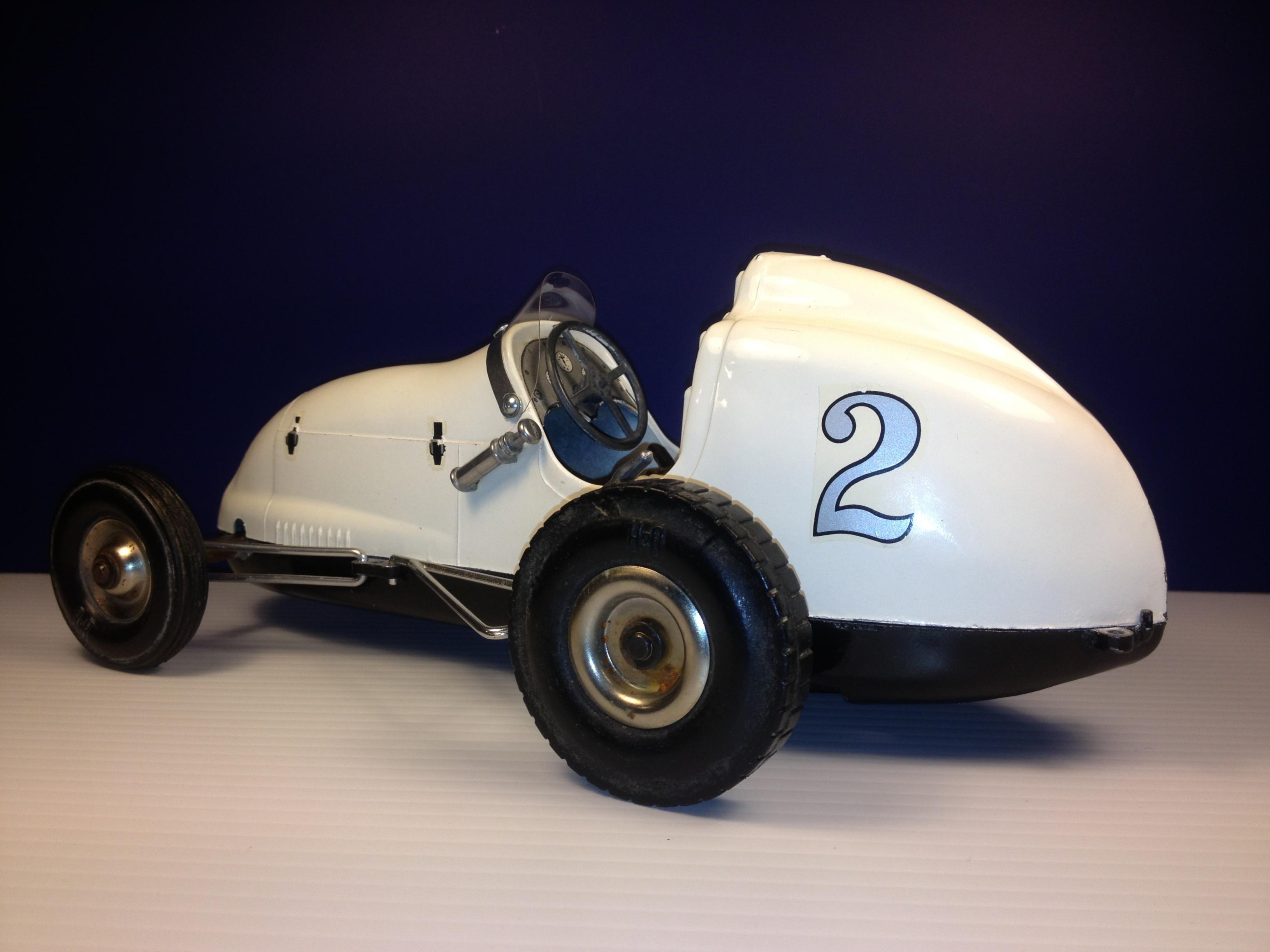

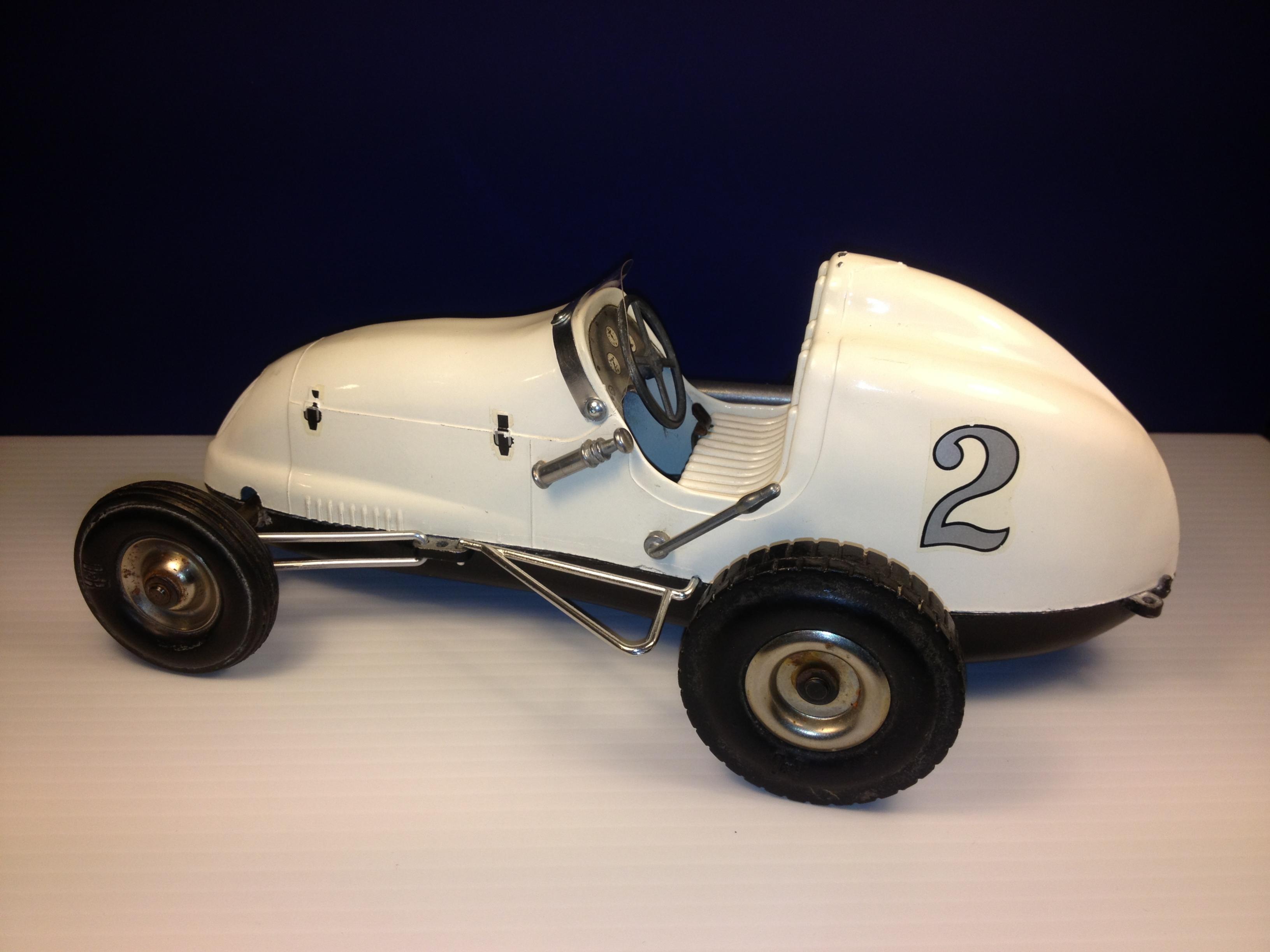

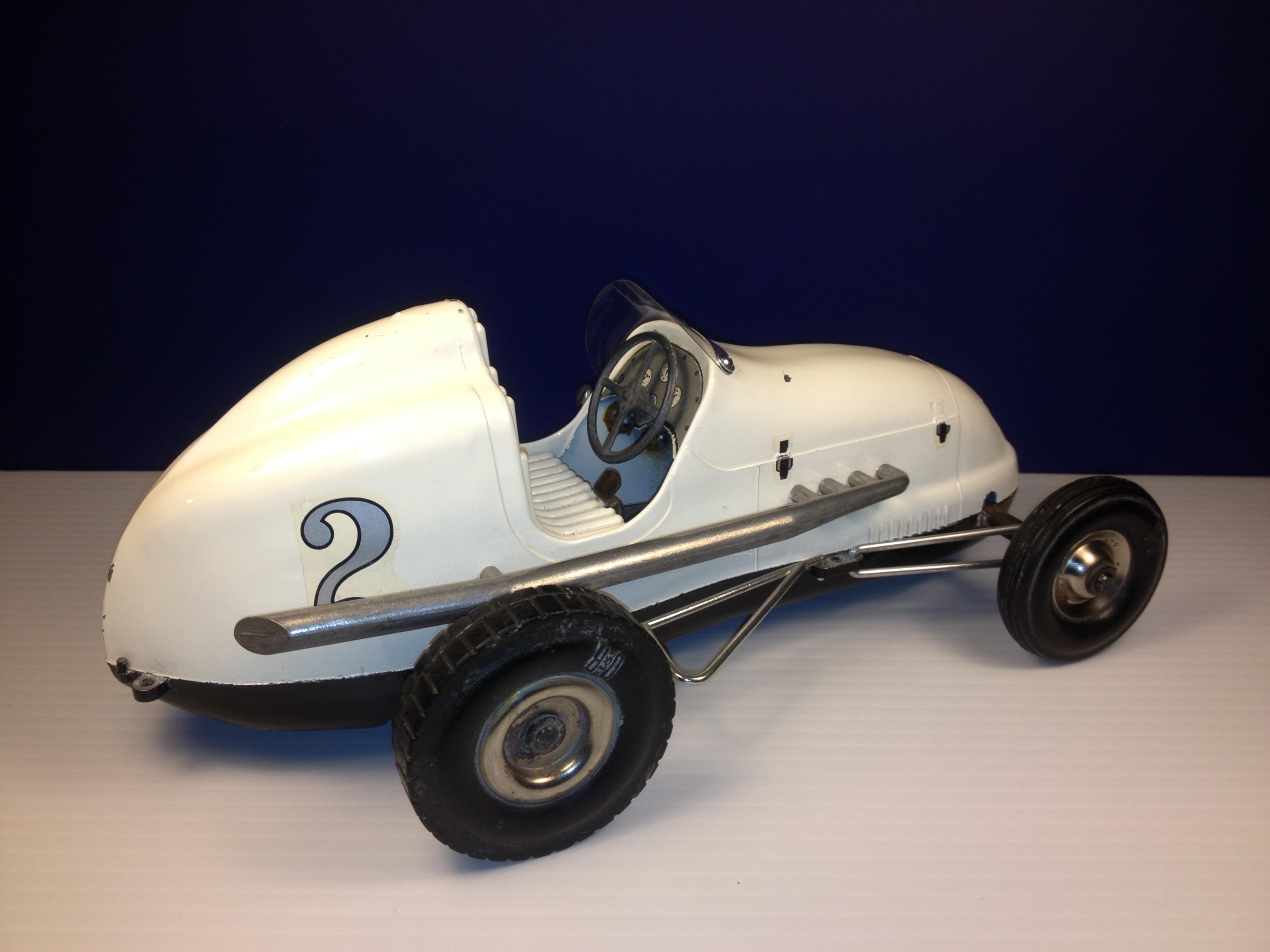

    Just got a new toy, a Ohlsson & Rice tether car found it local, needed a couple things to make it right, like a windshield, nerf bars and radius rods, now I just need a driver and I'm good to go. enjoy!
