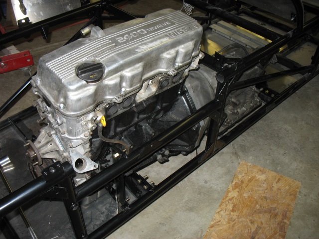

    First look at the new Trevis Indy roadster, nearing completion at mac miller's shop in INDY.
    This car will be the 1964 #64 Clean Wear Spl. driven by Ronnie Duman.

    Well mac miller is still here thankfully. Hey Mac what kind of motor is in your creation?

    Hi Denny
    The engine in this car is a SOHC 2400cc Nissan... more HP and torque than a 2 litre ALFA and one of the few 4cyl. engines with the exhaust on the same side of the block as the OFFY.
