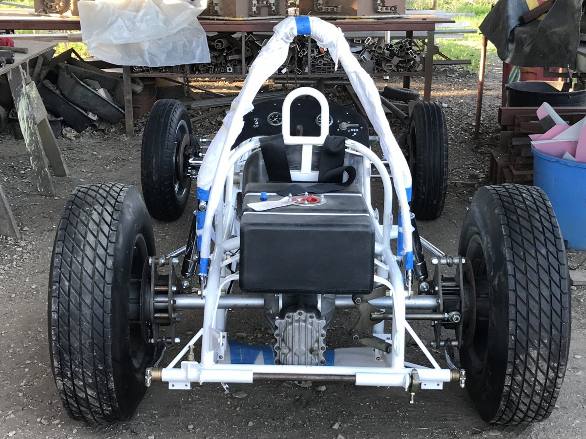

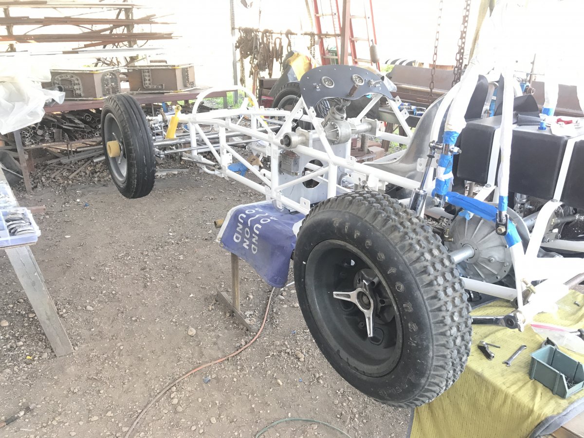

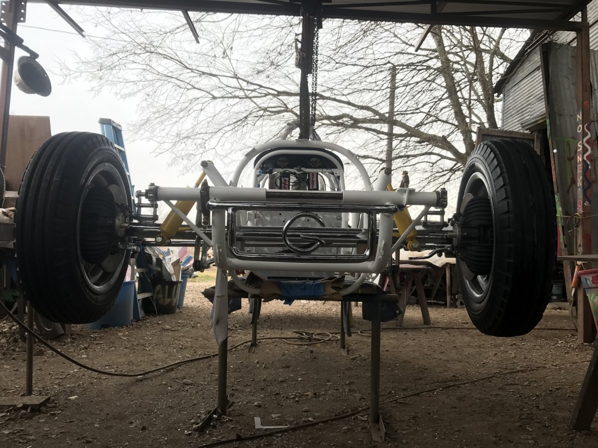

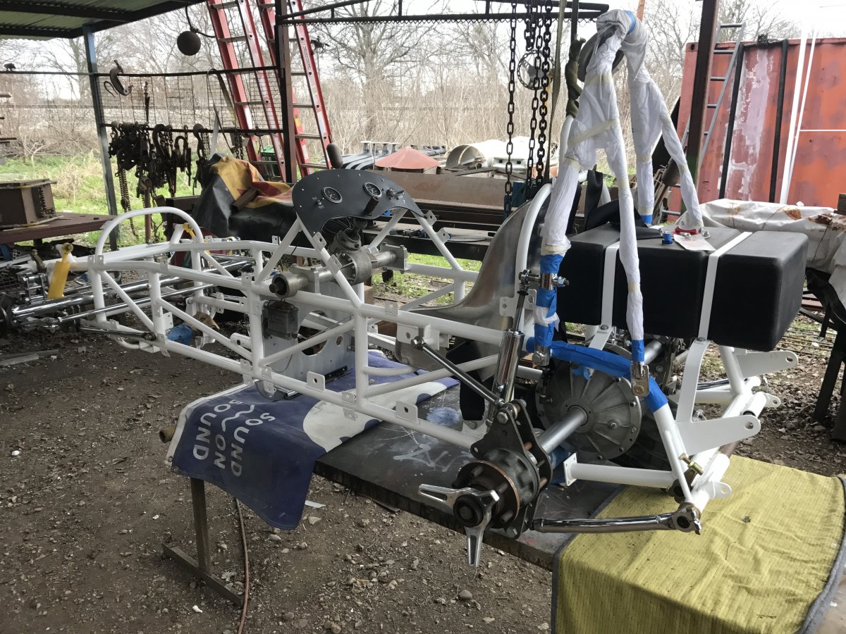

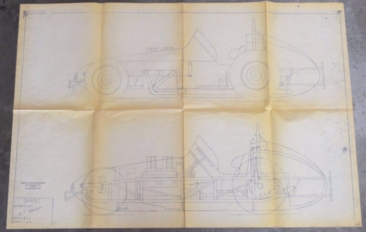

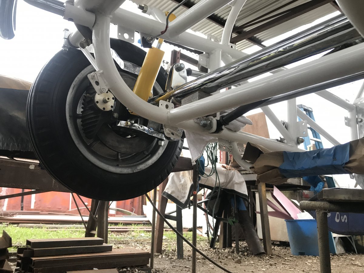

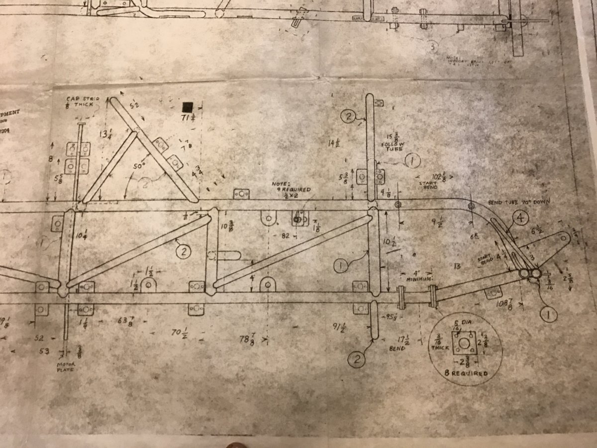

    Thought I'd share some update pics of my 1965 AJ Watson sprint car build. Had been almost a year since I started this project and the wheels touched the dirt for the first time Sunday!!! Man what a feeling. Have had so much help on this project getting it to where it is. A big thank you to Josh Shaw, Ron Greenfield, Frank Koerbacher, Martins Machine, Ralph in Spokane and so many others.. this has been a p***ion project and trying to do it "right" has not been easy. That being said I was fortunate to stumble across AJ Watson designed plans and would be happy to email anyone the scanned and to scale prints. Hope y'all dig it as much as I have

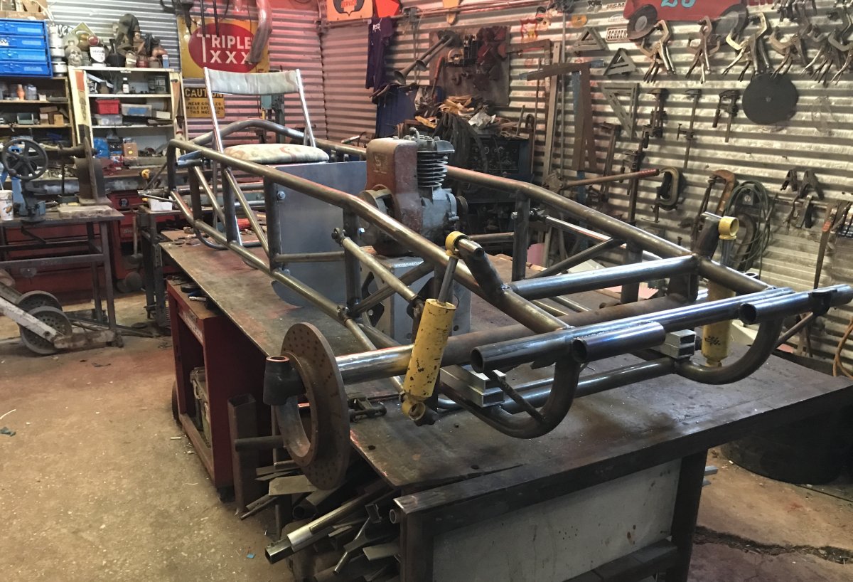

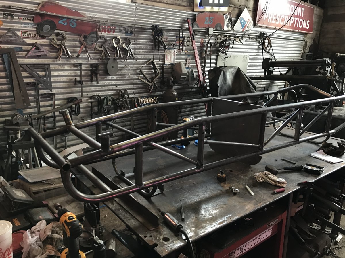

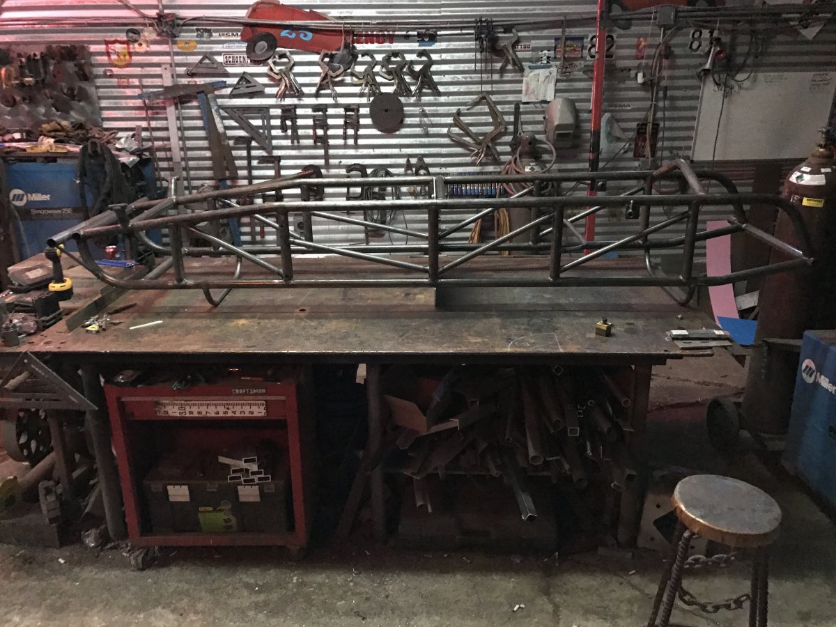

    And here is where I was at 1 year ago.

    WOW looks like you Nailed it! Could not be any cooler!:)

    Looking good. Any shots with the body on it ?

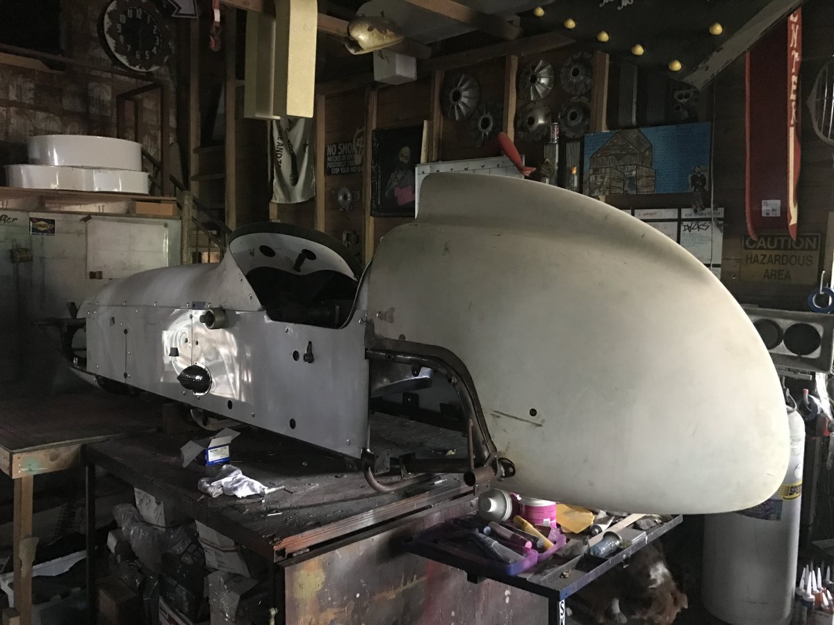

    Here's some pics with the body on. The belly pans have been made and everything fit up. Lots of dzus fasteners!!!

    I noticed a couple of different sets of tires pictured. Would you care to share who supplied your tires?

    Frenchtown flyer the tires are NOS.. once i get out to running hard laps ill probably have a new set of shoes at least on the right side... the Knobbys came from a set of wheels I Bought from Frank"One Shot"on the HAMB.. hes been awesome with help and encouragement on this project....
