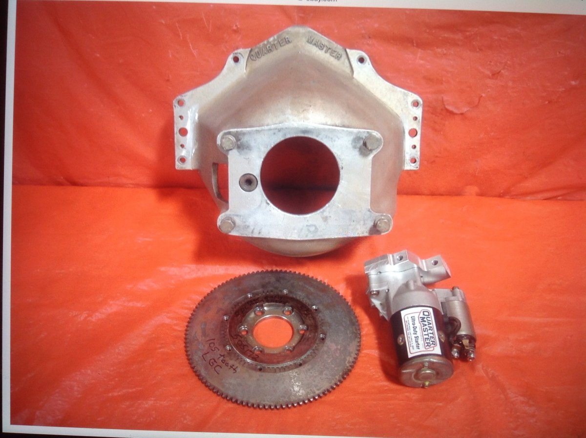

    Sounds like you have some work to do. I think there is a setup called quartermaster flywheel and starter & clutch you can google but you will have to redu your driveline.here is a picture of one Do you have a in and out box on a slider in the quickchange?ATTACH=full]3923221[/ATTACH]

    ****py pictures, but this would be the simplest method. I see this stuff on E-bay occasionally. I think this uses a standard 10.5" Chevy pressure plate. Depending on the input shaft, both Ford and Chevy discs are available. I think this is what Speedwrench is talking about.
