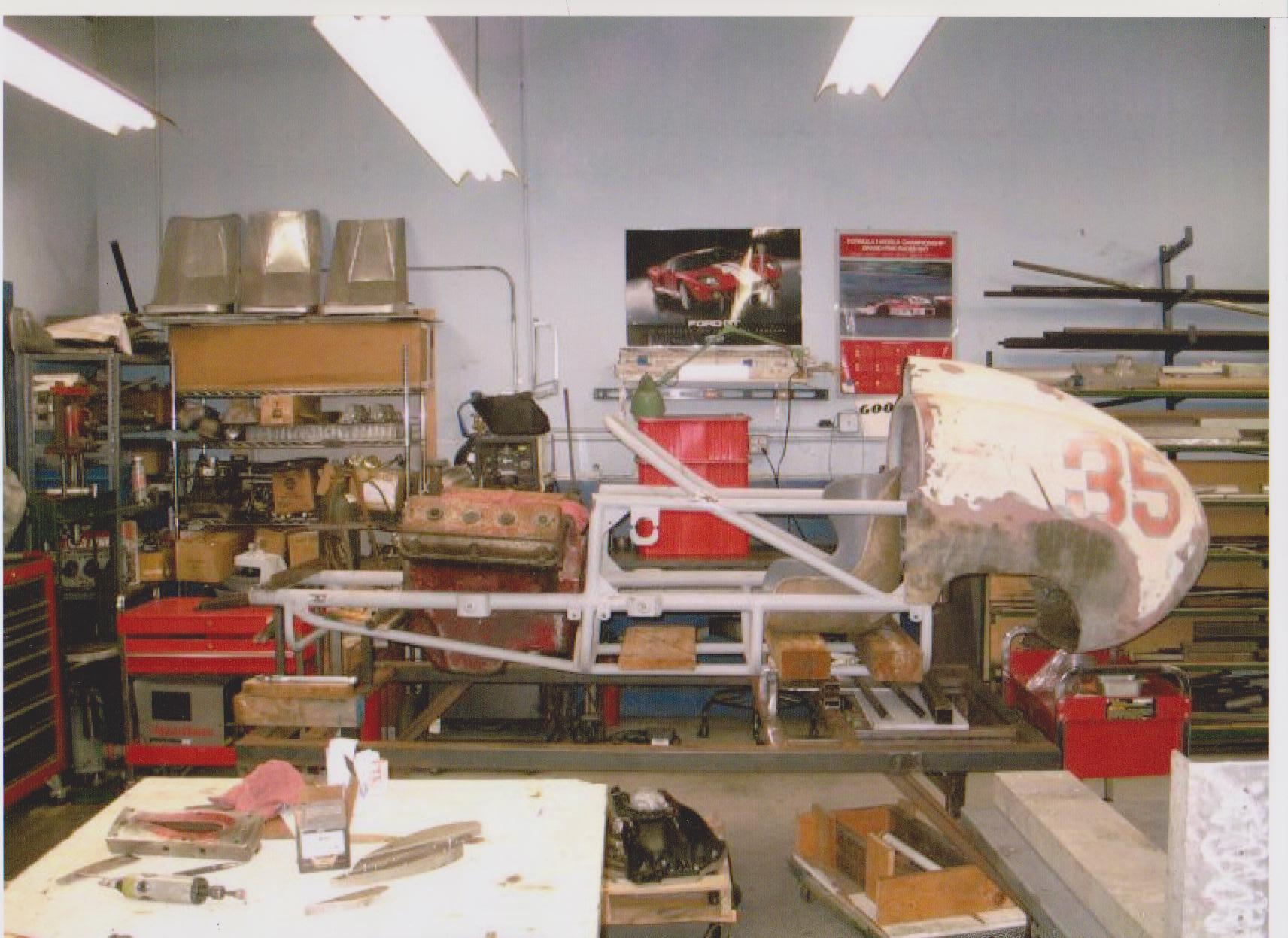

    That is a nice find. And the parts look to be wrinkle free in good shape too. His asking price for the tail, nose and grill does not sound too far fetched. Take it from somebody who built one there are a LOT of man hours in there to fab.
    That is a great start on a champ car. Except for the windshield area all of the hard compound bend parts are done.
    My feeble effort (ongoing):

    And Mr. Flyer, good start on your project.

  6. You have a great car there! Looks great .Time flies when building. Been on our 2 man sprint car for 12 years. Just chip away at it when I find period parts for her. Need a bit of body work still from rough areas then take it apart and paint it and re***emble. Just like Johnny Cash song "One piece at a time" . You will get there and have fun!!

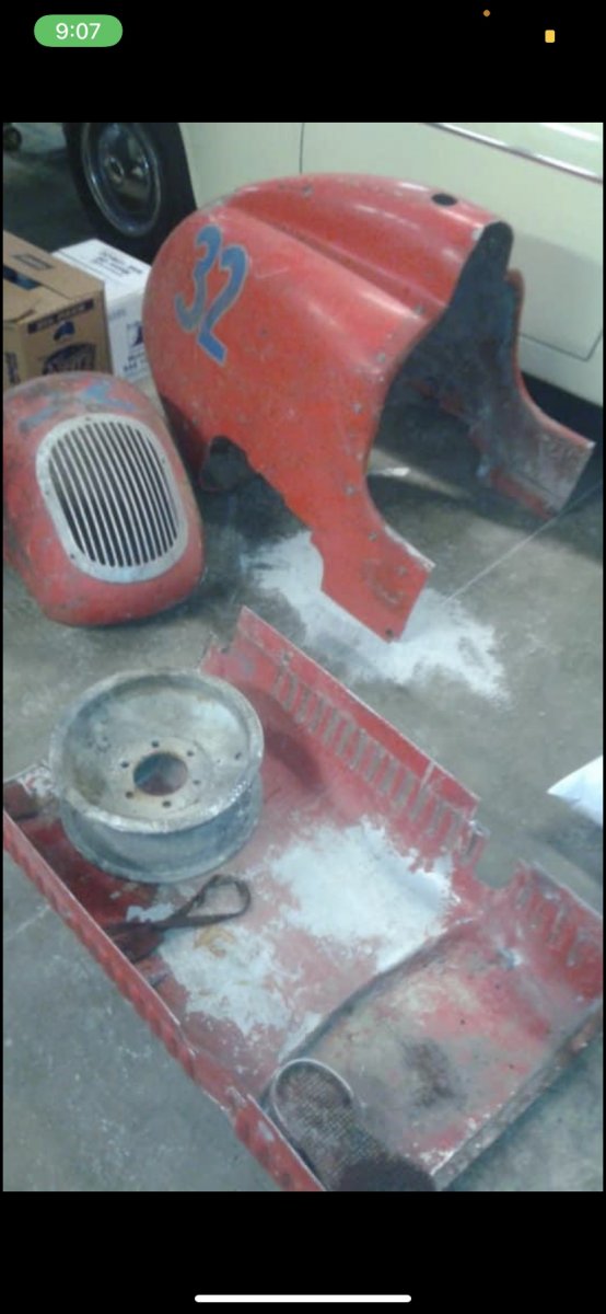

    Another pic, bought the set up for $600, also had a bottom aluminum pan with it. Thanks for everyone’s input so far! Hope I did well, I’m excited! 1st performance car build coming up, I’ll be here asking a **** ton of questions! [emoji631]

    You got a great deal, looks like it also included a magnesium wheel and a throttle pedal too. Well done!

    Score! I wish we lived close - it would be fun to watch your build first hand and share ideas.

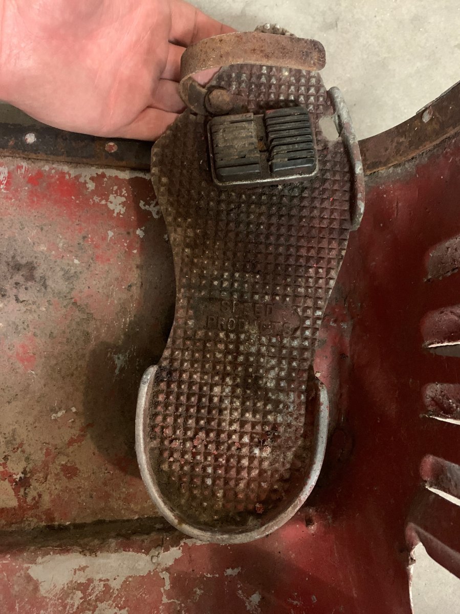

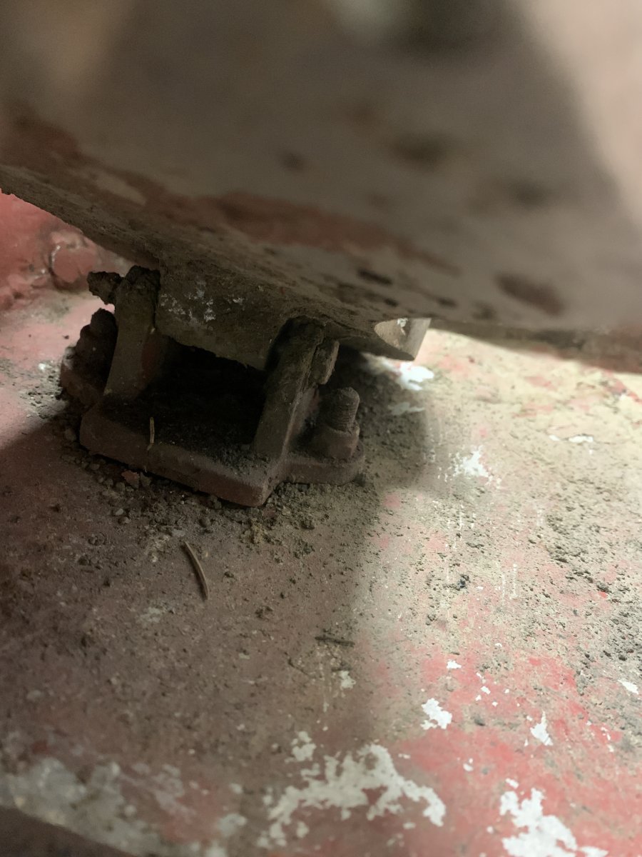

    Can you answer one thing for me? Is the gas pedal attached to the belly pan? I am wondering how to fit a gas pedal in - along with my size 13 driving shoe. There is very little room in my car because I'm using a transmission. I would have liked to use a cast pedal like that but I think it will take up too much room. Even though I have one I'll be using a stainless s**** for gas I'm afraid.
    BTW the louvered belly pan is also beautiful, oil stains and all.
    I think I'd make a clock out of the wheel and hang it in my shop or man cave or den.

    On the way home with her now, definitely will send some pics of pedal placement/ install for ya here shortly. I’d very much enjoy sharing ideas!

    Maybe these will help, I’ll send more if you need em’ looks pretty simple.

    Thank you for the additional pics. It confirmed my fear that I'll have to go a different direction to get a gas pedal to fit. But it also bolstered my conclusion that belly pans were indeed strong enough to stand on and "stand on it."

  17. If it helps, our club requested we unbolt gas pedals from the belly pan floor in case it gets damaged while running jamming the throttle open. I removed mine from the floor and made a bracket that attached to the motor plate like an L bracket. It still rested on the floor of the belly pan but bolted to the motor plate so it would float. My midget bottomed out many times at rough tracks and you could feel the track under your feet!!

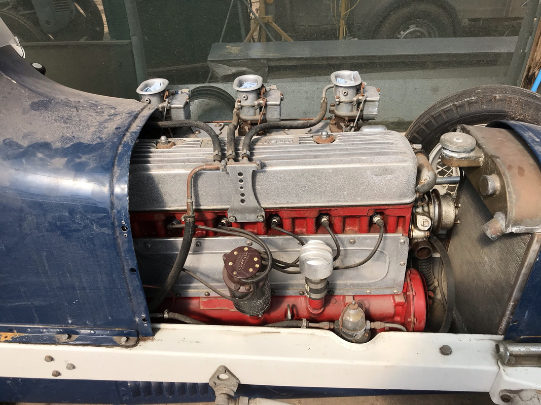

    I have recently acquired this car and am starting to try and learn a little bit about it. There aren't too many of these over here in the UK.
    It came over here in 2000 and was purchased from James Etter at Hershey in Pensylvania according to the little bit of history I have. It was originally fitted with a V8 (I guess V8-60), as there is a spare side panel for the RH side of the hood, with an exhaust cutout. It has an in-out box and (unbranded) quick change rear end.
    The motor is a 270 GMC with a howard intake and scintilla mag, unknown internals.
    The fuel system is interesting as it looks like the mechanical pump on the motor is just being used to presurise the fuel tank rather than drawing fuel through it. I ***ume the hand pump is just there to prime for starting.
    I don't even know how you are supposed to push-start these things without a clutch. I guess just drop it into gear, prime the fuel, switch on the mag and push like hell?

    Little Terry : suggestion for starting : put in gear, push until OIL PRESSURE COMES UP, only then turn on the mag switch. That way you won't be starting on "dry" bearings & will have built fuel pressure as well.

    If done correct the carbs are built for alcohol or methanol. Pressure hand pump was needed to help the stock pump. The stock pump will run gasoline 3-2’s with no sweat but gasoline fan way to hot for the little radiators. That’s a really cool vintage racer..

    Thank you. How can I tell what fuel to run - is it just by looking at the jet size?

    We might have used the stock pump to pump gasoline, but for methanol switched & used it to pump air into the tank, as the stock pump usually wouldn't p*** enough volume (methanol needs approximately 2x the volume of gasoline) to feed the carbs, besides, Methanol tends to rapidly deteriorate the pump diaphragm material. If this vehicle ran Methanol(quite probable, considering the layout) the carb jets will be appreciably larger than "stock" : I would suggest carefully dis***embling one of the carbs & comparing the jet diameter to whatever is listed as stock : if it's much larger, probably methanol, if close to stock, probably gasoline. ENJOY THAT BEAUTIFUL CAR!!!

    Yes, but more importantly, hold the outside brake lever to apply rear brakes until push vehicle gets forward momentum and then release brakes. Otherwise just pushing from a dead stop will create a huge chatter that will tear up your quick change and/ or drive line.
    Incidentally, if the car had a V8 in it at one time, it was likely a larger Ford, not a 60.

    Most usually, the mechanical fuel pump was used to pump air into the fuel tank to pressurize it while running. The hand pump is not a primer but the initial pressurizer of the tank before engine start up, about 3-4 psi. Most cars had only the hand pump and required the driver to stroke the pump 3 or 4 times a lap.

    Thanks guys. Carb jets are 048, so larger than I would expect for a gasoline motor running a 3x2 setup. I will get hold of some methanol and see how it runs.
    Next issue - there is no fan on the water pump and I dont know if it has been removed or was never there in the first place - does anyone have any examples of the cooling systems on these little racers?

    No need for a fan as when you are running on the track your forward motion will provide the cooling air. It may be important in some cases to be certain no air entering the grille is by-p***ing the radiator through openings around the radiator.

    Be careful here. Jets in a carburetor for gasoline are sized to provide a fuel/air ratio of 14.7:1.
    Multiple carbs do not normally create a need for a jet change. Running methanol for it’s ability to handle 15:1 compression ratios without knock and it’s cooling effect on the air charge in the cylinder from it’s latent heat of vaporization, requires a 6.5:1 fuel/air ratio and much larger jets. Ethanol is 9:1
