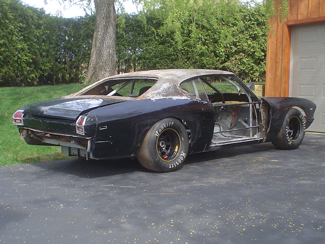

    Wow!....already a thread for my car on this site...how cool is that!....I always have to start a thread....
    Anyway 1999 Hutch Pagan Winston Cup Intermediate Monte Carlo....69 chevelle body.....will start out as a track day roadrace car, eventually be made street legal.
    Had the first car in the 80s...Loved it....350, T-10, cut fenders and springs, 275 50 15s on all corners....slid off the road and totalled the car (hey I was in my 20s) always said I wanted to do another so here we are

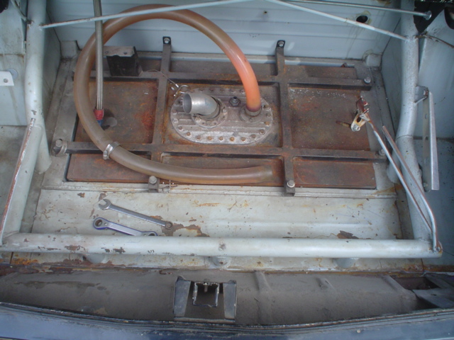

    more....have to take it to a nearby race shop and have the oval set up taken out of the front end and a street/roadrace set up installed so I can place the left front fender properly and continue with the body work....the left side wheelbase is 1.5" shorter than the right.

    heres some new pics.....changed the leftside upper A arm, played with the lower eccentric adjusters and have the left side wheelbase the same as the rightside now....this allowed me to get the leftside fender on. Got my new 2" offset wheels, got some tires mounted and got some shots....I like the way the tires stick out past the fenders more...gives the car more attitude
