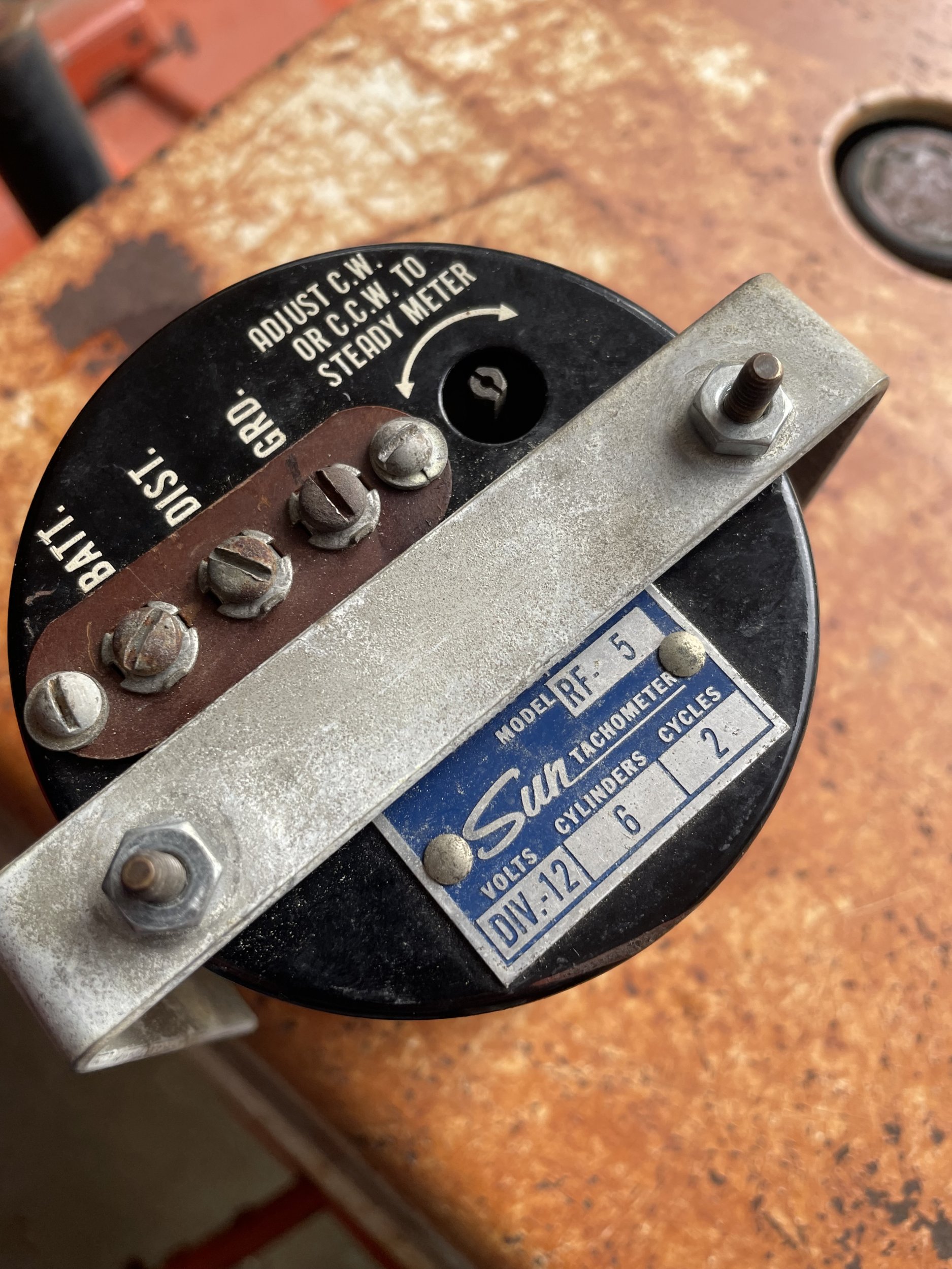

    Gents, found this vintage 6 cylinder Sun tach on EBay. Would like to find a steering column mount housing for it. Seems deeper than most of the housings I’ve seen. I’m hoping that a housing does exist for this model?
    Shows model RF-5 on tag rear of tach.
    Thanks!

    I can't help but doesn't it also say it is for a 2-cycle? Like for a 6-71 Diesel or a 2-cycle outboard marine engine?
    If that's the case it may read only half engine speed on a conventional automotie six cylinder.
    EDIT: I know most diesels don't have coil ignitions. They may have tach signal generators.

  4. THE FRENCHTOWN FLYER
    Joined: Jun 6, 2007
    Posts: 6,116
    from FRENCHTOWN
    Additionally, the fact that it is an 8-grand tach would seem to suggest its for a 2-cycle six.

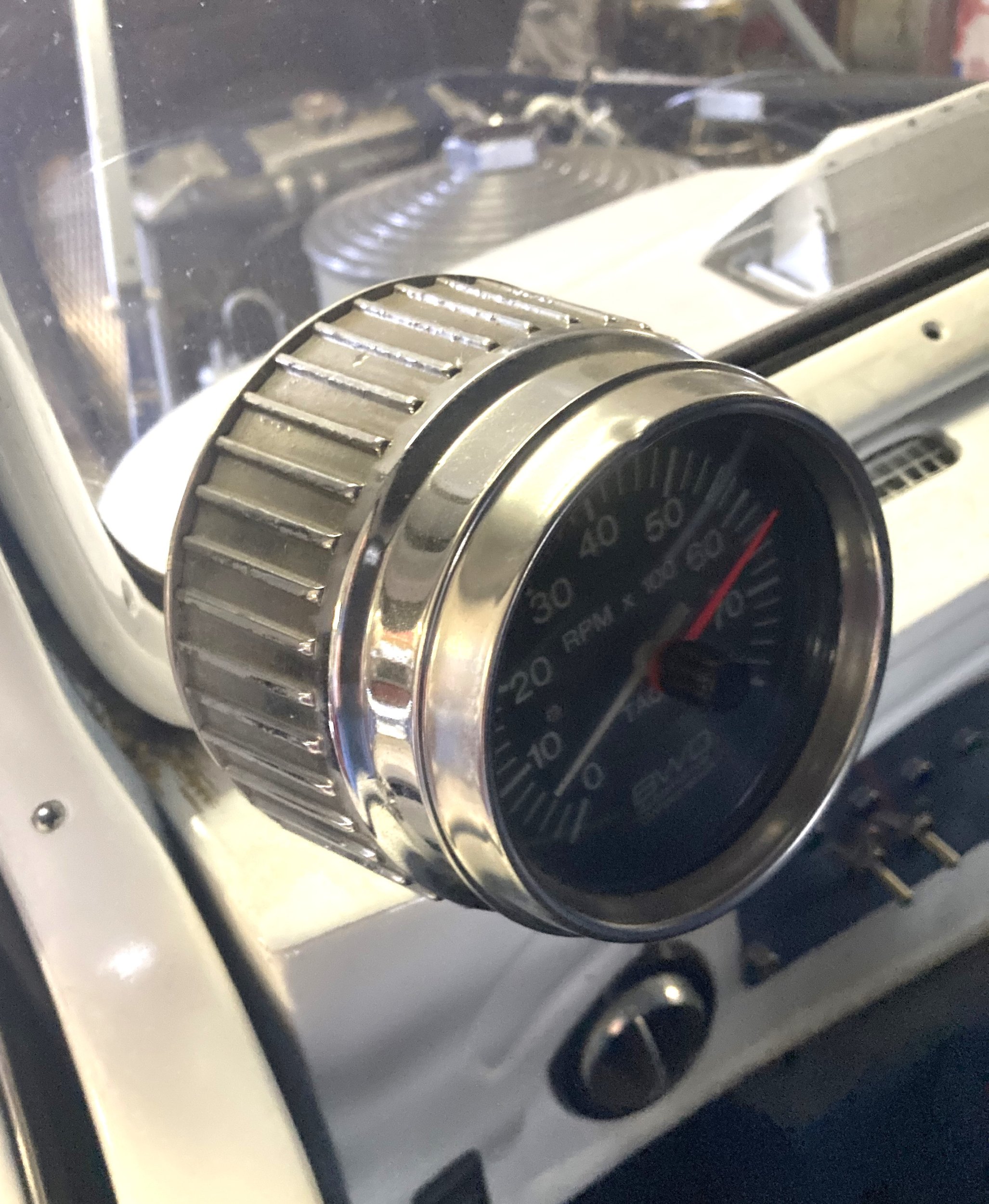

    Alternative tach cup...
    Okie Pete and saltflats like this.

    Jokester, what is the source of your alternative tach cup?

  8. Jokester
    Joined: Jan 29, 2005
    Posts: 807
    Jokester
    Junkyard! Pretty sure it's a Camaro or Nova rally wheel cap.

  9. deathrowdave
    Joined: May 27, 2014
    Posts: 5,067
    deathrowdave
    from NKy
    Looks like Chebbie Rally Wheel center cap

  11. THE FRENCHTOWN FLYER
    Joined: Jun 6, 2007
    Posts: 6,116
    from FRENCHTOWN
    I think the first thing I'd do is hook it up to an engine - any spark ignited engine - and see if it works. Depending on the number of cylinders and the needle movement you could see if it works and if it is relatively accurate.
    Doing this in a car with another tach wired in would be a plus.

  13. Timchek
    Joined: Feb 24, 2024
    Posts: 71
    Timchek
    Yeah, looks like I’m gonna havta make sure it works first on my car! Not a two stroke!
