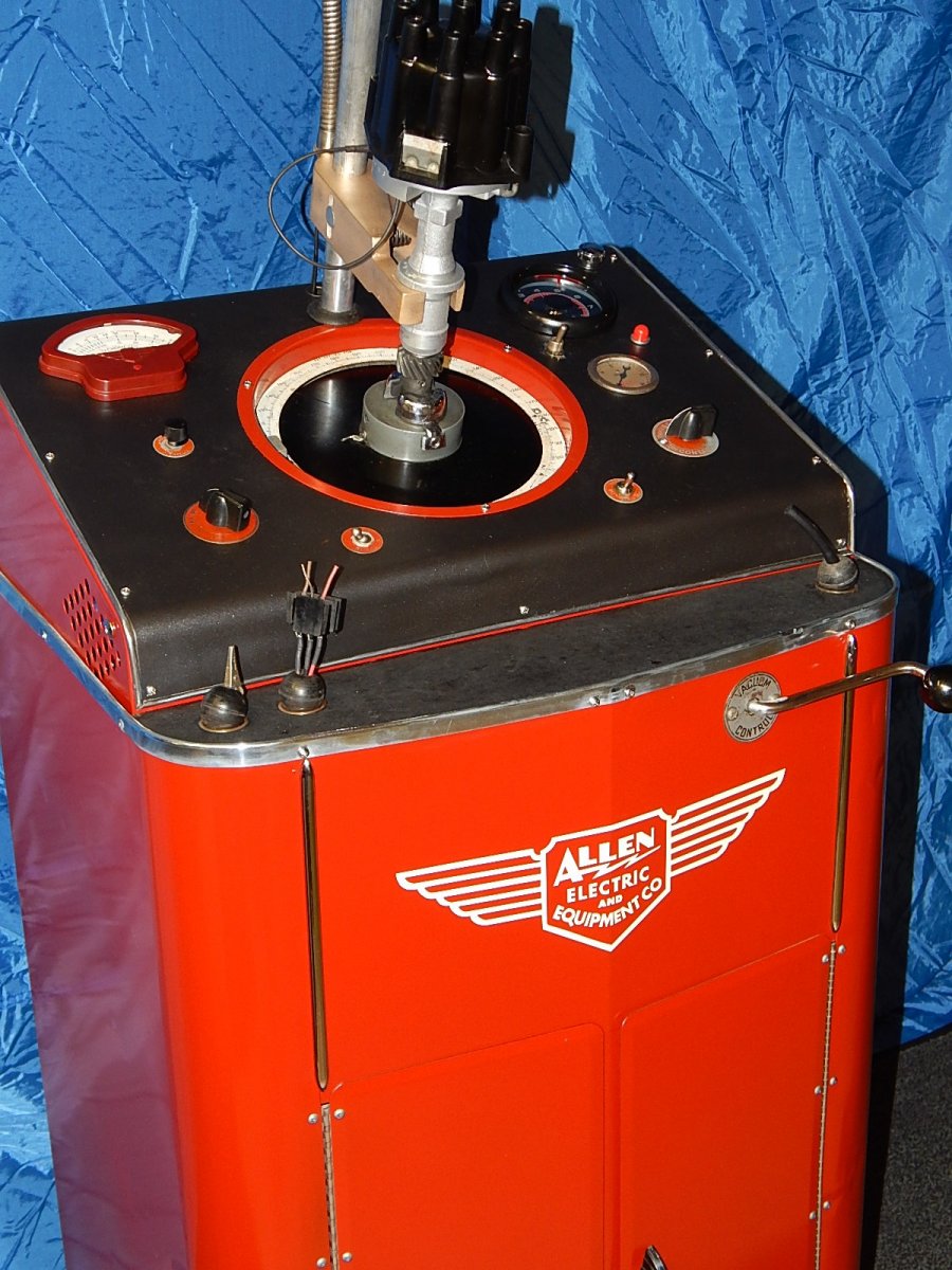

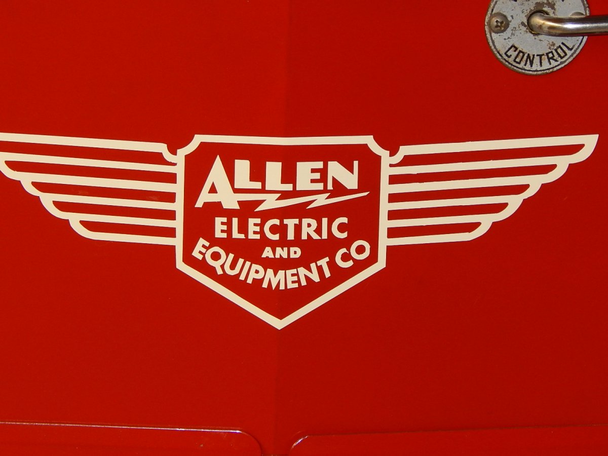

    Here is my dad's old Allen distributor machine. The tach didn't work, so he improvised.

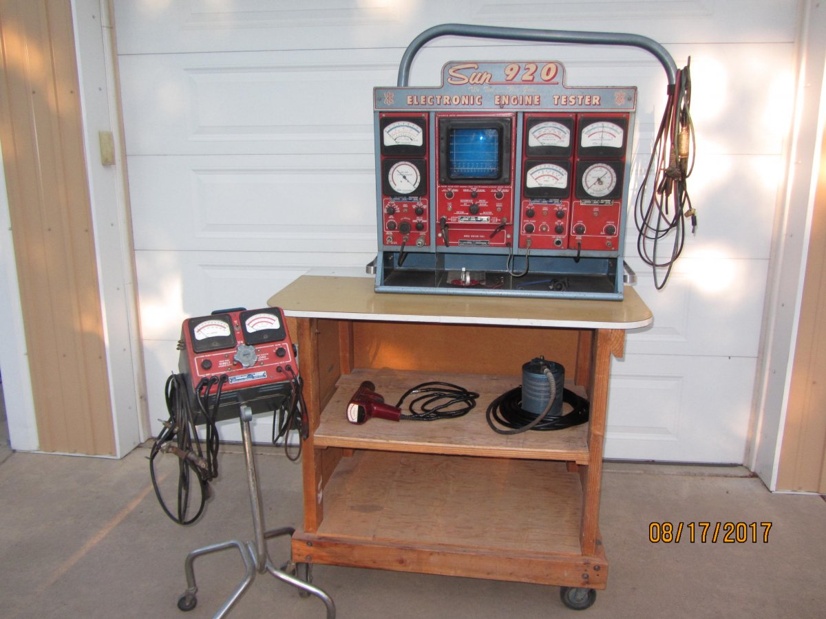

    These are certainly nice pieces of test equipment. Unfortunately I do not have a manual for the Sun 920 but I did find a manual for a VAT-20 which appears to have the same features as my VAT-26. The operation of these is pretty straight forward and I have owned and operated these since 1983 without a manual. If you know of a manual I would love to look at it and see if there are engine diagnostic steps spelled out.

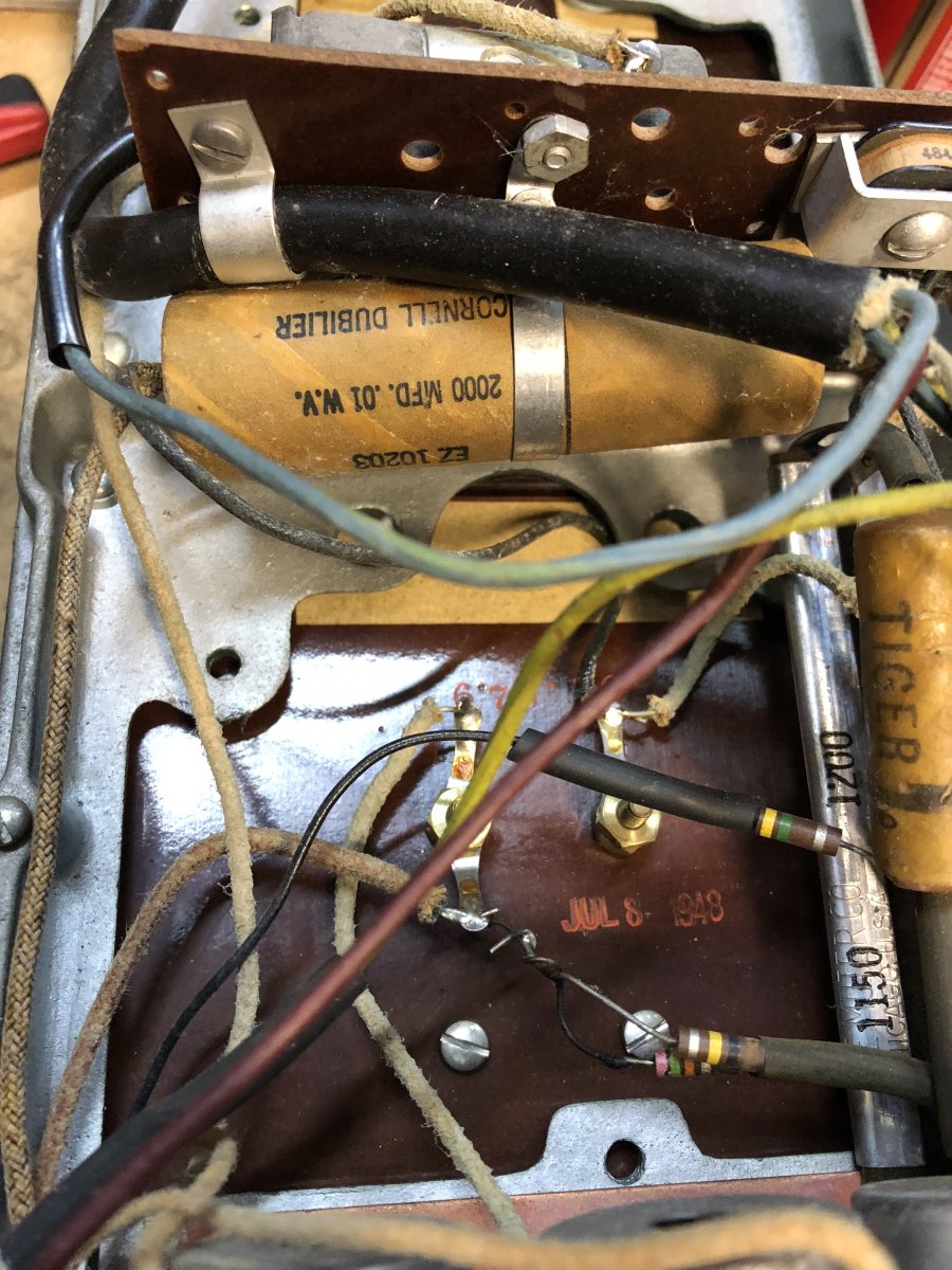

    The important thing is never operate or even plug in the unit unless and until the DC power supply has been squared away. The electrolytic capacitors and waxed paper coupling and byp*** should first be replaced, along with any resistors out of spec. Vacuum tubes and other components are pretty rugged in these applications but they will get smoked drawing excessive current if this is not done. AC transformers are sometimes proprietary and $$ if you can even find one, except maybe by cannibalizing another unit. Maybe you know all this already, but I'd hate to see a cool unit get trashed! "Plug it in and see if it works" is really bad stuff on vintage electronics.

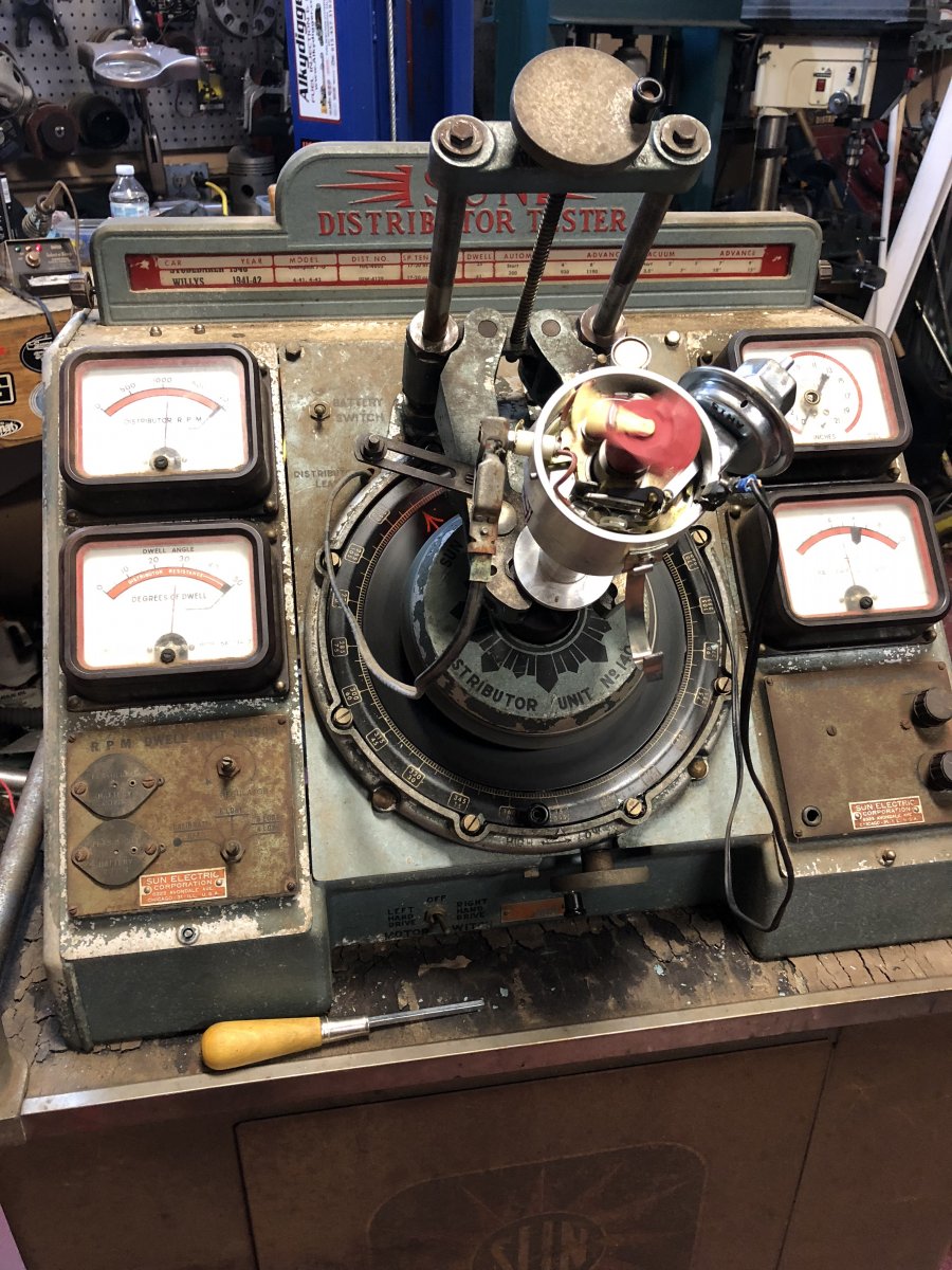

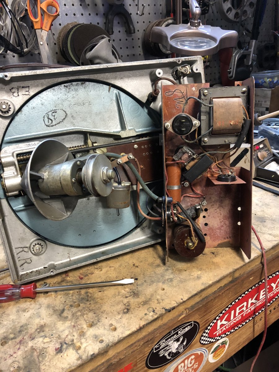

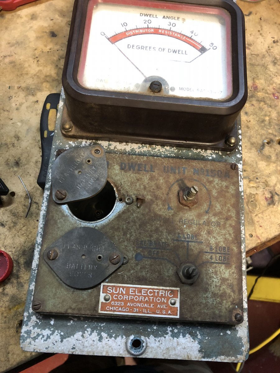

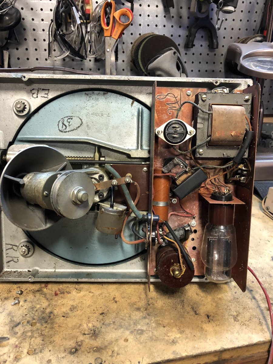

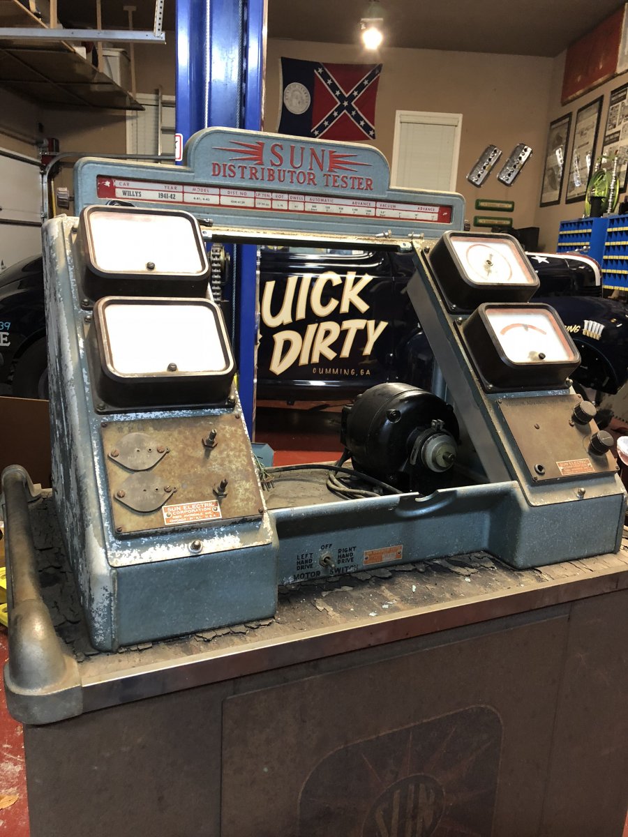

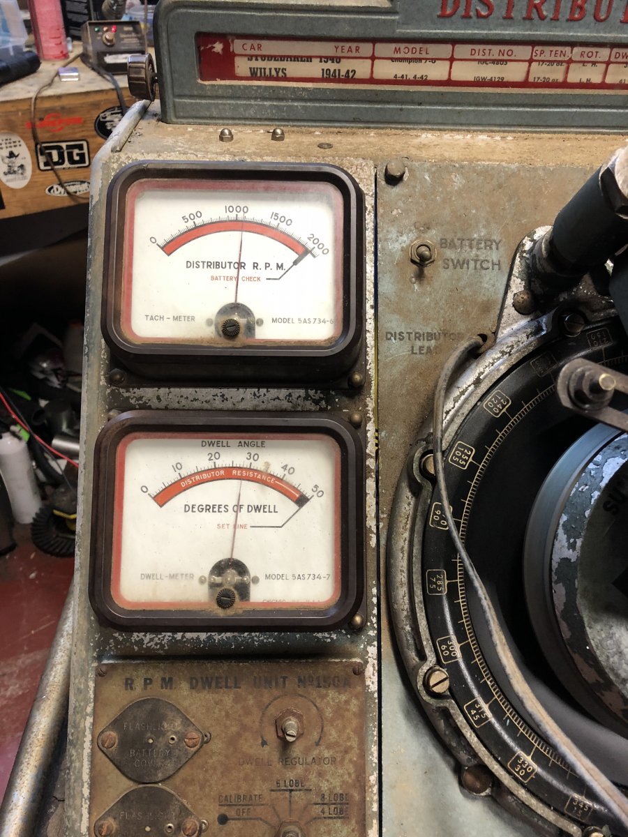

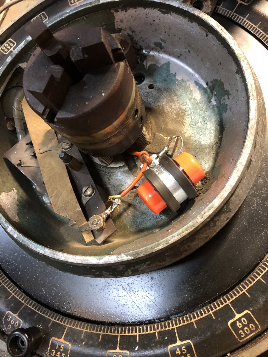

    Working on this one that belongs to @chopnchaneled today. Its running now but the dwell and RPM meter need new caps. After spending this much time on it, hate to not sand blast it and restore it all the way ....

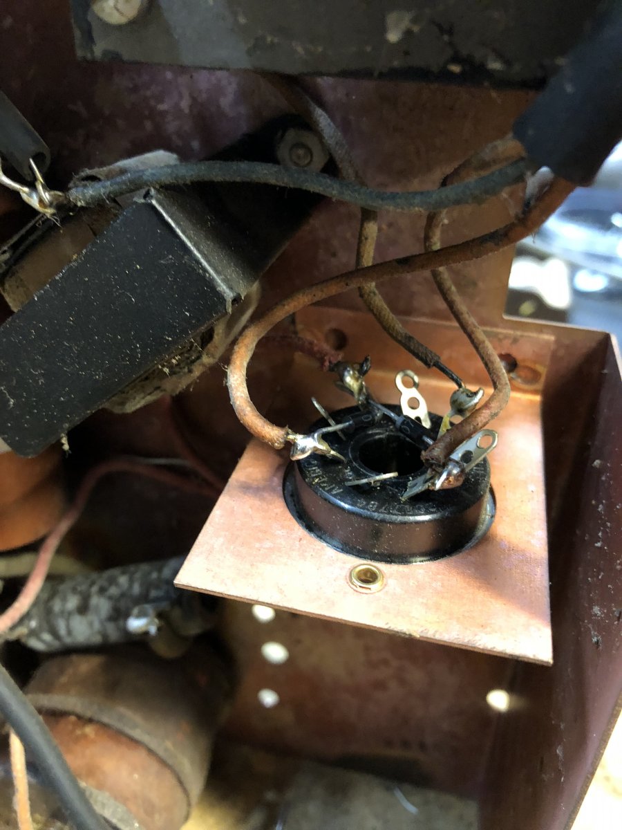

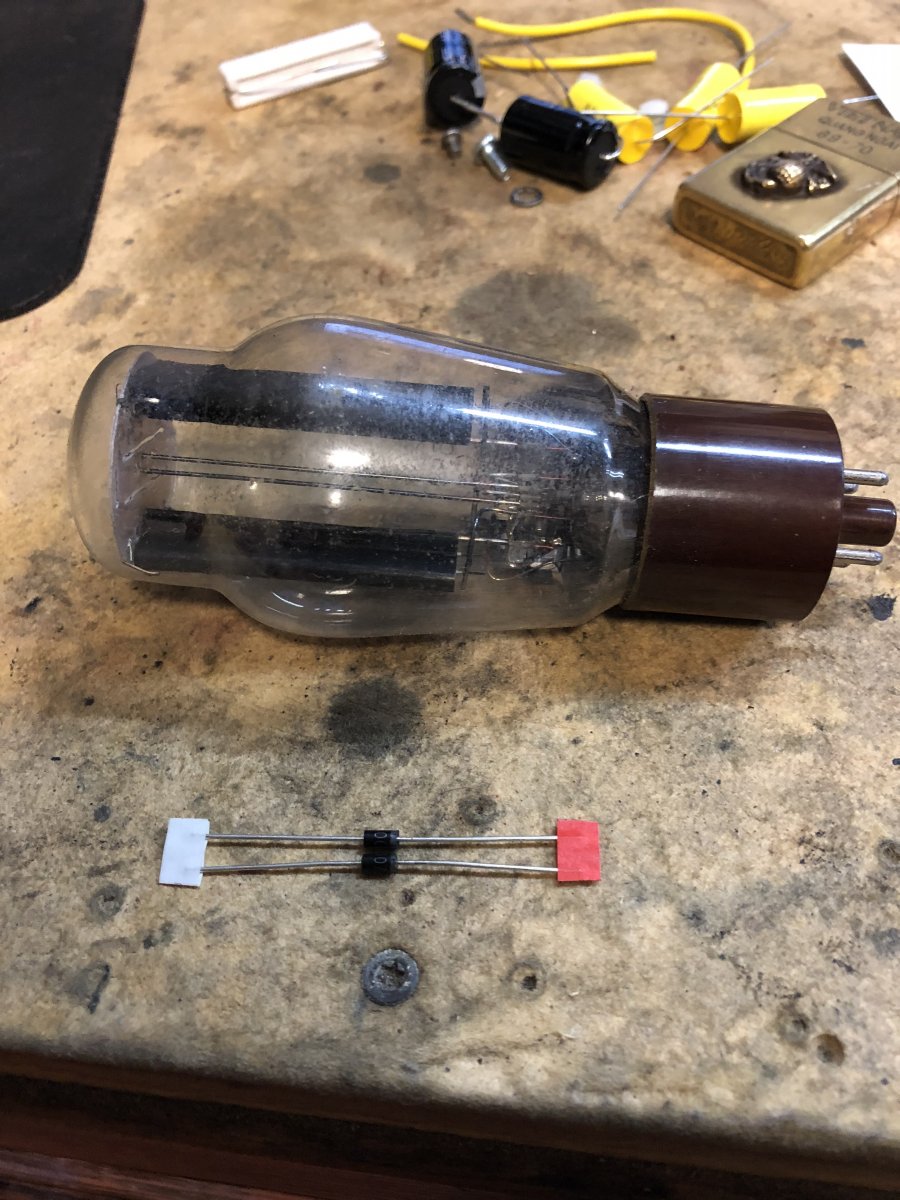

    This is how silicon diodes changed everything - 2 little diodes compared to the equivalent tube diode

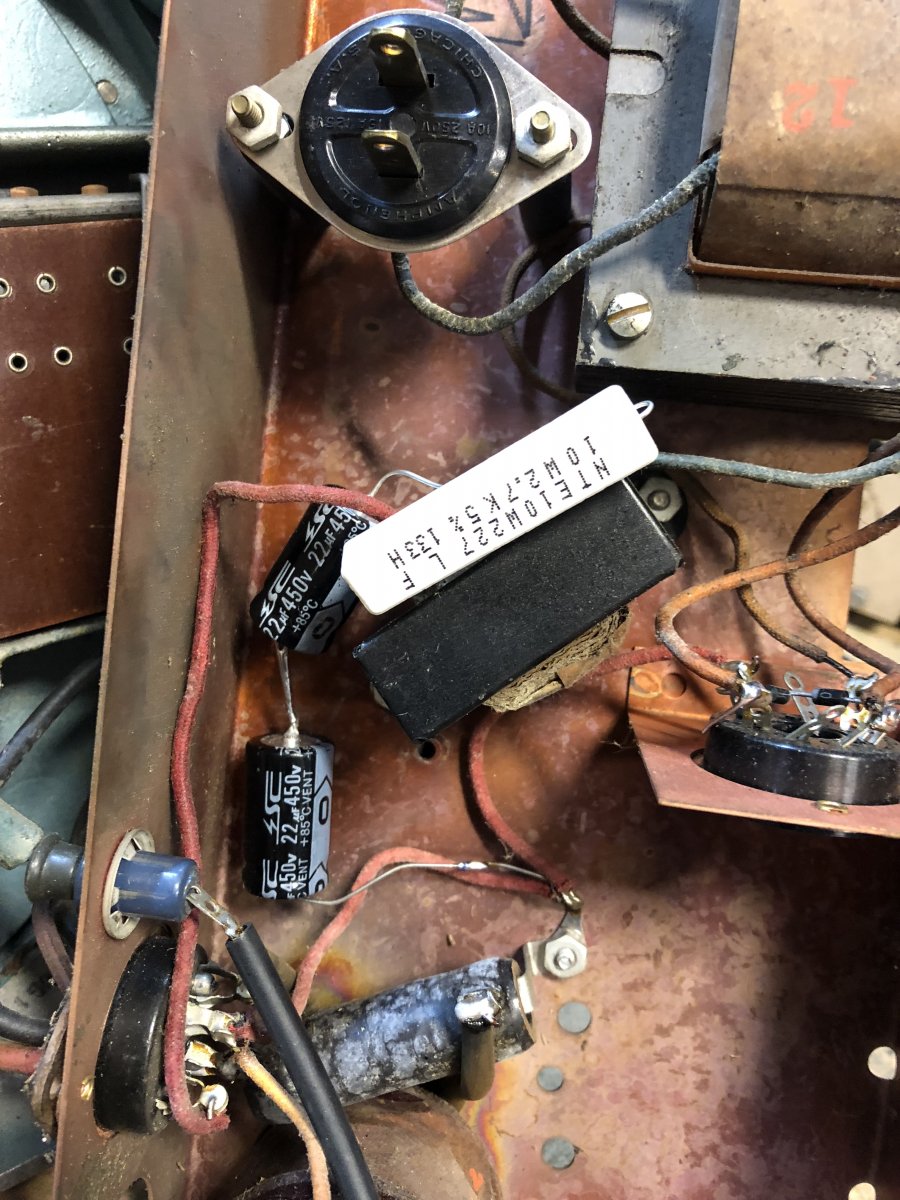

    Replacing the tube with 1960's diode technology

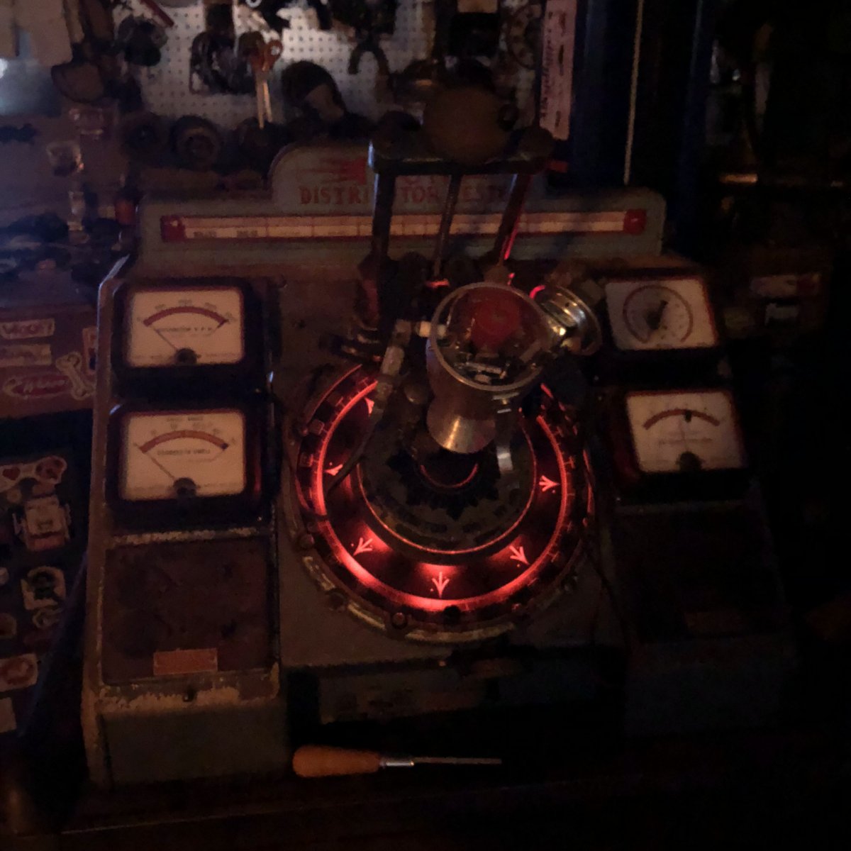

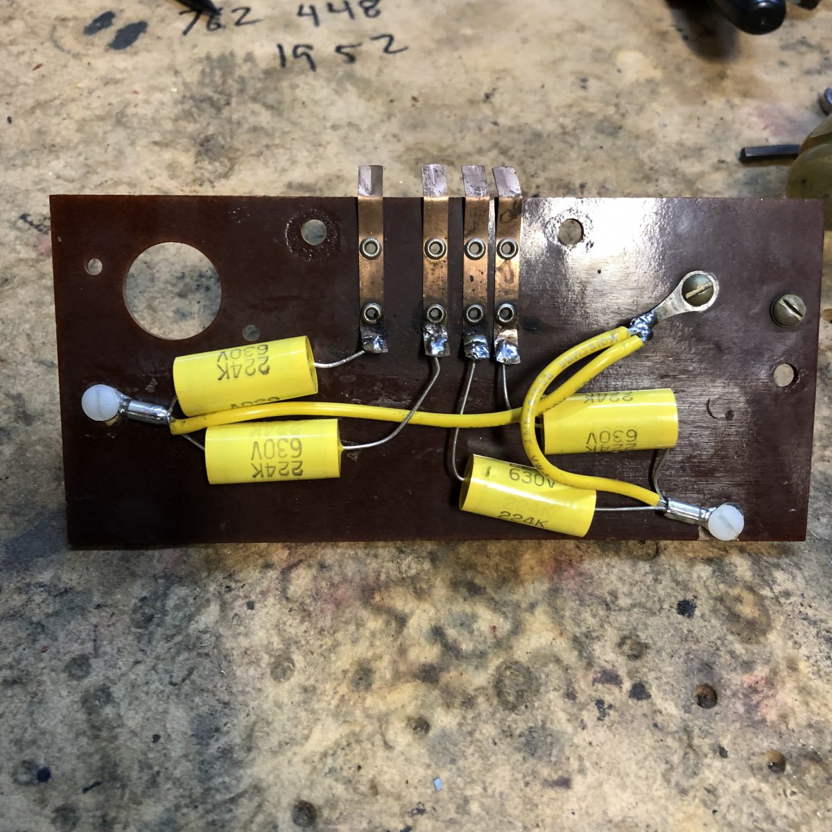

    The dwell meter is still off - needs caps

    Right, but that tube would last practically forever in that application wouldn't it? At least with fresh power supply caps installed. Tube rectifiers are slow to ramp up voltage too, sort of a "soft start". Semiconductor diodes are instant on, though maybe it doesn't matter here. I'd have left it just because. Thanks for the pics!

    The diodes come with the kit - didn't really think about leaving it in place but I guess you could. The 6v battery that was used and has some external alligator clips, was replaced with a laptop battery charger. I don't have a schematic for this one, was wondering if there's a way to eliminate the 2 D cell batteries in the dwell and tach.

    I'd bet a set of good quality flashlight batteries would last about forever in that application. The "Industrial" type. Getting harder to find commercial alkalines that won't leak though.

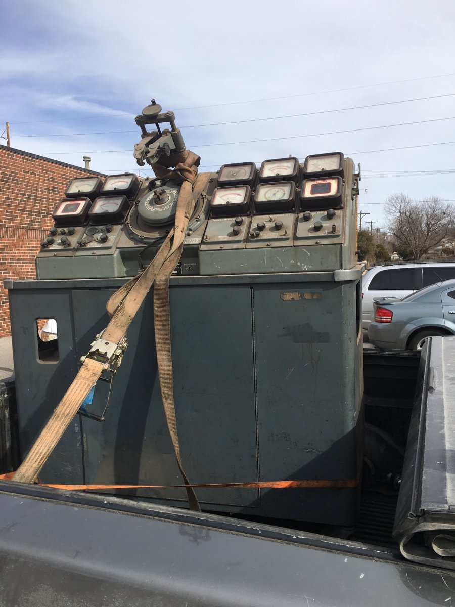

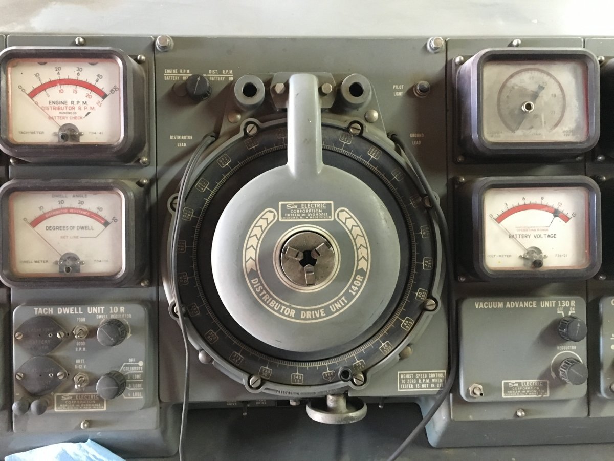

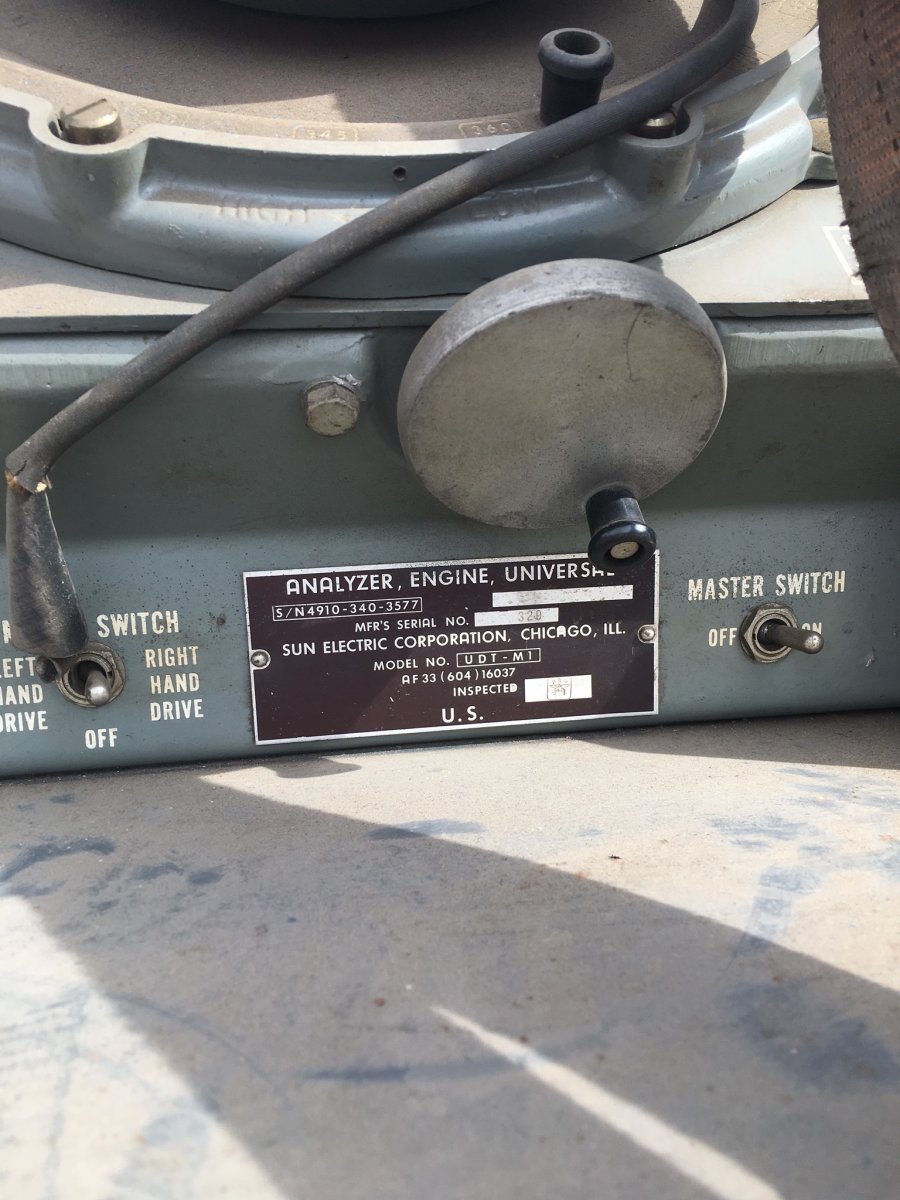

    32AB3D46-87C7-48E2-8C41-C2AB10FEC5F6.jpeg EBADF646-F7FC-4991-92DC-36B6DCC5A8E3.jpeg 9C0CC659-F69B-44FC-8C37-2AA0E46DE712.jpeg 2FE5006B-2151-4DC6-9087-BBCF9ECF06B6.jpeg 9183E478-381E-4B38-8703-DDD74FAC64E6.jpeg This is the machine I picked up a few weeks ago. I’m in the process of cleaning it up. It says the model is a UDT-M1. I believe it is from 1958. My plan is to use it but I have no manuals. I’ve seen several people on here that might have a manual that could be close. I think I may have to have a MDT manual for the distributor part and an engine ****yzer for the other parts but if there is anyone that can help I could really use it.

    That looks like a military one, impressive machine for sure.
  17. That is a machine with great potential. I hope your restoration goes well. I have some information for a much smaller Sun machine, and although I doubt it would be helpful, I would have no problem sharing it.
    Bob
  18. If you are having a problem obtaining components, I have a lot of pulled military grade high voltage electrolytic capacitors. I also have a bunch of octal tubes. If you need something like that, I might be able to help you. I have the ability to check the components, including a mutual conductance tube tester, so there would be no guess work as to the quality.

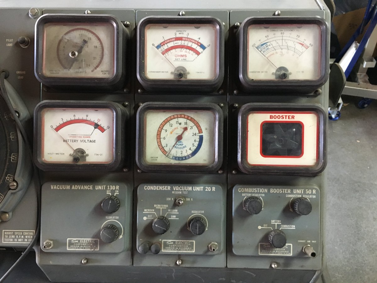

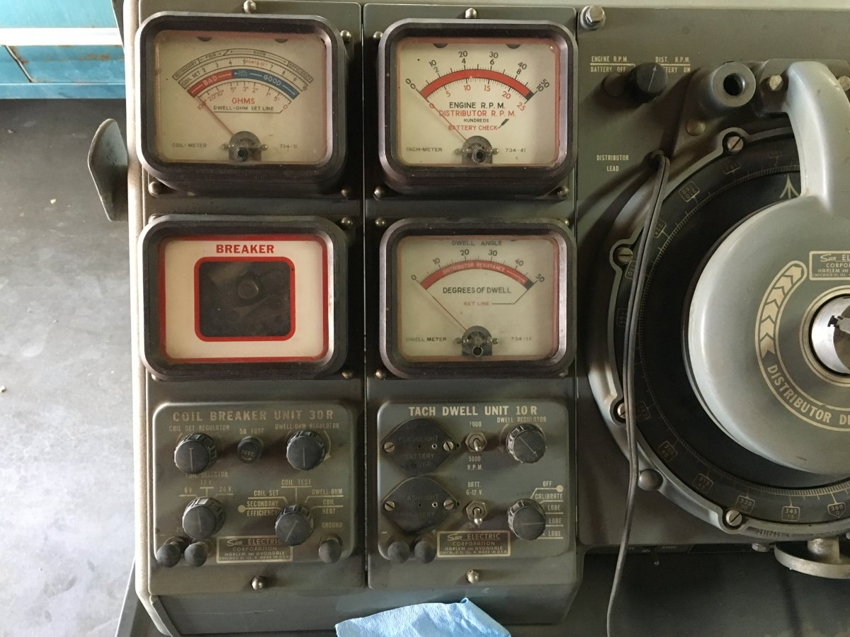

    Well I can sort out most of the knobs and dials on this machine, but do you have any idea of what the function of the "COMBUSTION BOOSTER" is? o_O This rig has about three times as many gauge modules as most distributor machines I've seen or laid hands on. :rolleyes:

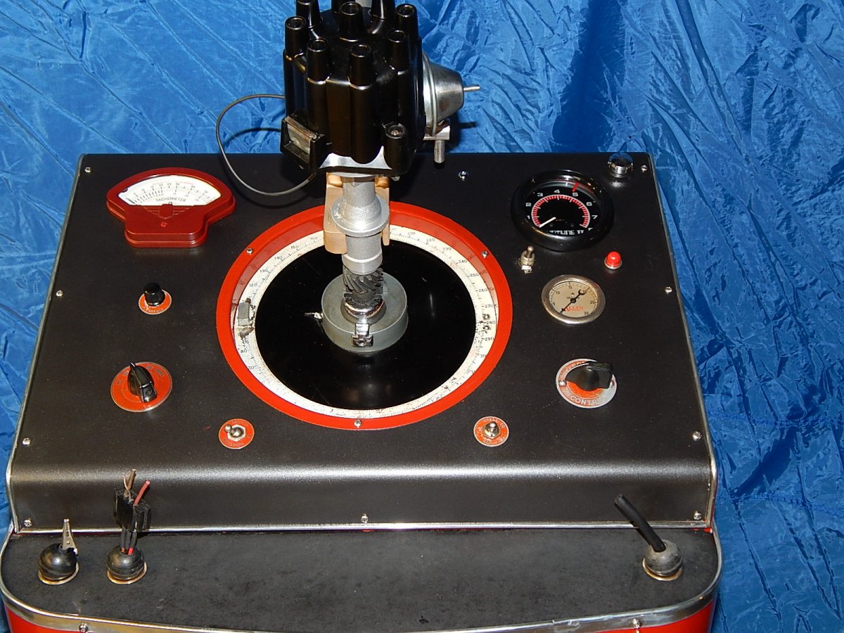

    The combustion booster has a probe/sniffer that slides in to the tail pipe for lean/ rich. If you have all the parts and it works, it’s kinda handy to use.

    Thanks for the added info and for making me go back and look things over more closely. :rolleyes: Looking at the above pictures again, that's starting to make some sense. The lower combustion Booster panel with the knobs on it also has what appears to be a hose port for the tailpipe probe or sniffer. The panel above that looks to have a small fan behind the gl*** window which could supply a vacuum source for that hose port.
    The gauge at the top of the stack is hard to read but I think it says "Combustion Efficiency" and the scales probably read HC and/or CO. This setup would give you a distributor machine with some of the added functions of the full size Sun Engine ****yzer, but without some of the bulk of the big-*** scope module and all its controls.
