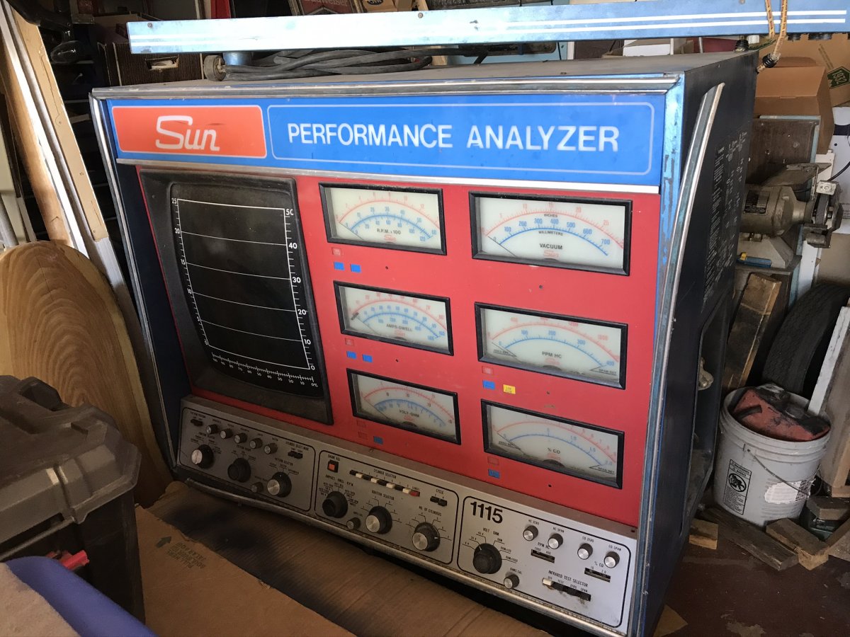

    I bought this slightly damaged 1115 from my local Ford dealer for $50. It's been dropped but the scope and major gauges work, and it came with a bunch of adapters so I can even test the HEI on my OT Firebird. It takes up a lot of space for something I only pull out every once in a while, but it looks cool and I use the "not original to this huge machine" cabinet to store all my shop manuals and other test equipment.

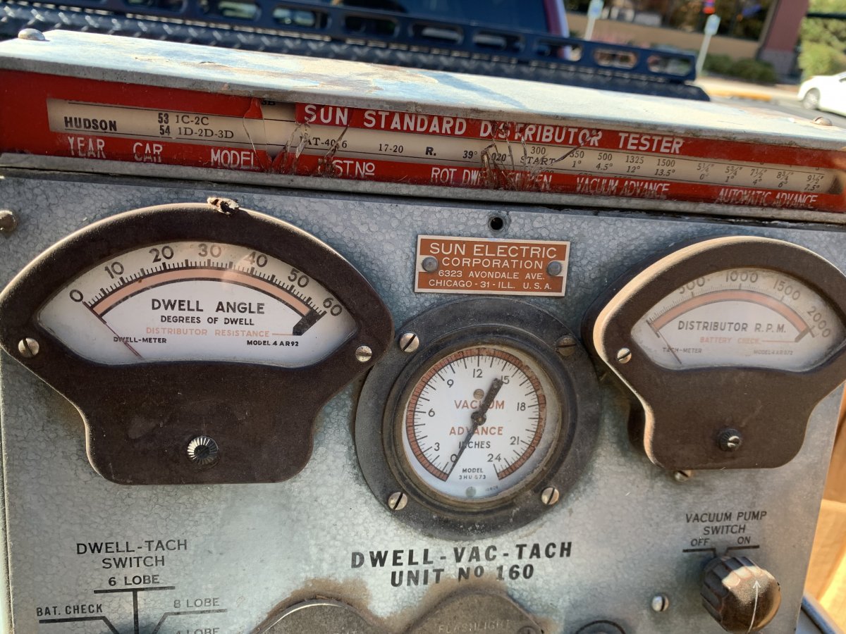

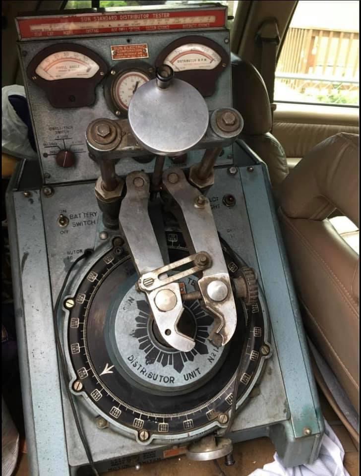

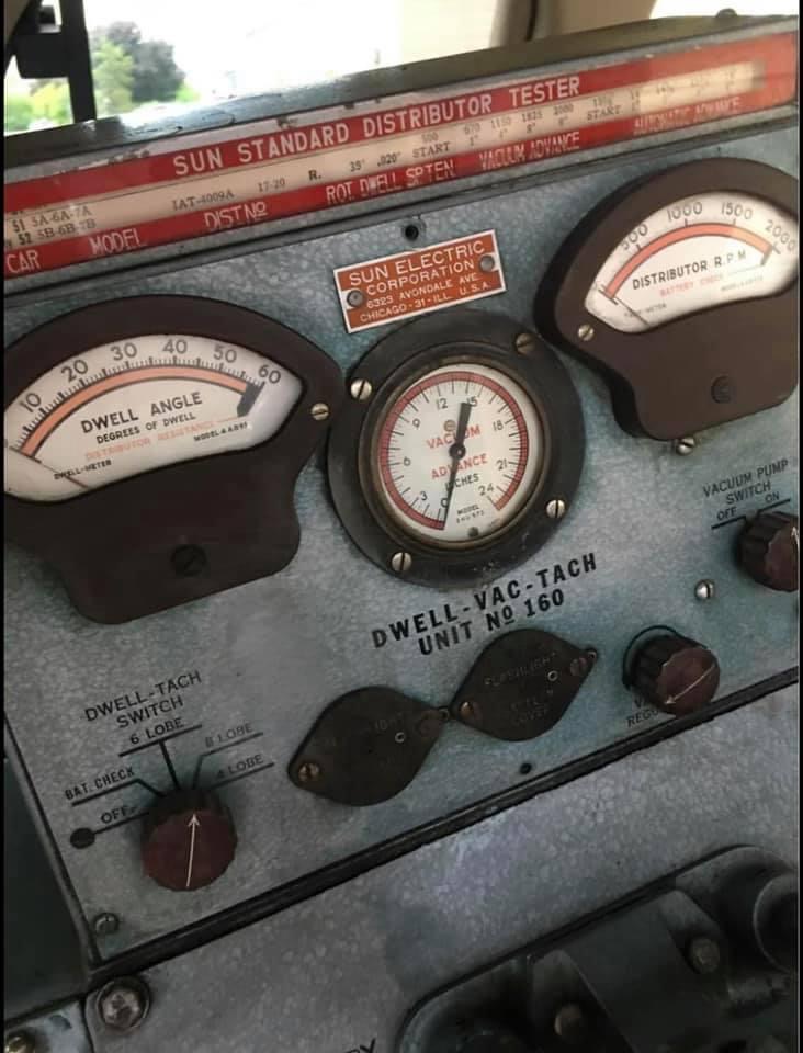

    Just bought this sun model 160 distributor tester. I can’t find any info for this model. Anyone have some? I already know I need a new 1/4hp electric motor for it

    ^^^^^^^^^ Have you tried Paramountd.com ??

    I did, he said he doesn’t really deal with the early models like mine, and he just strips them for parts and **** cans them. Wasn’t overly helpful, but did answer a couple questions.
    really what I need right now is some pictures of how the 1/4hp electric motor is setup underneath on these and what sizes drive pulley I need. Then I can start figuring out the rest. I’m going to get this one working I only paid $100 for it so I’m not into it deep. And I’ve always wanted one of these things usually they are crazy expensive around here which they never seem to come up for sale.

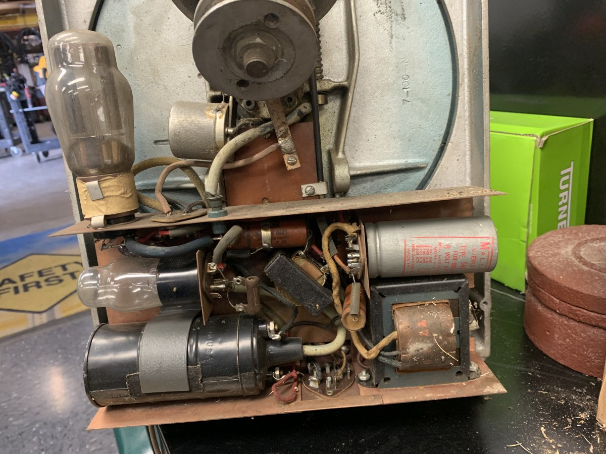

    Thanks! Want to help me recap this thing? I don’t know **** about vintage electronics but this thing looks just like one you have already done.

    If it was me - all those brown and tan tootsie roll things are probably caps and will have a number on the side. Its been a while since I bought loose caps but Digikey is a good place. That big silver thing might be a cap also. Any cap that has a + sign is electrolytic and the ones without a + are just basic caps. Don't mix them up or put the electrolytics in backwards BOOM hahaha.

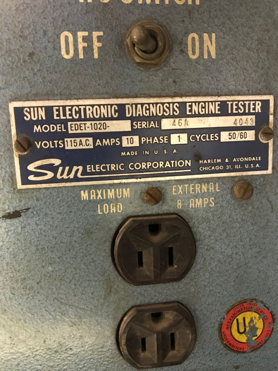

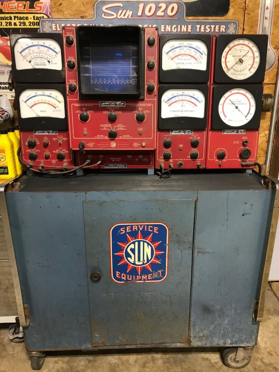

    I just purchased this Sun 1020 and was wondering if from the serial number it's possible to determine the year of manufacture? Thanks for all the info I've already learned, and in advance of any more you guys can offer. Sun 1020 1.jpg Sun 1020 2.jpg

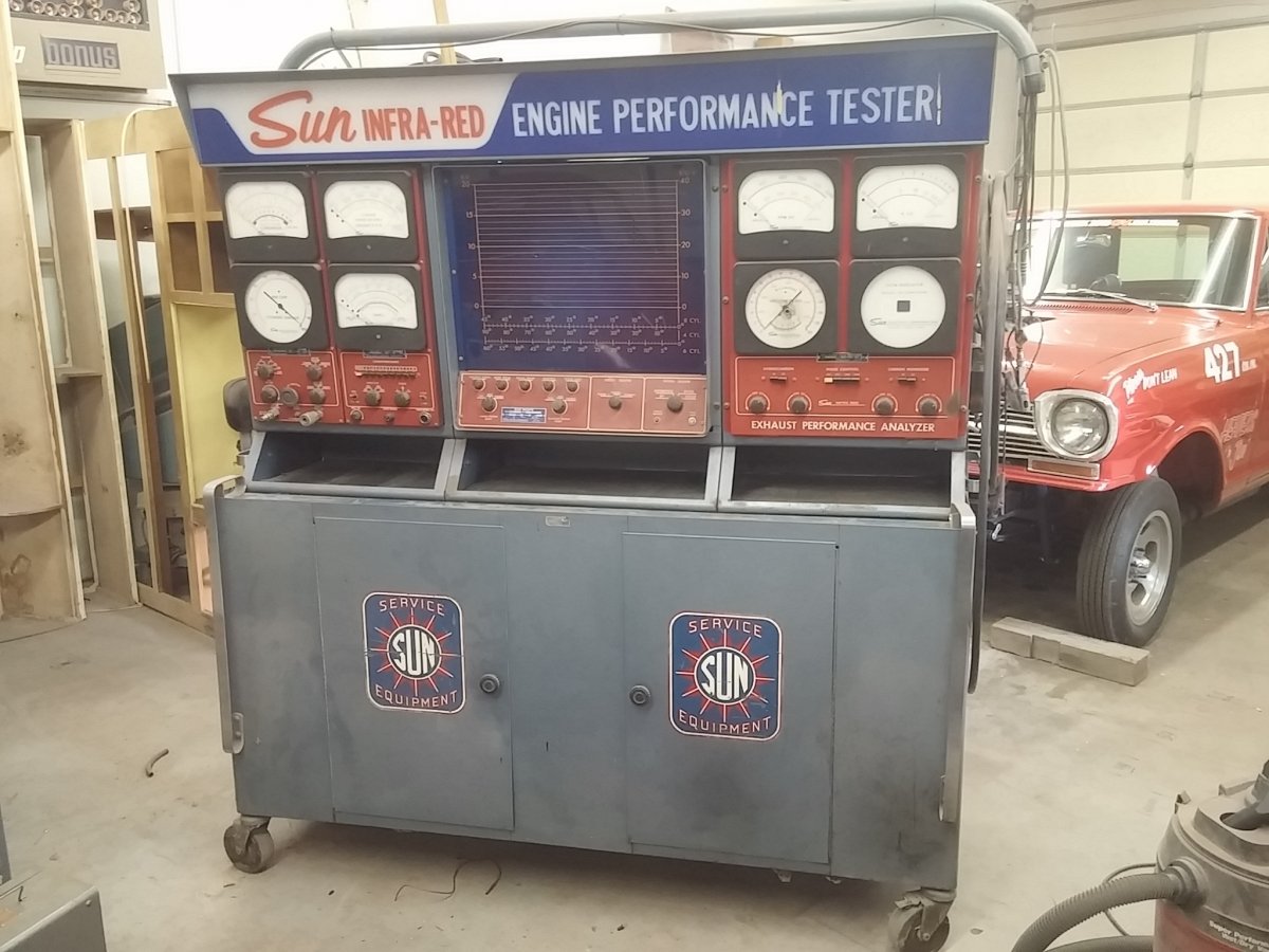

    I just picked this up. It a little rough but it appears as if everything works.
    All of the tubing for the sniffer is dry rotted and broken and will need replacing. And its missing one of the filter cups for the sniffer system.
    I'm also missing the timing light and the main amp lead. Does anyone have a manual for this machine, or any ideas on where to get leads, parts, etc.

    Your shot of the I.D. tag shows Sun's address as "Chicago 31 Il.". 31 is a Postal Zone code, part of the Postal Service's system of mail sorting. The Postal Zone system was replaced in July 1963 by the 5 digit Zip Code so your Sun tester probably at least pre-dates that.
  28. I got a reprinted manual for my similar machine on eBay.

    Thanks. Yea, after posting this last night I saw that there was a guy on Ebay offering the manual in .pdf format.
    Another question;
    has anyone ever converted a stand alone timing light to one used with the engine ****yzer? I'm thinking that if you could find the right connecter to connect it at the swing arm on top of the ****yzer and get the wiring right it should work. Any thoughts?
