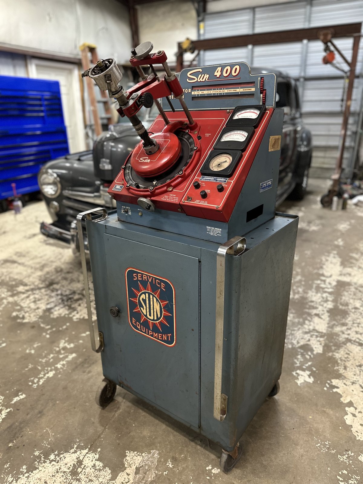

    I picked up this Sun 400 and cabinet.. unfortunately I gambled and it doesn’t work. The unit will spin the dizzy. No flash. And non of the gauges work .. I installed a D and AA battery in the panel. And the tach will pull the needle to the left when you put it into calibrate . Aside from Paramont , is there anyone who’s good with these to help diagnose it ?
    winduptoy and cactus1 like this.

  15. winduptoy
    Joined: Feb 19, 2013
    Posts: 4,180
    winduptoy
    Paramount was OK to deal with...I purchased some parts from him to fix my free machine....earlier than anything he had listed.
    The LED conversion is wonderful ....your old neon one probably is beyond repair.. the conversionn was pretty straight forward to install
    To get the tach to work you need to have car battery voltage in addition to the dry cells...
    I decided just to use an external tachometer that I had and knew it's condition. I had a very nice old 12V DC power supply that I use in place of the car battery
    His belt and drive wheel was good quality
    Good luck
    cactus1 and stillrunners like this.

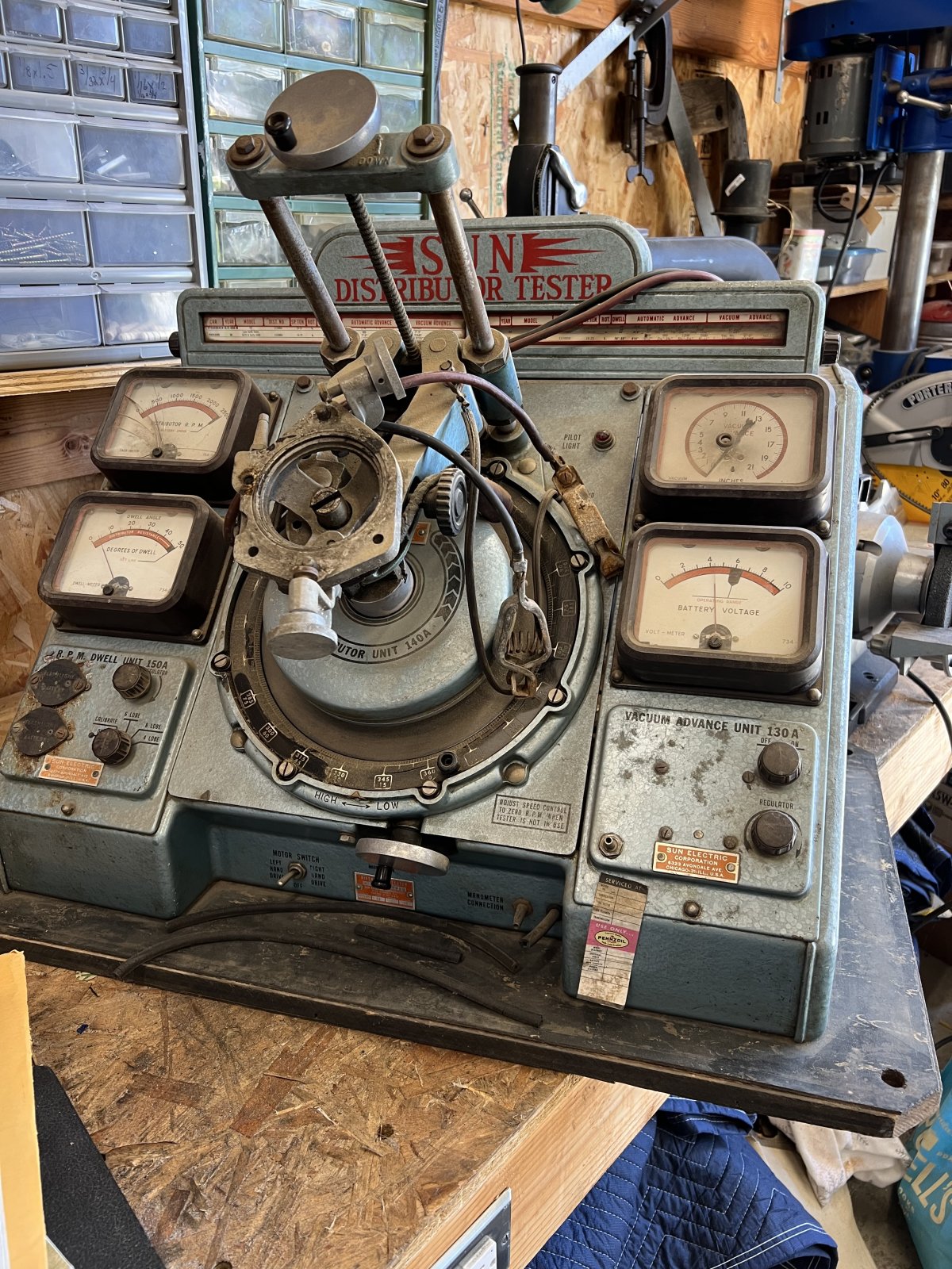

    I looked around for Rotunda and didnt find anything that matched. I have some information about operation of it and think I could figure the rest out. Looking more for some service information and wiring schematic. Not looking to "restore" it, just clean it up and repair the wiring that needs addressed. Here is a pic of it.

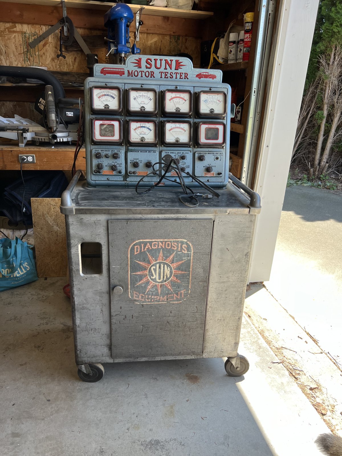

    Just adopted these two for winter projects. Anyone know what model as I have so I can find a manual for them?

    Hi Mike! Nice looking units! The model should be listed on the metal tags attached to the machines. The Distributor tester looks like a "MDT" that appears in the June 1952 catalog, and the Motor Tester appears in the same catalog as Model MMT - "Master Motor Tester". Here are the four relevant catalog pages:
    Interesting to note that someone in the deep dark past hand wrote on the Master Motor Tester page "1949 model". Also interesting to note that $750 in 1952 (the cost of the Master Motor Tester) is the equivalent of $8,900 today. That was quite an investment back in the day!
    Happy Motoring!
    ClayMart likes this.
