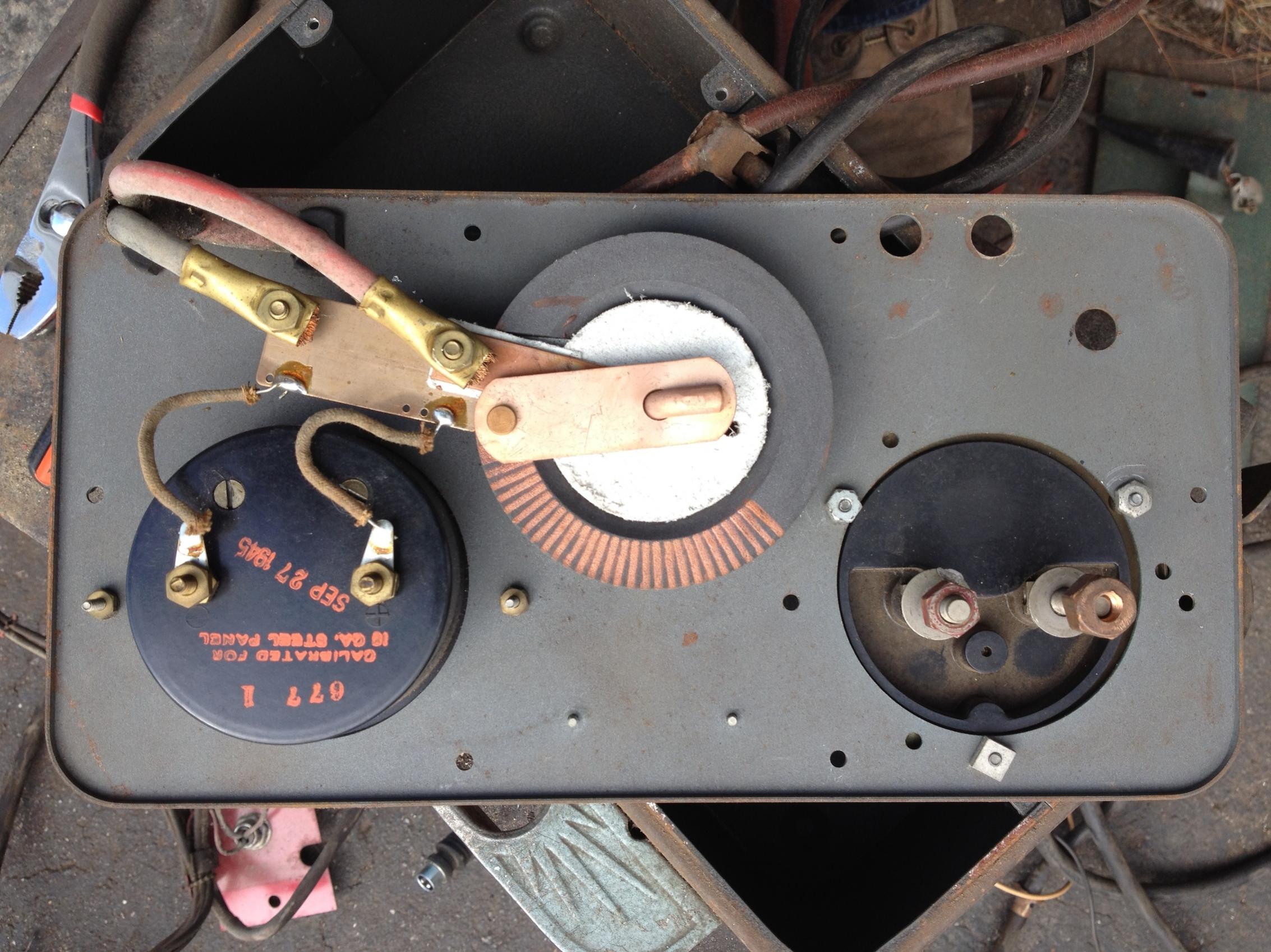

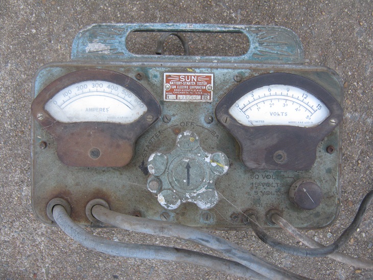

    I haven't tested it yet but it has cool graphics.

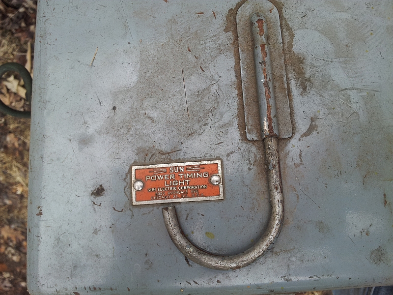

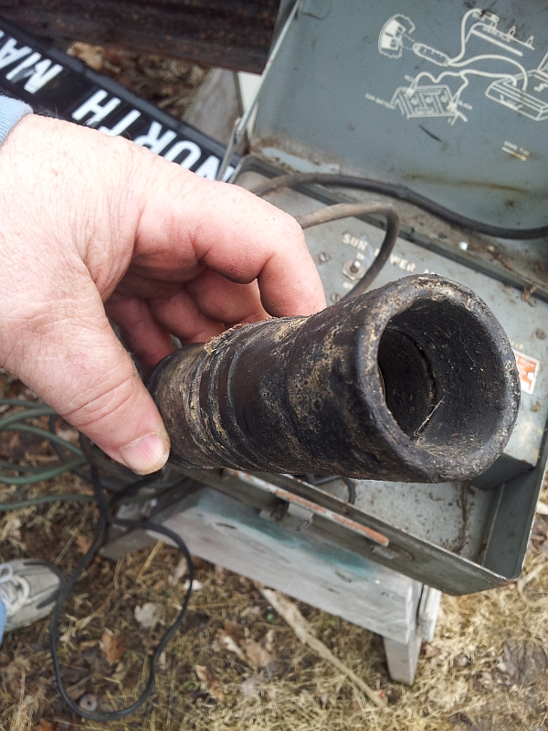

    Mike,
    does this look like the timing light you need? 4 wires but a self contained set. I think they were used in our military, so maybe easier to find than a commercial Sun timing light.
    only one wire to light, 2 to battery for power and one for the pick up. so looking at your pic it maybe a 4 pin but maybe only one wire attached??? I have part of a old sun machine in a shed but the power is out down there, wires came down in a storm, have not replaced them.
    it is surprisingly heavy!!!

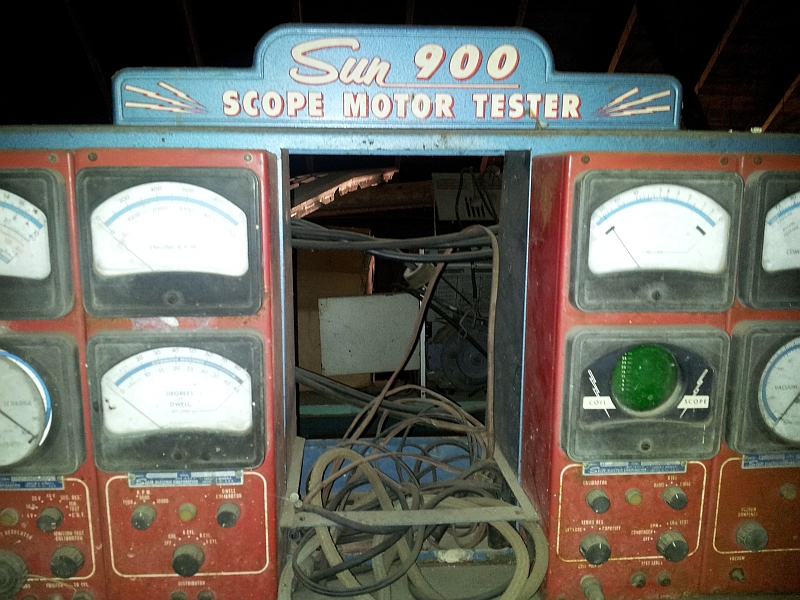

    Mike,
    Good news I have a Sun 900 in the shed, bad news no timing light!

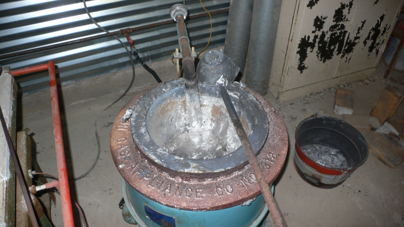

    I've got the aluminum and the casting equipment, need a real one to make up a pattern from. I can pour 12 lbs at a time via a ladle, 70 pounds in the pot. there is 3-400 pounds of ingot ready!

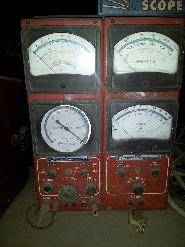

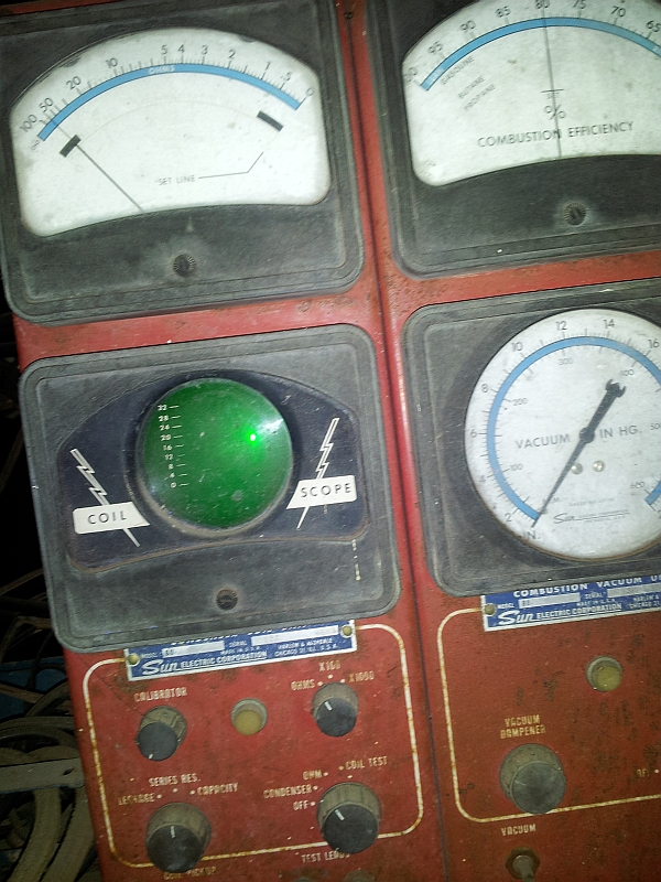

    so today i sacrificed a few sun machines.......I don't feel great about it but they were just to far gone for repair. I broke them down for spare parts.....i will post picture later

    Some picture from todays massacre

    oh ya and this sun tester was in a fire and has smoke and heat damage put provided some good spare parts

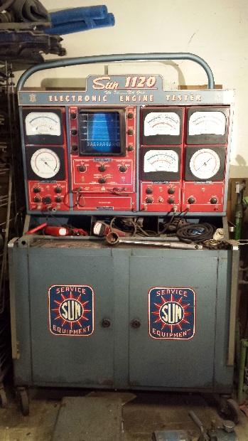

  28. Hey Johnny, cool thread. I subscribed when you started it as I have a Sun 1120 I bought a couple decades ago that I was hoping for help with. Everything is there and working except my scope. The screen glows when you power it up but I can't get it to draw a trace and the machine came with no documentation. I used to work on "computers" in the 70's so I knew about component level troubleshooting and replacement at one time, but without a schematic I'm a little hesitant to tear this thing apart. Any chance you or a member would be interested in a brief tutorial?

    i don't have any schematics but if you had component level trouble shooting in the past it should come back. Just pop it open and take a look with a multimeter maybe its a easy fix. Take off the back panels and there will be a bolt on each side of the scope, take those off and unplug the back plug and slide the scope out. Undo the bolts on the from and back of the scope case and pop it off and you're in business.
