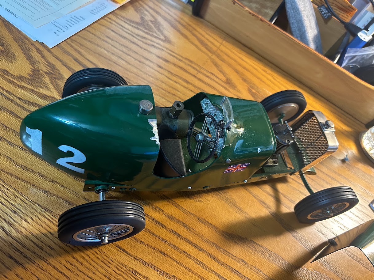

    I started adding some British cars to my collection, starting with the M&E Wasp I showed previously.
    Here's another. A homebuilt MG. It had been previously crunched in shipment, so I was able to pick it up for a good price, and I like fixing things so win-win.
    Damage to body near seat back, as well as the windshield frame was broken.
    Fabricated a windshield frame out of brass sheet.
    After some body work and fresh paint, it's all fixed. It's a cool little car. Wish I knew who built it!

    Sweet car, Rick. Excellent job on the windshield frame and body work!

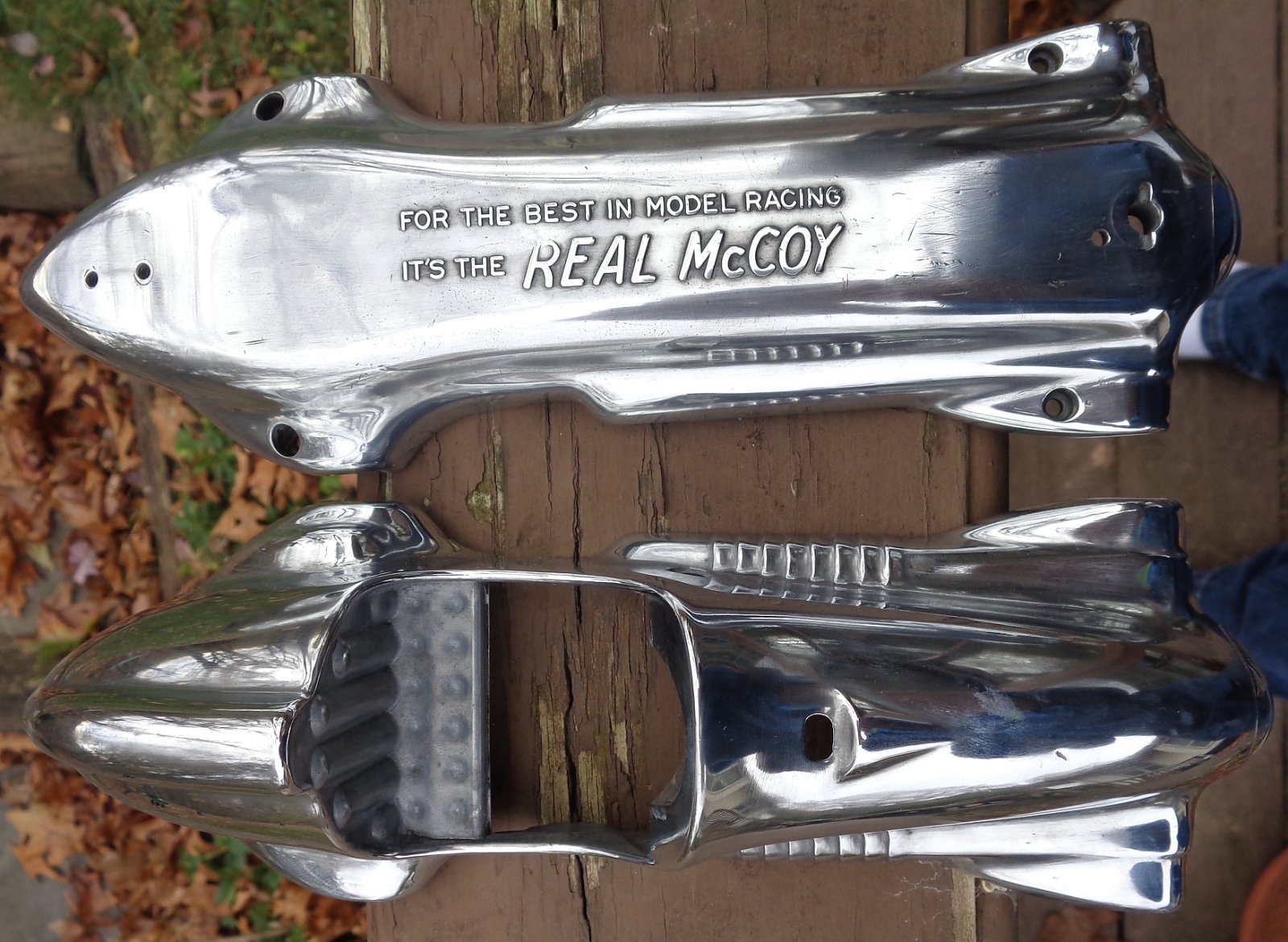

    I have not posted in a while because I retired at the end of August, so I haven't had machines to use in the evening. I just bought a well equipped Craftsman/Atlas lathe, and I just got a bunch of bearings, belts, and gasket material for a Hardinge TM horizontal mill I have, so I should be getting back to work on the Frog soon. I polished up my Real McCoy. It took about 4 hours of filing and sanding with 320 grit paper, then another couple hours of polishing with tripoli on a cloth wheel, then Simichrome on a piece of cloth. real1.JPG real2.JPG

    That is absolutely beautiful!

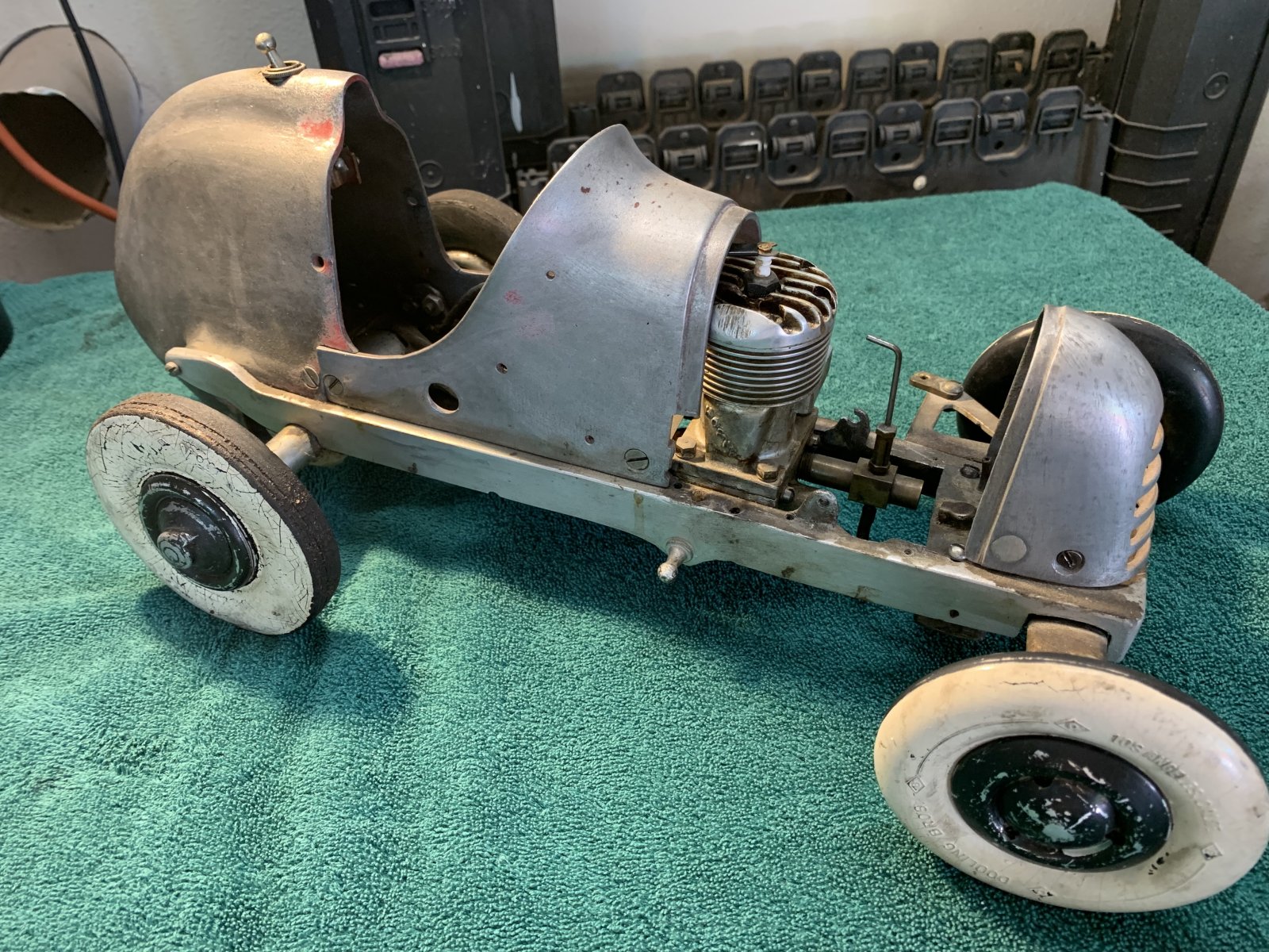

    Dug one of my Bremer’s out…similar, but definitely not as fancy!

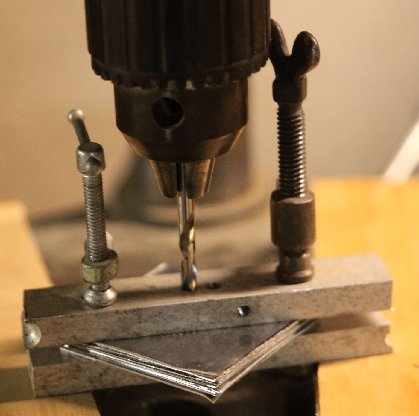

    I finally got my stainless hubs done. I sawed out two and an eighth inch squares of .025 thick 430 stainless, clamped them together so I could drill them all at once. Then I turned them to 2" diameter, clamped between 2 pieces of brass,, pressed them in the dies I made, then polished them with 400 grit then 800, 1000, 1500, 2000, and finally 3000.
    I am very happy with them. hubs1.JPG hubs2.JPG hubs3.JPG hubs4.JPG frog1.JPG frog3.JPG frog4.JPG frog5.JPG

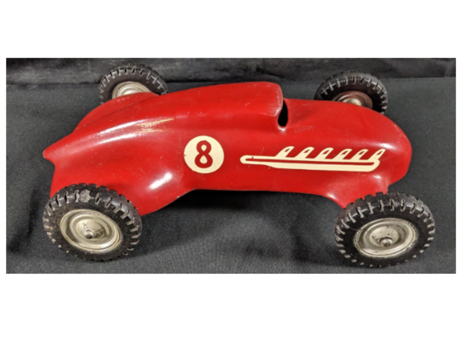

    Hey guys, I found this on line. It looks like an old copy of the top of a Frog used as a pull toy. It has bracing added where the axles go through the body to make up for the axles not going all the way from wheel to wheel, so it's not an original Dooling casting, unless they made a pull toy version. Anybody know anything about it? I can't copy the photos, so here's a link. It's in an auction tomorrow, 1/15/24. I'm not bidding on it, just curious. Lot - CAST ALUMINUM TOY RACE CAR (auctionzip.com)
