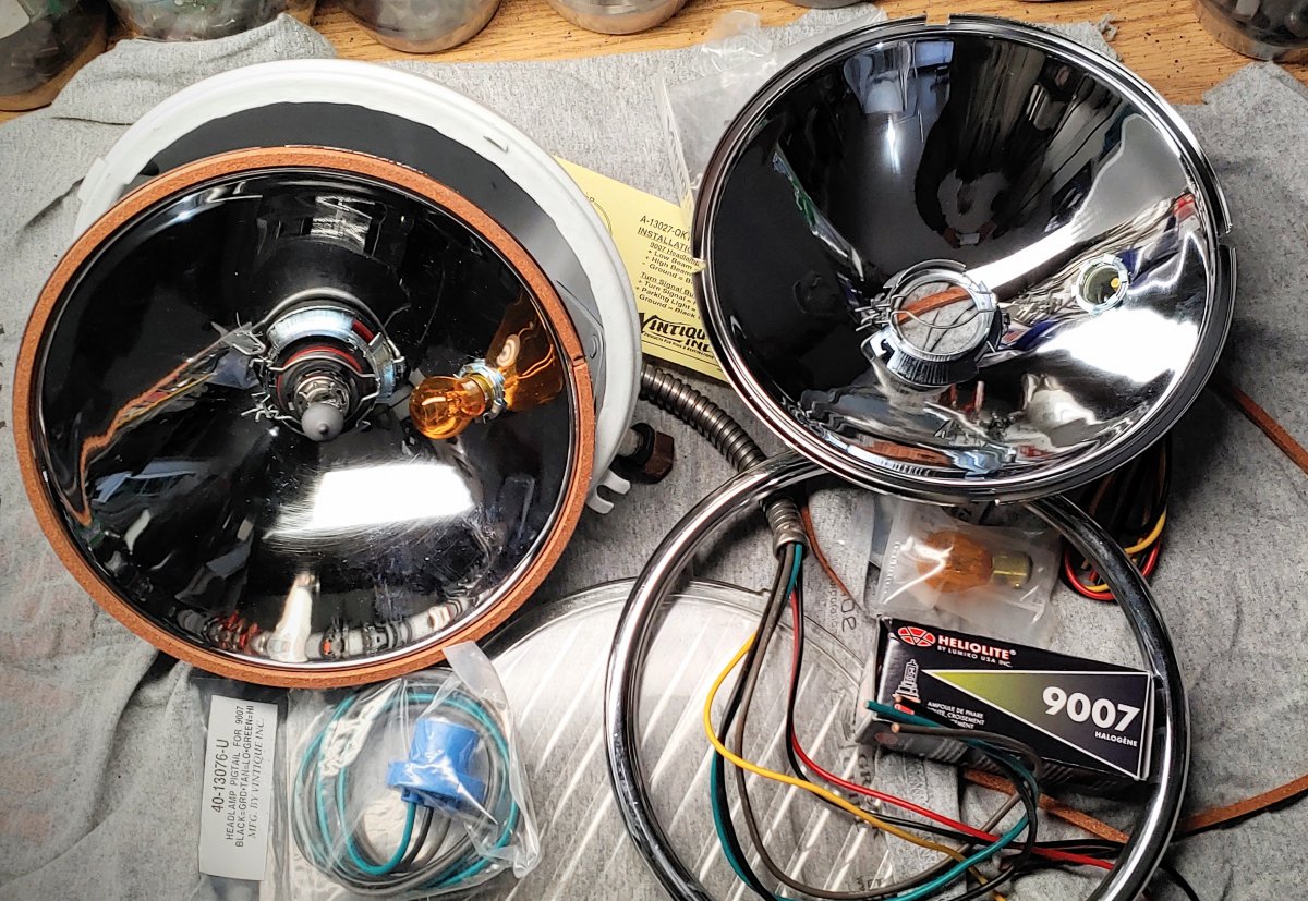

    Here are my '28 A headlights on the workbench:
    05snopro440 likes this.

  19. 19Eddy30
    Joined: Mar 27, 2011
    Posts: 4,504
    19Eddy30
    from VA
    Who's Band ?
    If VINTIQUES
    The first pic Bulb installs from back , tight fit with O ring
    The the U shape spring
    Pushes against plastic of Bulb & hooks on clip ,
    Spring loaded , simple if
    VINTIQUES
    the second pic looks to be another brand bulb installs on front side , Same with spring clip except on the front
