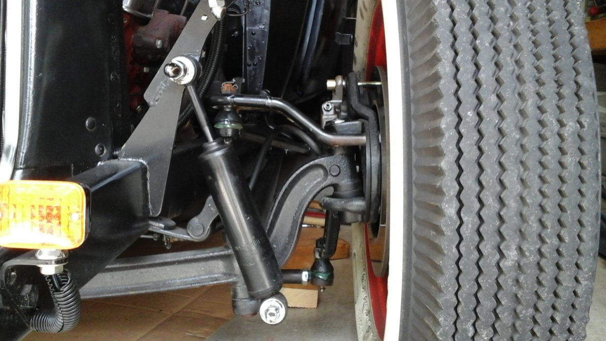

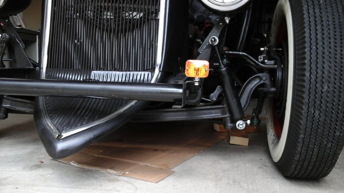

  11. OK here are some new pics. I adjusted the steering as F&J said. It made the steering better but didn't fix the wobble. So I came home and looked at the wheels and the drivers side is angled as the p***enger side appears straight. It's getting dark so the pics might be hard to see.
  12. I just checked the tilt of the wheels and they both appear to be plumb no tilt at all
  13. F&J
    Joined: Apr 5, 2007
    Posts: 13,291
    F&J
    I've been fooled by optics on cameras before, but I see what you are talking about, so it's not all just camera. Driver side sure does look odd
    Something is very wrong, because that is a repro axle from what little I can see. If it is repro, you'd not expect to see that camber problem. (an old home done dropped axle might come out wrong, but not a forged or cast repro IMO)
    Next thing is to see if the king pins went bad? That would let the wheels do that. Jack it up, squat along side of tire, and grab top and bottom of tire and see if it will move like the pin is sloppy.
    You said you are a carpenter...get levels and a square. Check the floor across the front, if level, use the carpenters square along the tire. That will show what it has for tilt. If the floor is wavy, run a long level or straight edge in front of both tires.
    I see other things.... but start with the angles and check the king pins for slop first

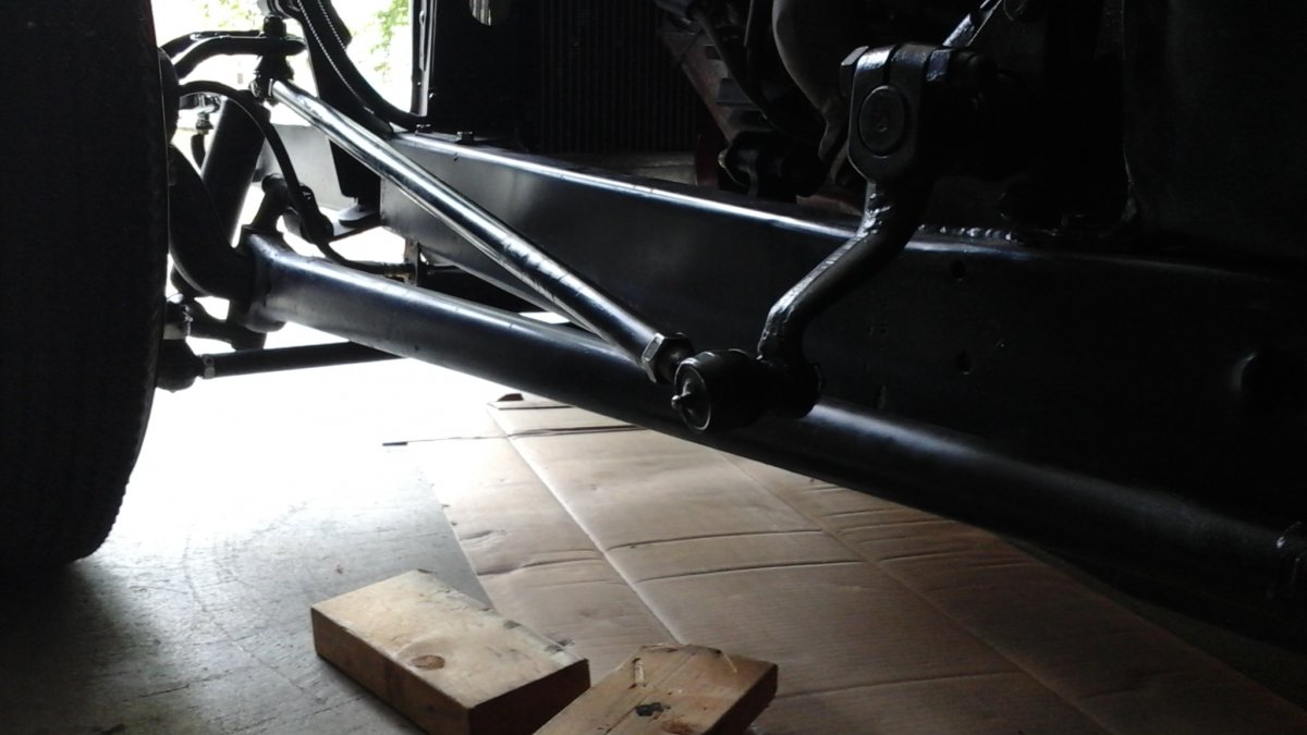

    Ok, I'll chip in here. The geometry is not as Ford intended. The drag link is heading uphill to the steering arm at the spindle. This gives a conflict of arcs between the drag link and the radius rods. You need to modify that steering arm to lower the front of the drag link as much as possible.
    I think that you have a severe bump steer issue which triggers the death wobble.
    I had the same bump steer issue on my 33 coupe and modified the steering arm to lower it. I also made an adjustable length drag link so I could get the steering box in it's sweet spot when the wheels are straight. These mods made a real perceptible improvement over bumps.
    You say going over the railway tracks sets it off. It's bump steer initialising the problem.
    Here's a before pic:
    And an after pic:
    Mart.

  29. How would I modify the drag link to make it more level? This is much to take in that is why I started another post,
    I squares both wheels and they both tilt in a few degrees
  30. milwscruffy
    Joined: Aug 29, 2006
    Posts: 4,209
    milwscruffy
    If you have the room flip your upper steering arm 180 degree's to where it's a dropped arm. You would also have to spin the tie rod end 180 degree's as it would now be on top of the arm rather than underneath it. Looks like this would get the drag link much more level, again only if you have the room/ clearances to do this.
