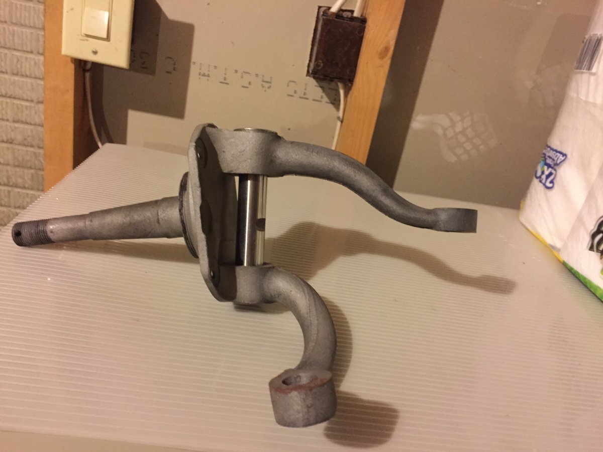

  19. Get the car to a shop that can checkout everything and knows early Ford hotrod geometry and front-ends. In looking at the axle from the front - really don't "see" a camber issue - but that is just my old eyeballs trying to determine what is "normal" via just a picture.
    I do not like where the upper steering arm is located (height above the king pin top ) and the resulting steep upward angle of the drag link. To me, it appears to be installed "upside down" so as to miss the shock. The drag link should be as close to parallel with the ground as possible (and close to the angle of your bones). Outside of potential wear issues (which I can't guess about), I can see where your setup can contribute to bump steer, which then might be initiating the DW situation. (May be other issues as well - like a worn steering box???)
    See my attached picture of a 32 spindle that has been setup for a dropped heavy axle and stock 32 bones - notice the upper drag link arm location in reference to the top of the king pin - see how much lower it is than your setup. My guess is that you may have some conflicts with your shock setup - so a few changes might "spill over" as a result of changing the top drag link arm.
    As noted by others, don't get too frustrated with this stuff and give up. These are the things we all go through and we are all continuously learning along the way! :)
