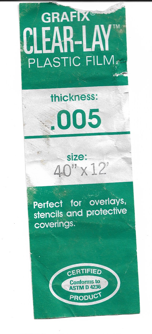

    I bought a roll of Mylar film from McMaster Carr 30 years ago and still have some of it left. It cost $36. When I use the blaster the Mylar lasts about 8 to 10 hours. When my son-in-law uses it, its opaque in about an hour, so the blast angle does make a difference. I use Aluminum Oxide blast grit. I have a 2" tube through the wall for the exhaust with a screen clamped over the end to keep out bugs..
    I had the **** Blast vacuum system on it but the vacuum motors would fail in about a years and were over $100 to replace. Now I use Craigslist shop vacs with the bottom cut out of the bucket on the **** Blast filter drum to replace the vacuum motor and they last several years before failing. $25 gets a replacement.

    I get a roll of cover sheet from the art store, saw it into sections the height of my window and secure it with cheap masking tape. Hard to judge how long it lasts; but I get much better life than the OP is reporting.
    I also added a dust deputy cyclone between the cabinet and vacuum; makes a world of difference on the time before the filter needs cleaning.
    A good gun makes a difference on blasting; I have found that TIP guns work the best for me and don't neglect to replace the wear parts as needed; always work quicker with nozzles that are not worn excessively.
