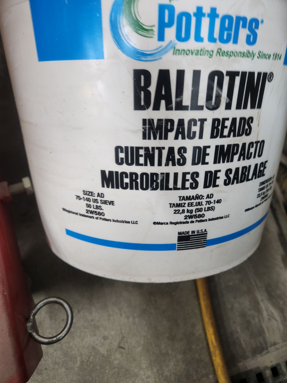

    image000000.jpg I have had good luck with Ballotini "impact (gl***) beads, 70-140 sieve size. They clean well, keep metal erosion low, and last quite a while before they pulverize down to pumis. It all depends on how dirty the parts are that you are cleaning. I try to degrease & wire wheel as much heavy rust & dirt as I possibly can off the parts. I get mine from Grainger part # 2W580. Up here the 50# pail I bought today was $69.10. They have other grits available also.
