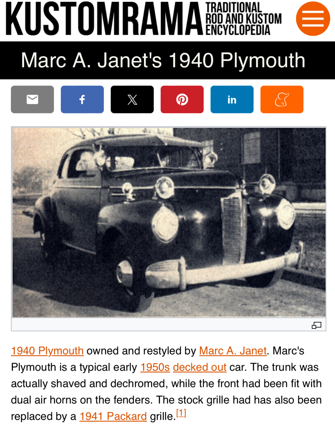

    Listed as featured in this publication from 1951
    Along with this beauty
    and this stunner
    These customs shared book space with cars built by Barris. Westergard and Lopez to mention a few. According to the website.
    I haven’t purchased the book ….yet

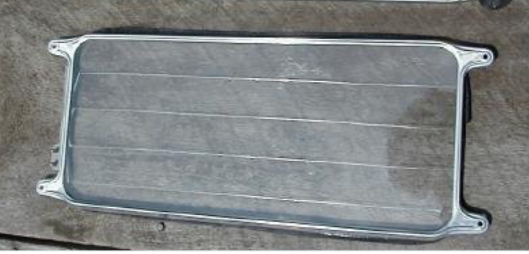

  8. Had to do a search on the Fulton I bought to figure out the mounting.
    I had bought a generic reproduction visor with a bunch of parts I picked up. Had aerocoupe wrote on it. I’ve got a gm truck. So the aftermarket car one didn’t fit the truck roof. The angle was off.
    So while looking up info you stumble across interesting things. Like this ad

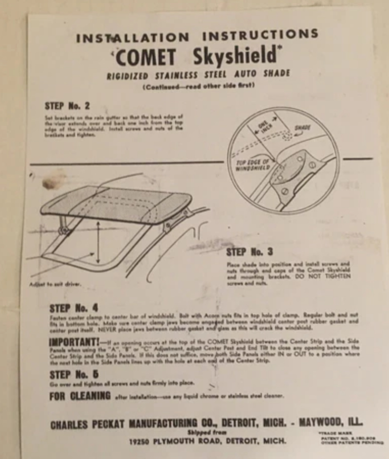

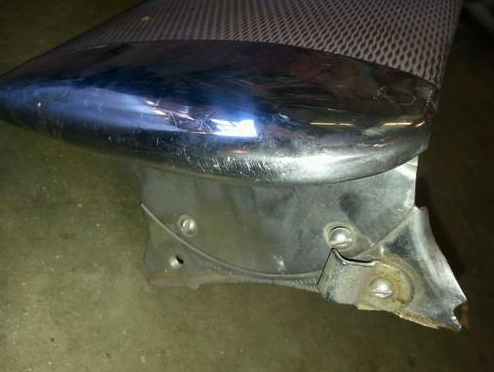

    looked up mounting for a peckat and found this
    Shows a center mount as does this hamb pic for one
    a stainless visor. There’s a few different styles.

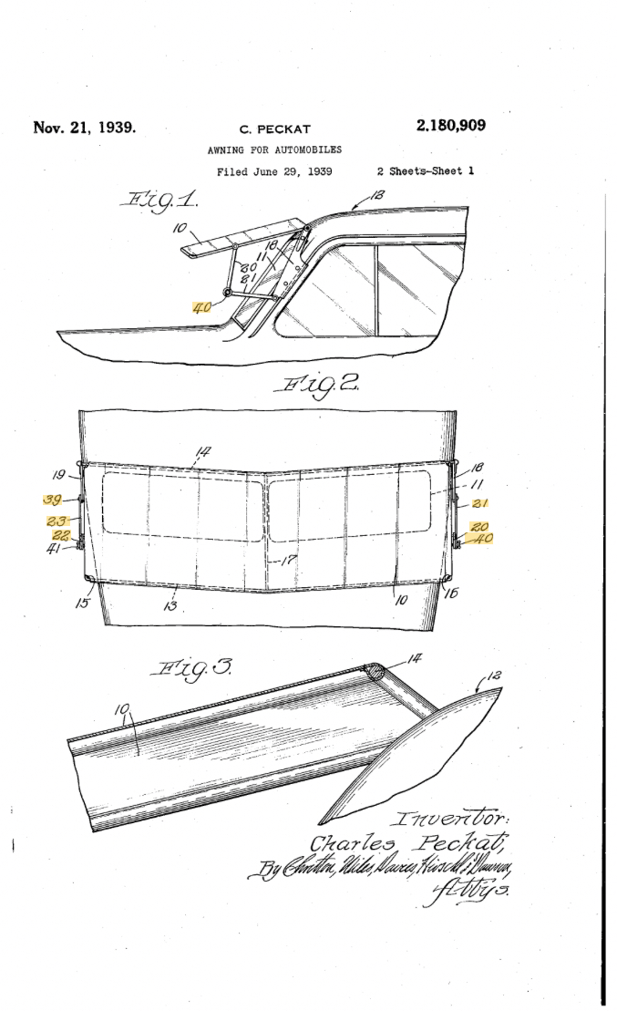

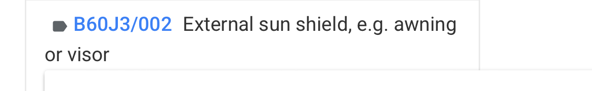

    A Pecker patent popped up
    patent list it as this
    Interesting.
    Appears to be patented as a sun shield
    well I be

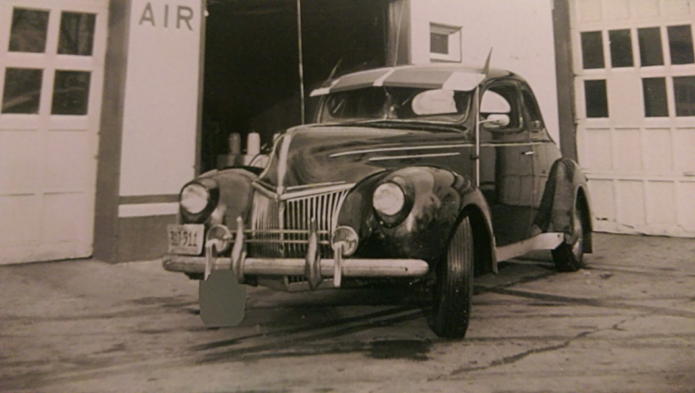

    A '39 my father-in-law took in trade back in the early '50s, illustrates just how well a visor improves the appearance of an otherwise unattractive old Ford coupe.

    ^^^ Oh yeah, that is one sweet custom!

  19. Id drive the wheels off that.
    add some skirts
  20. chicks dig em
    Those side visors, mmmmmmmmm.
    spots and looks like full skirts. Clean custom
    Dude is living the dream. Before the magazines told us what to like.
    just drop the rear
    Has to be the widest visor I ever seen.
    Looks like the side ones as well. Got spots and skirts. The early customs are the best.:)

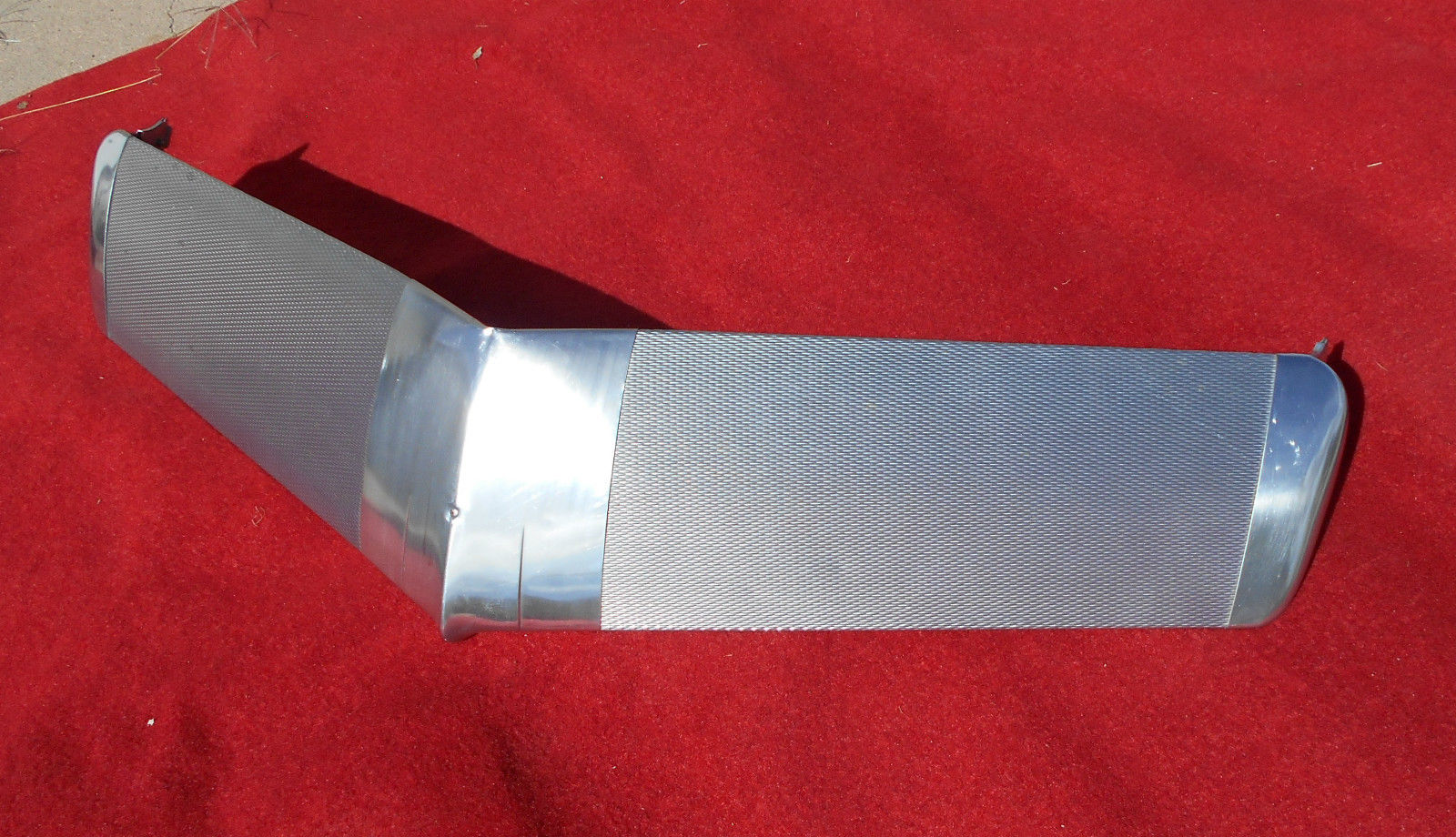

    I contemplated using a SS Peckat Skyshield but opted out. It has the centre support that clamps to windshield divider strip. Polished end and centre with waffle finish halves.

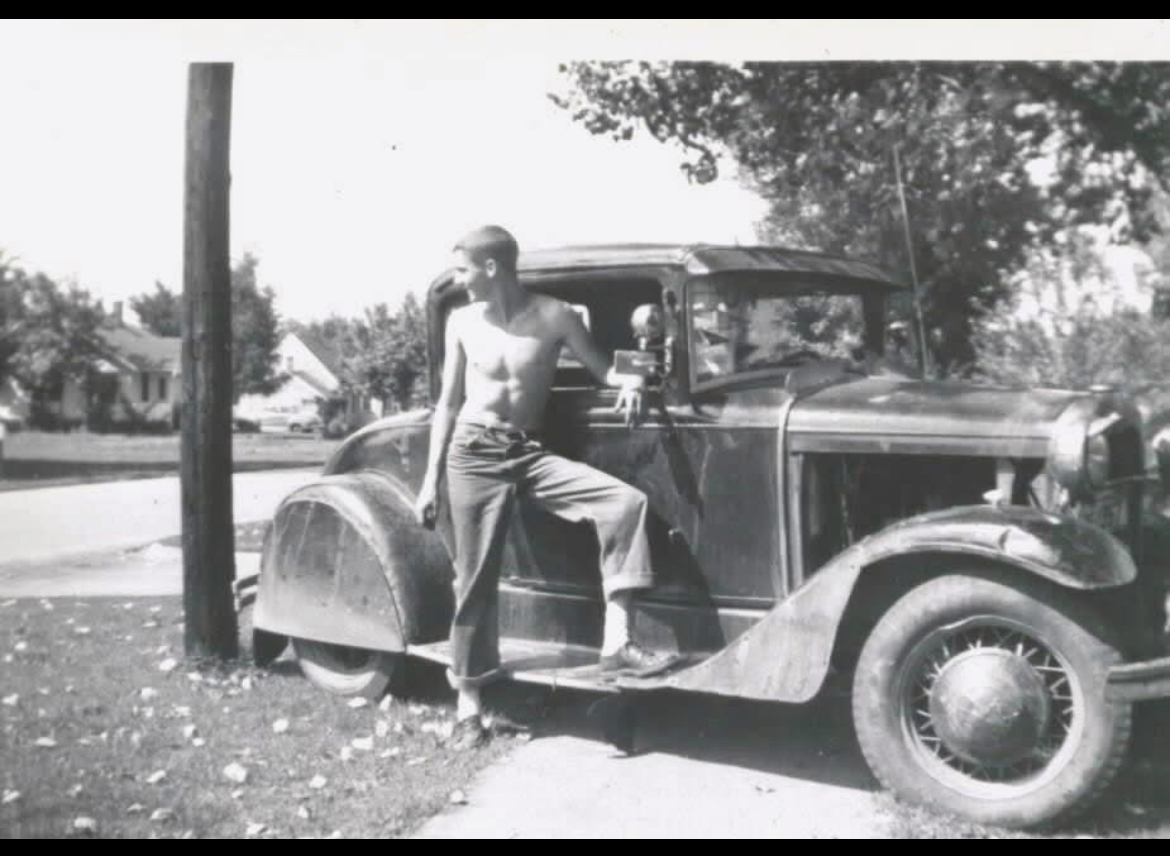

  24. Another custom
    yea it’s sporting its factory visor but I dig it anyway.
