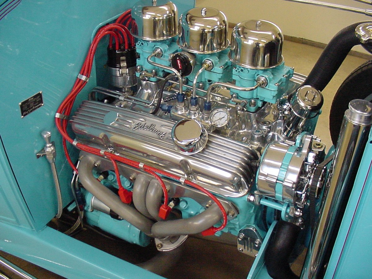

    DSC00646.JPG I just started using one a few months ago. It is a Chrysler style solid state replacement of the point style. I use it on a Honda civic alternator of the late 70's. Way less bounce than the point style. The cut in and out is also way better. It looks identical to the point style it replaces. Time will tell how it holds up but right now it is way superior.
