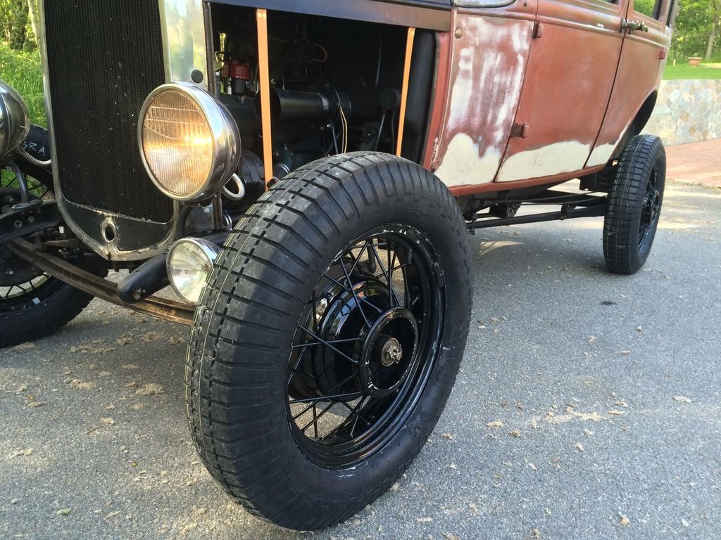

    In Swedish forums they say that an M40 can stand up to 170 HPs. Yes the gears are very nicely spaced, with the third nicely in between the original tranny's 2nd and 3rd - nice for cruising in town, rather than the original 3rd that was a bit too high around corners and 2nd that was a bit to slow on streets. I guess you could say that is better adapted now to modern traffic. On the highway I can cruise around 50, and even a bit faster. There is the M41 with overdrive of course, but I kind off like it simple. Yes, hmm, selling a kit would be something, or a least put up some better plans/drawings on here for free. I will see what I can do...
    Here are two phots with the new Blockley tyres from the UK that I fitted yesterday (5.50X18) - I am very happy with them. The are certified for 130mph... Made for 30's Bugattis and Maseratis, but make for a nice dirt track look I think.

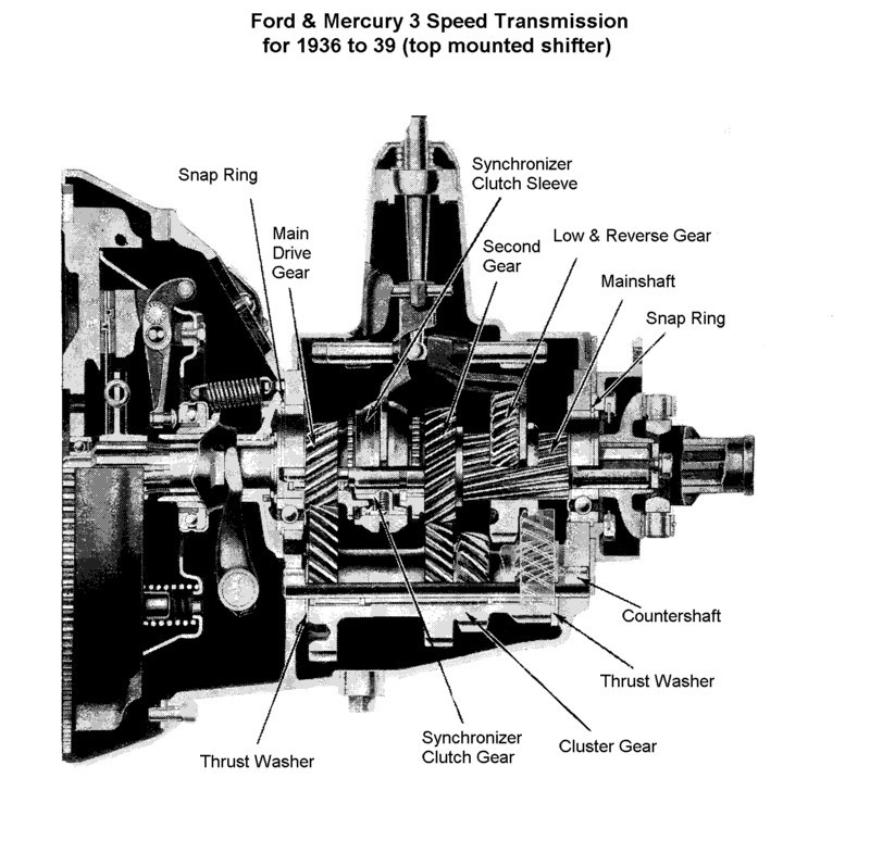

  22. I'm pretty sure, that it does not contain a seal, besides the aftmost roller bearing, Volvobrynk.
    From http://www.vanpeltsales.com/FH_web/flathead_drawings_trans.htm, see for instance the '35 to '39 cut away:
    Therefore I see no gain in using the rear housing mentioned - especially when another housing to go from the end of the M40 to the housing needs to be fabricated.
