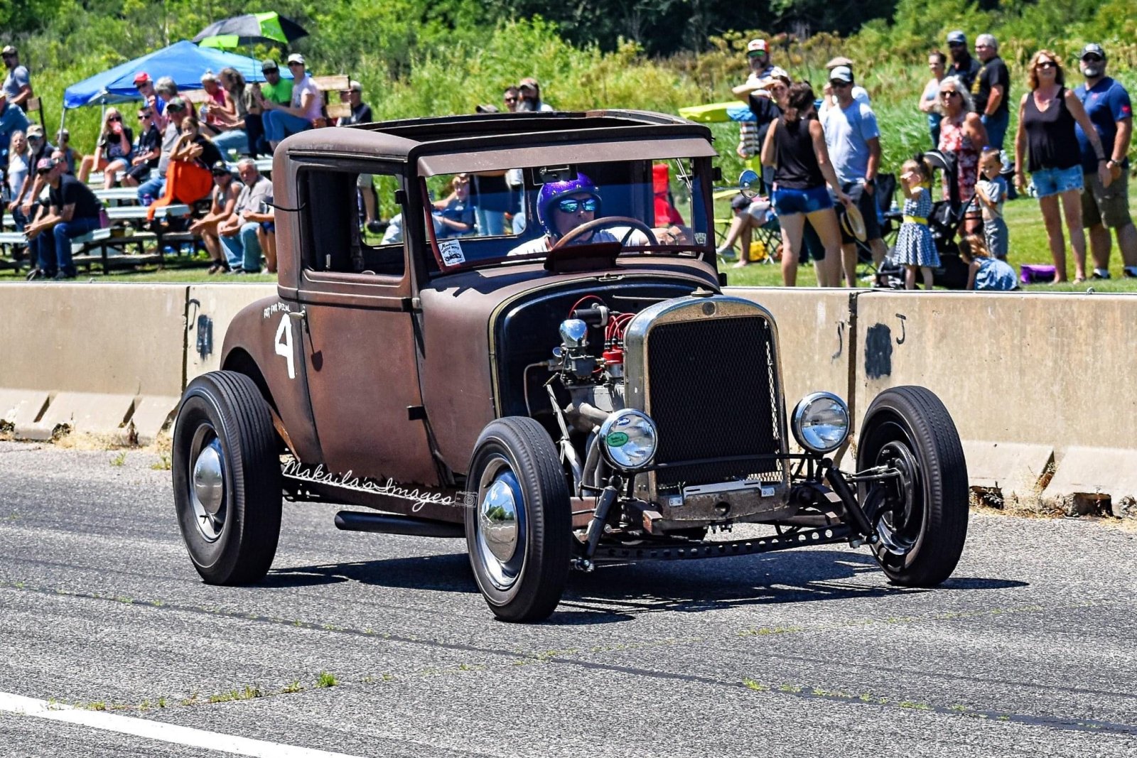

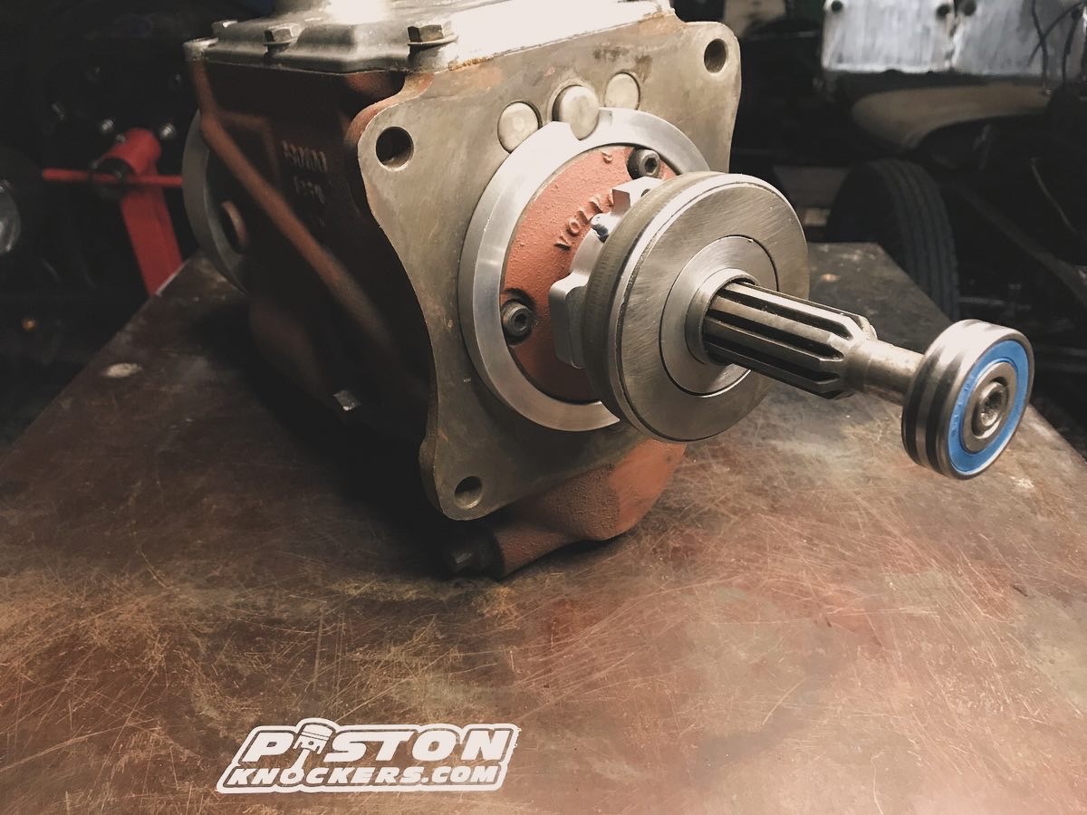

    Yup, that`s pretty much the only direction to take to keep the torque tube.

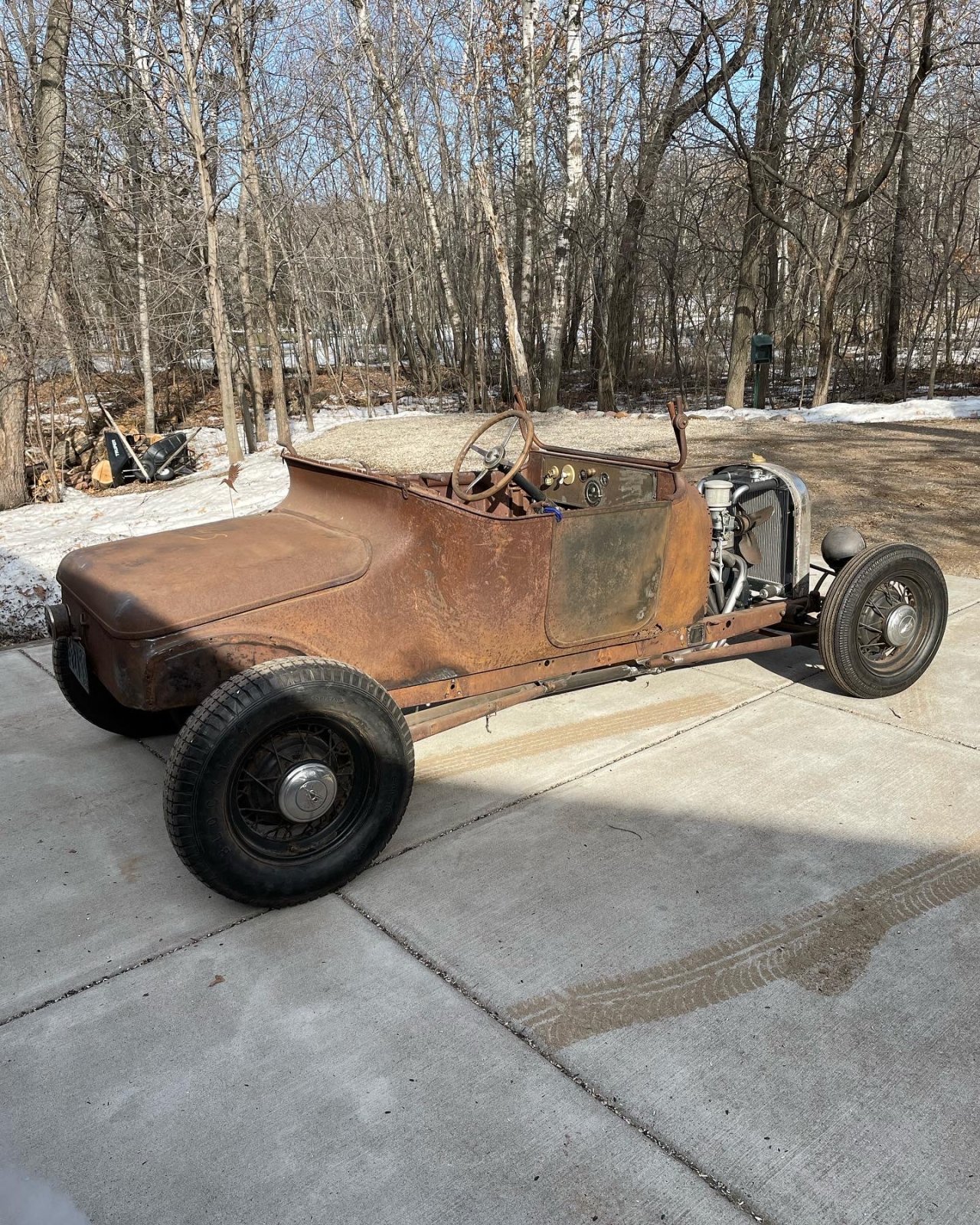

    I ditched the tt and use a gps speado app for speed. The roadster has open drive banjo, and the coupe has open drive ford 9 inch. Everything has been strengthened to run the open drive. The Volvo trans has worked real well for me. E3F02D4E-CB7A-4340-9A38-57E594E3E92F.JPG IMG_6129.JPG

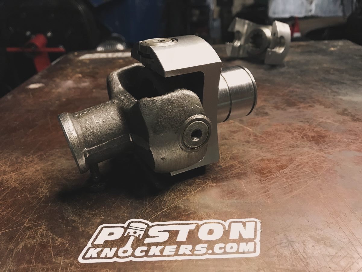

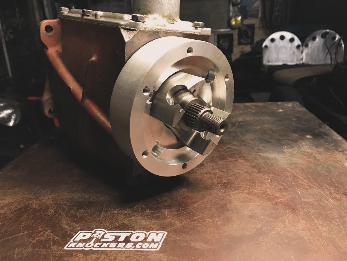

    But ofcourse I forgot it was in the TT. Anyway If I don't mind shortening the TT what would be the bast transition to go from Volvo box to Ford TT?

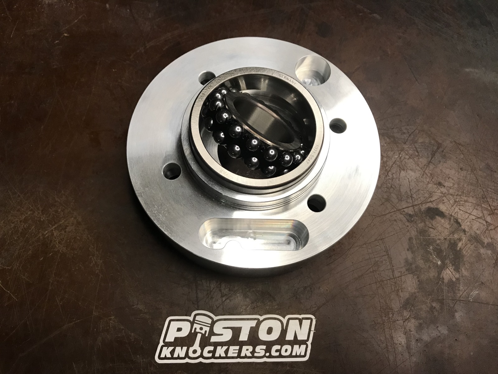

    Hello we have Build This Adapter in complete new
    and Sets
    Outback, SS327 and burl like this.
