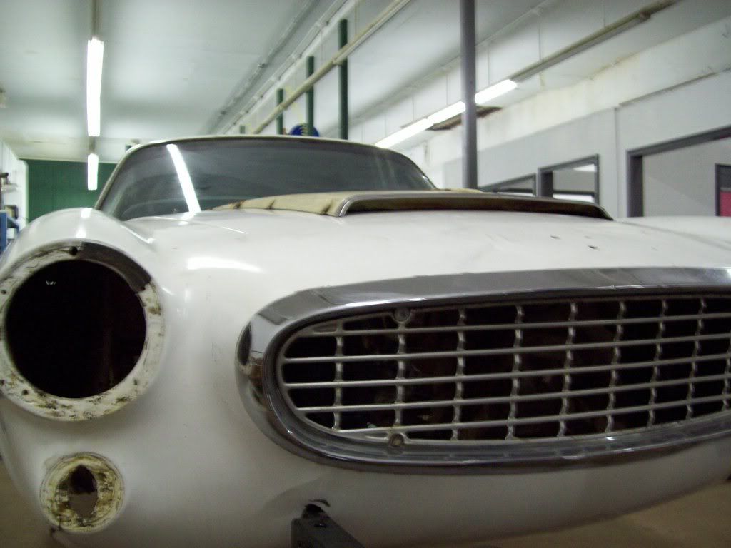

    I am currently in the process of build a Pro-Touring style P1800 based off the Renditions of the Vox Volvo. I will be performing body mods and developing Newly Designed glass kits to update the car. I will be moulding the grill shell into the body and extending it a bit forward at the top, installing layed back headlamps with the outer glass lenses, recessing the tail lamps and license plate mount, installing a hood scoop, shaving drip rails, flaring out the quarters and fenders a bit, moulding in the front marker lights, removing the side trim, modifying 63 Corvette rear bumpers.
    I am working with a suspension company to see if we can develope a bolt in updated crossmember.. The options will be rack and pinions steering, tubular control arms, adjustable Coil over (height and dampning), up to 13 inch drilled slotted rotors with 6 piston calipers, and the crossmember will accept several motor configerations.. I am also having some nice 4-link adjustable arms made for the existing rear end with coil over shock replacment for the factory Coil spring.
    My company designs Flush Mount Glass Kits for the classic cars and they require no body mods. I will be making the flush mount windshield and rear glass, along with the one piece Green House glass roof and rear glass. I am not sure if they will be offered for sale, because I am not sure the demand would be there.. I have always loved these cars, and fell in love with the updated version.
    This is what I started with.. I paid 1000 U.S dollars for this car, and it ran just fine. I had installed the wheels and lowered a bit to see what size wheels the body would accept without evasive mods.

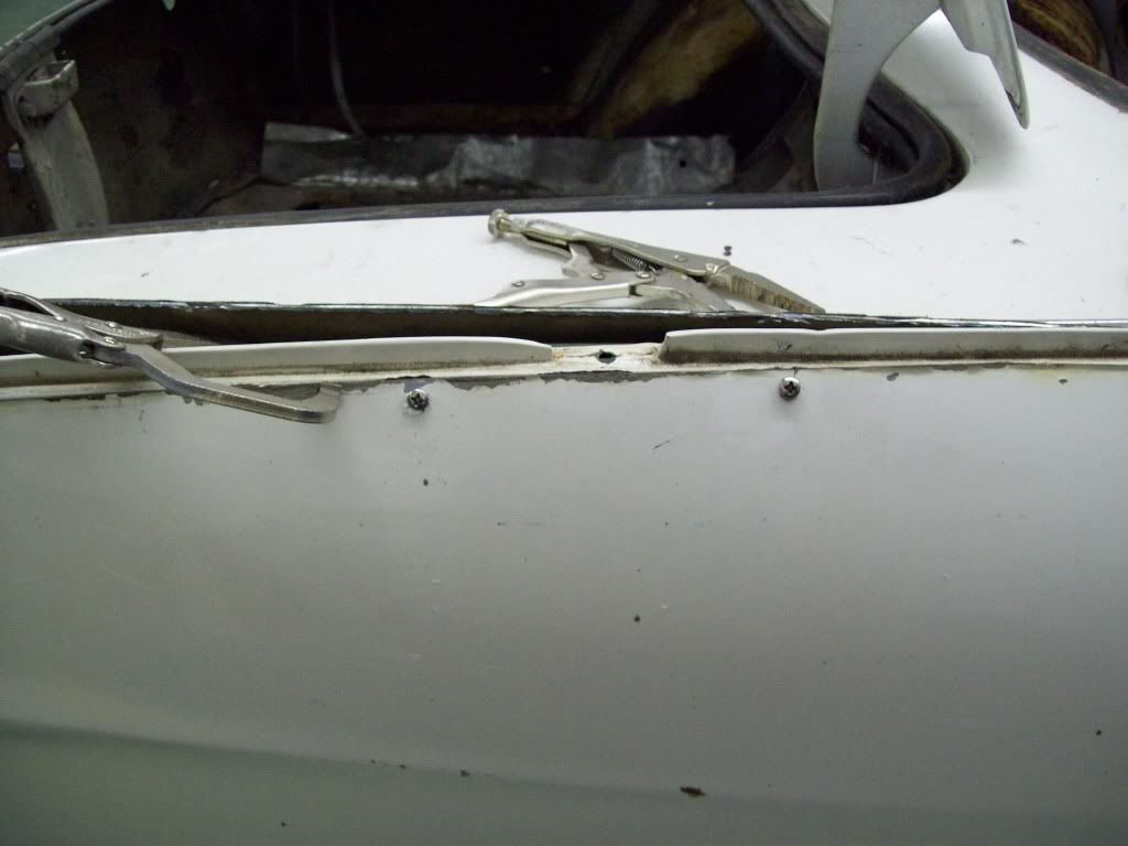

    I removed the drip rails, and will be making larger quarter glass openings with the correct shaped glass to fill in the holes.. There is a curve to the body there, so it wouldnt look right to just install flat glass.

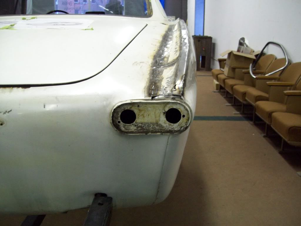

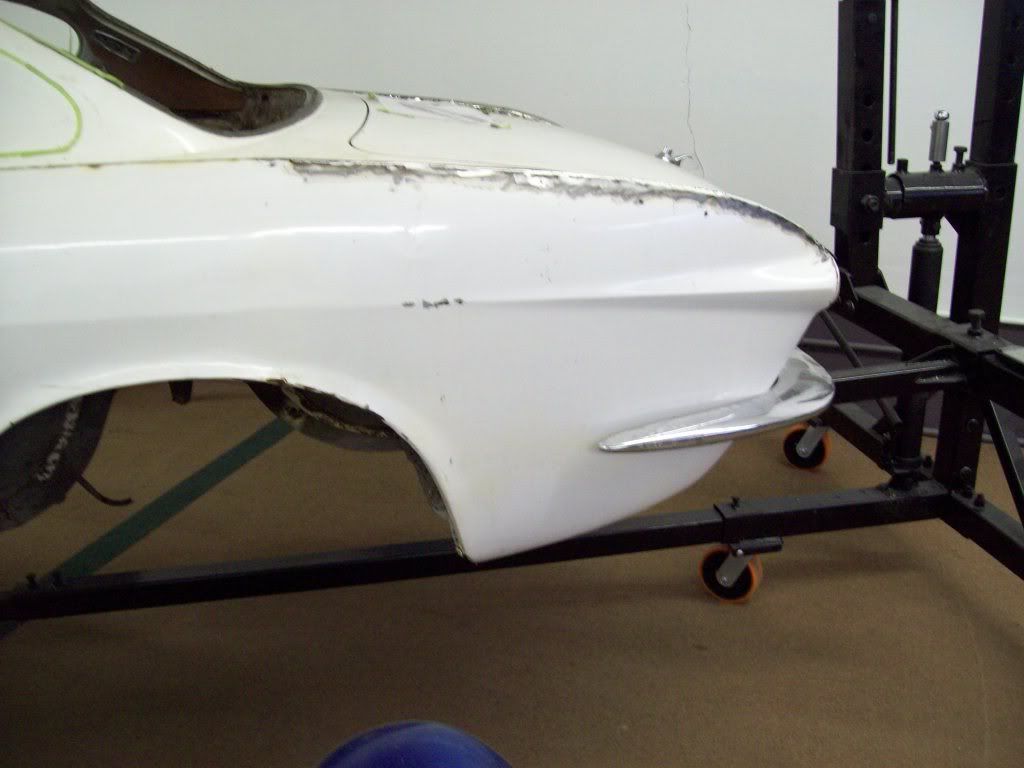

    I have shortened the Rear Fins by several inches, and I think it actually looks alot cleaner and sophisticated. They are just roughed in at this point, and will need some hammering and dollying, and finish welding to look better..
    This next week, I will be working on the Flush Mount Windshield and Rear Glass.. After I get the samples made, I will then start on the Green House Roof pattern, and working on the install channel for the roof.
    The Green Tape outlines the Quarter Window and Green House Roof... I think they look fairly proportional.

    Here are the Drip Rails and the Hood Scoop Install pics..

    One of my next issues is the Tail lamps.. I cant seem to find a recessed light style that ressembles the P1800 or the Vox rendition, so I am considering other options.. It appears that I may be able to make the bulb sockets snap into the body to get rid of the tail light housing. The lense fits in body where the housing would normally mount, so I am considering a few options to stream line them if I dont actually recess them.

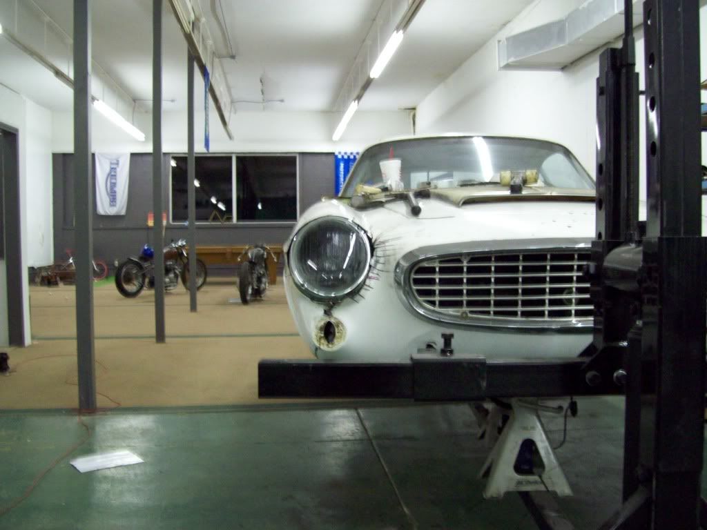

    Well I am working on the slanted headlamps, and to have a conventional sized headlamp with a sloped lense, there is alot of added surface area. I have trie to find later model composite headlamps that will work, but they are all mis-shapen to the fenders they are made to fit.
    So here is where I am at... I am worried the light is way over-sized for the car right now, but it does appear that way in the rendition.. I am thinking that once I get the metal work completed where the only thing showing is the actual lense, it will dramatically shrink up the oversized appearance. Atleast that is what I am hoping.. ha ha Right now, turning back isnt really an option. It really does give the car that over-sized European Headlamp look from the 60's-70'.
    The way this headlamp system works, I can actually finish weld the ring to complete the fender, then blend it all in. The ring is the main part of the bucket system, so the mechanics of the light will attach to the back side of the headlamp ring. I believe I will only have to add a couple of support braces to the rear of the bucket for extras support.. Here are some updated pictures.. I will say that the light appears to be much bigger in the pictures for some reason, I guess it is the chrome ring blending into the lense.

    I am feeling kind of unsure about what I think of the parts for this mod, so I am going to assume the critisisms will start flying... ha ha... I really think (Really Hope) the ring being made part of the fender to finish it out, and the lens being the only stand alone part, will shrink the overwhelming appearance...
    The new headlight ring is actually only a 1/4 inch wider, and 3/4 inch taller that the factory bezel and headlamp assembly. Once the ring becomes part of the fender work and is painted, the width of the light is actually a 1/2 narrower and a 1/4 inch shorter.... So by the measurement, I am actually installing a smaller assembly, but it sure doesnt look like it...
    Here are a few comparisons of Factory and Modded...
