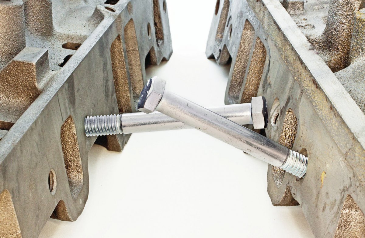

  21. Here’s a “vortec” head (96-2000)
    There are Only two casting numbers 062 and 906. Any other casting numbers are not a “vortec” head.
    This head has been redrilled for earlier intake manifold to bolt up. You can see it doesn’t fit the intake port. The raised intake ports of the vortec heads is one of the things that makes them better. Welding up the manifold is useless, it makes a seal but castrated the port . Cutting back the intake and reconfigured reshaped re fabricated intake runner is what’s needed. It can be done but it’s stupid when aftermarket intakes that fit are available.
    87-95 heads do not have the raised ports. 86 and earlier intake manifolds fit on 87-95 heads with some very easy modifications and wedge washers.
