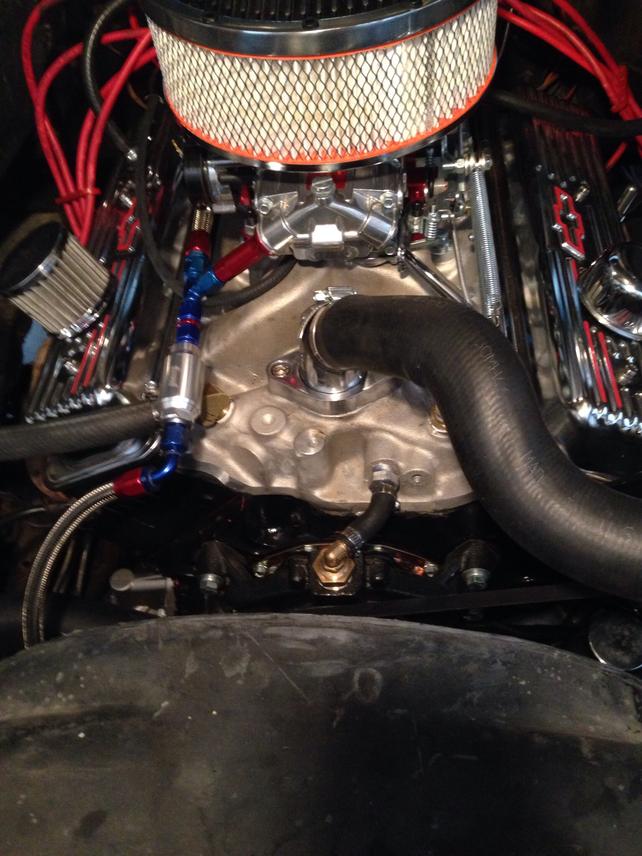

    And make dang sure you pick up the outlet on the water pump for your byp***. I spent months troubleshooting erratic overheating issues because of this. There is a small tech notice in the bottom of the installation instructions that mention this.

    Chevy did away with second coolant hole in the right side of the block where the water pump bolts on and a p***age in the head so coolant only circulates in the engine when the thermostat is open if the byp*** hose is missing on a Vortec.

    Can I get some info on the coolant byp*** hose I will need with Vortec heads on a Gen 1 small block?

    Did you have to do anything to the heads or intake for cooling? I've read about coolant crossover lines? Putting a set on my engine but trying to avoid cooling problems.
