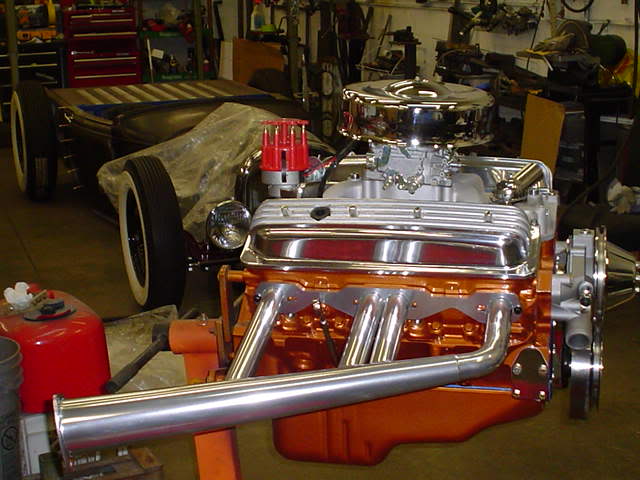

  6. Humm? This is a lot of things and ugly isn't one of them.
    This belongs to don's hot rods.

    That is an attractive engine, but IMHO I still don't like it because it's immediately identifiable as a newer-style head. It's obviously a SBC, but then you see the inline bolt patten... it's just not the same. I know, I know, people use newer stuff all time. Just lie to me, make your new crate engine look like an older block haha

    That's a pretty picture of an engine 31 Vick but I don't see anything about it that says traditional. nada.
    It will however fit very nicely between the rails of a fibergl*** body 32 or a 69 Camaro and I expect it will work very well. With or without aluminum heads.

    I would change the dist cap and run that baby proud with or without a hood.
